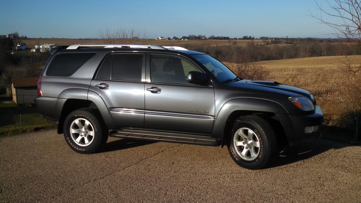

Before pic with stock XREAS and running boards.

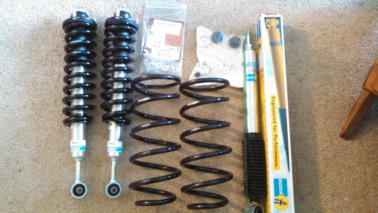

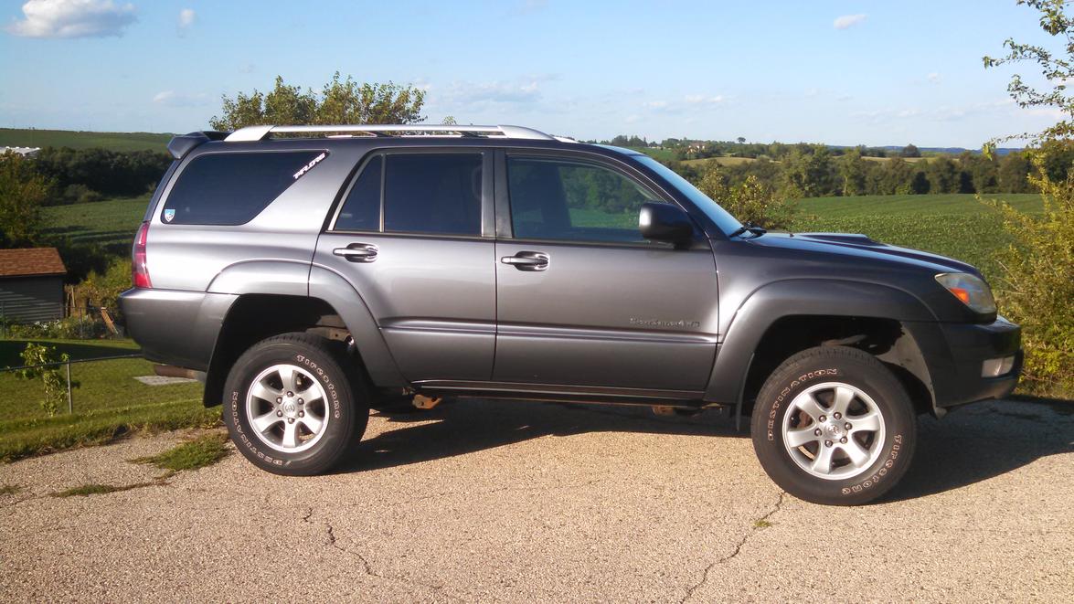

After pic with 5100's set at lowest setting and Wheeler's/Eibach T1 coils in the front and 5100's and Wheeler's/Eibach T12 Springs in back. Gained 3.5" of lift up front and 2.5" in the rear. Did not use a spacer to compensate for the slight 1/4-1/2" lean from the added gas tank and driver weight. Really happy with the ride and not bothered by the small rake. Tires and Wheels are next on the list.

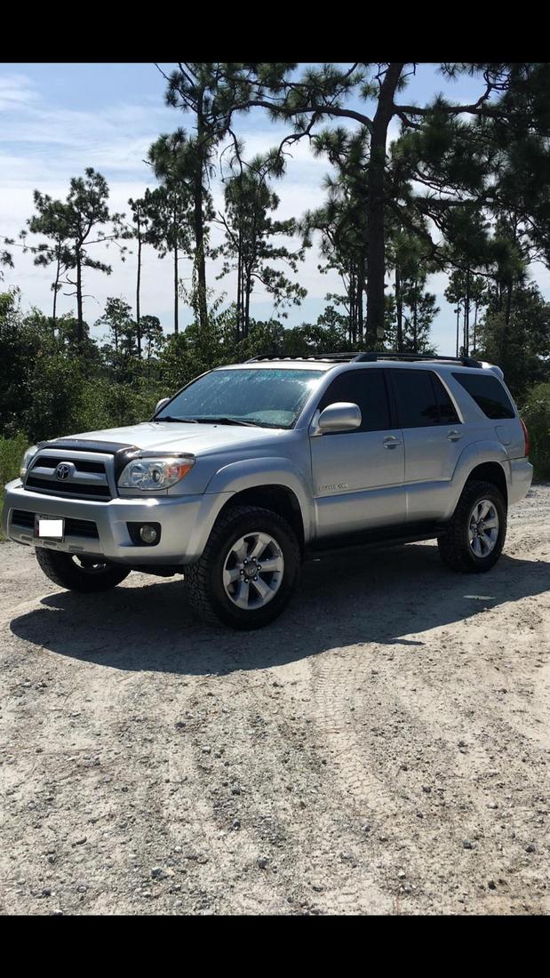

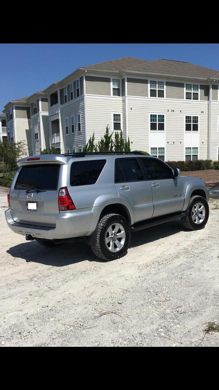

Added 1.5" Supreme Suspension Wheel Spacers and refinished the limited wheels.

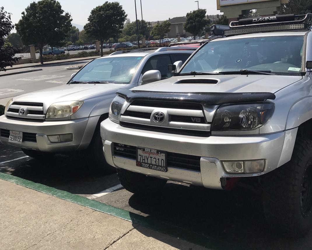

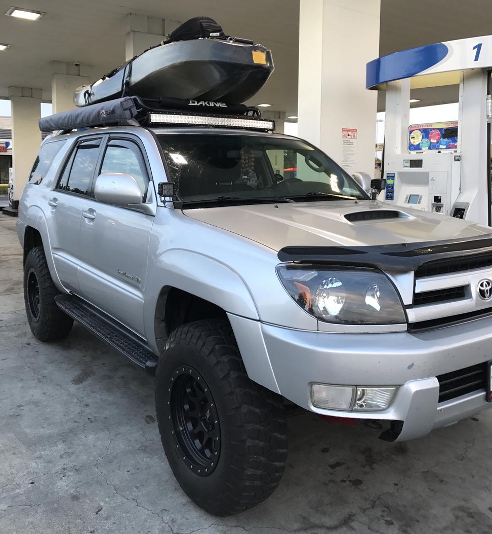

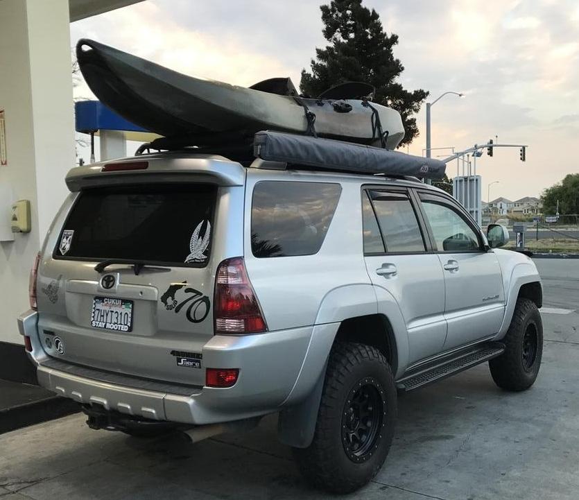

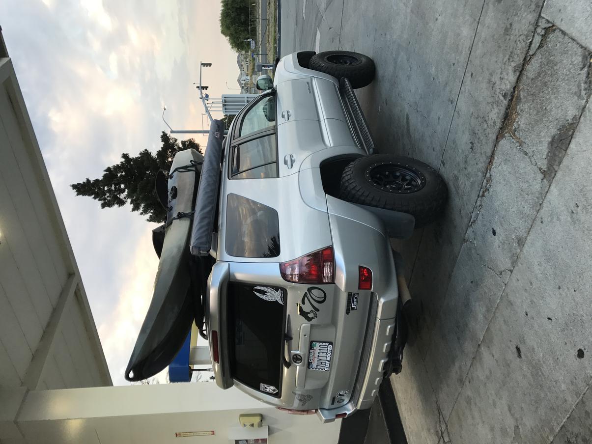

2005 V8 Sport XREAS removed running Bilstein 6112/5160 and Toytec 2" rear coils. JBA UCAs and 1" diff drop. Running 255/80/17 bfg km2s on SCS ray 10 wheels. Looking to get some A/Ts instead but torn between 275/70/17s or 285/70/17. HELP!

That looks great. Same color as mine, also on the limited wheels. Can I ask if you have any rubbing with those tires/spacers?
Thanks - I sanded down the wheels and repainted with a lighter silver to match the body and clear coat vs the factory limited finish which is a little darker tone.
I did have to trim quite a bit of fender liner (about 5", no fender itself) and the inside of the front mud flaps. With the tires sticking out from the body I didn't want to completely remove the front mud flaps and have debris flying onto the body.
I'd do 285's if you have at least 3" up front should work.
Also, I can get you some cool black tails to match those headlights :)

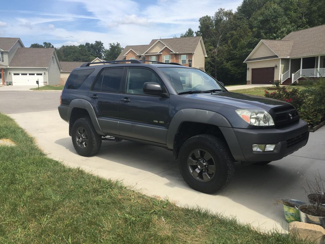

I'm sure there are a ton of pictures of this simple setup but it's 2" rough country lift with 1.25" spacers on stock sized 265/70/16 tires.

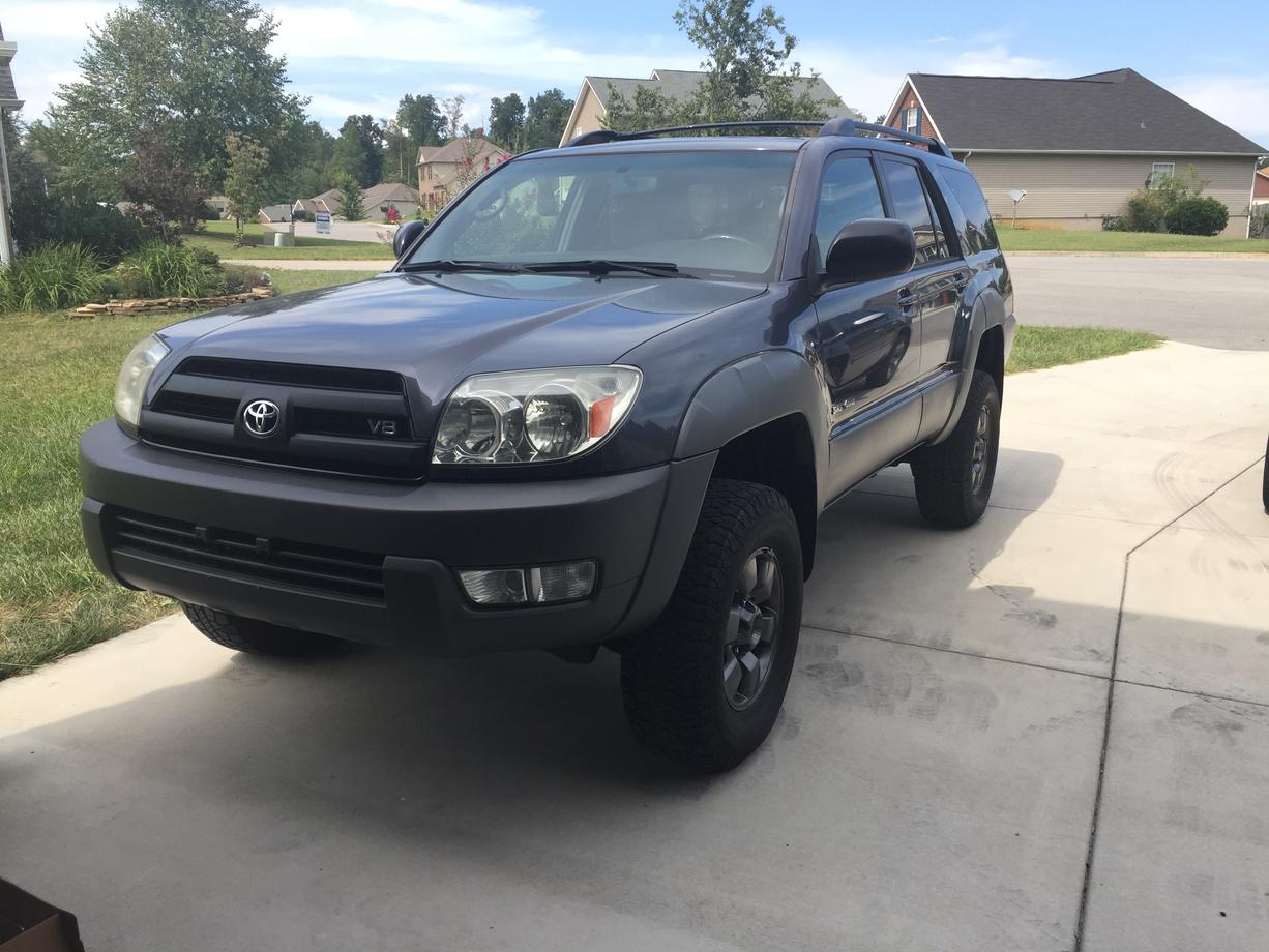

2015 FJ coils 5100's,front set to 1.75 and a 1" rear spacer. New shoes also 2015 Toyota FJ TRD Trail Edition Wheels 17x7.5et15mm with 255 75 17 Duratracs. Next is a roof rack.
