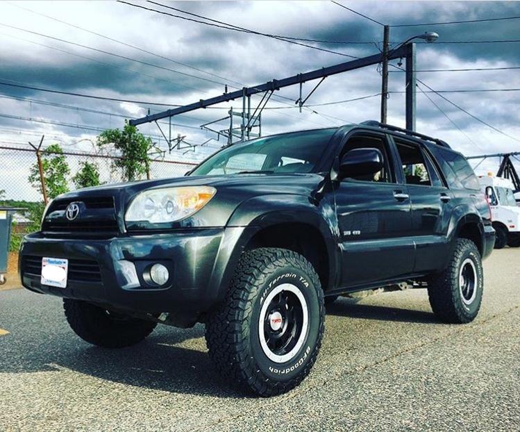

I did the Bilstein/FJ Moog lift a couple months ago, only getting around to posting the pictures now. 5100's both front and back, with the fronts set at the full 2.5"
Very minor issue with the install, my mechanic was not able to reuse the old bushings and I needed to buy new ones, which I found on Toyotec and had overnighted. I don't know why new shocks wouldn't come with new bushings, but no matter. If you're buying Bilstein, you should be aware of this.
Also my mechanic made mention that the rear springs seat on axles were a very tight fit. I don't exactly know what that means, but I suppose it's something for me to monitor.

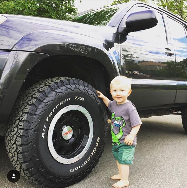

Anyway I love how it came out, especially with adding the black TRD Baja wheels and 285 BFG KO2s. Drives better than it did stock, noticeably increased seating position, and it just looks pretty sick. Former grocery-getter and now a truck I'm really proud of (..and will still get groceries). If you're on the fence about doing your own, just do it.

VZNE2N
(before)
VZPiwN
(after)

(watch out for adorable small children)

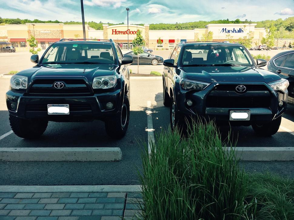

VZPj9E
(puny stock 5th gen )

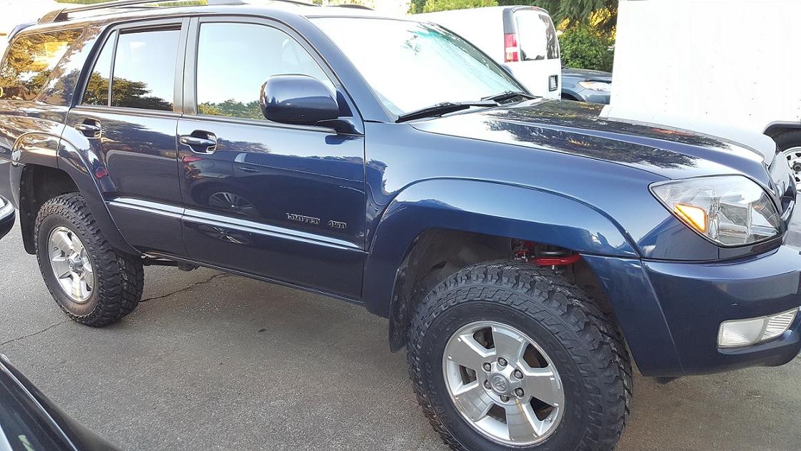

Lift installed.
5100 Bilsteins with Toytec Tacoma springs and OME 2895 with JBA Upper control arms.
New Cooper Discoverer ST MAXX 255/80 17

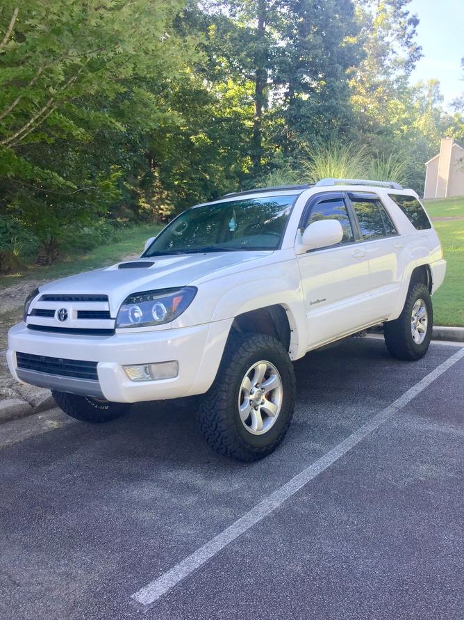

Installed my new Dobinsons springs. 300's in the front and 599's in the rear. Bilstein 5100 shocks all around with the front set to the lowest clip. Tires are 265/75-16 Cooper AT3's.
Fender to ground is 37" on both fronts, 38" on the left rear, 38.5" on the right rear

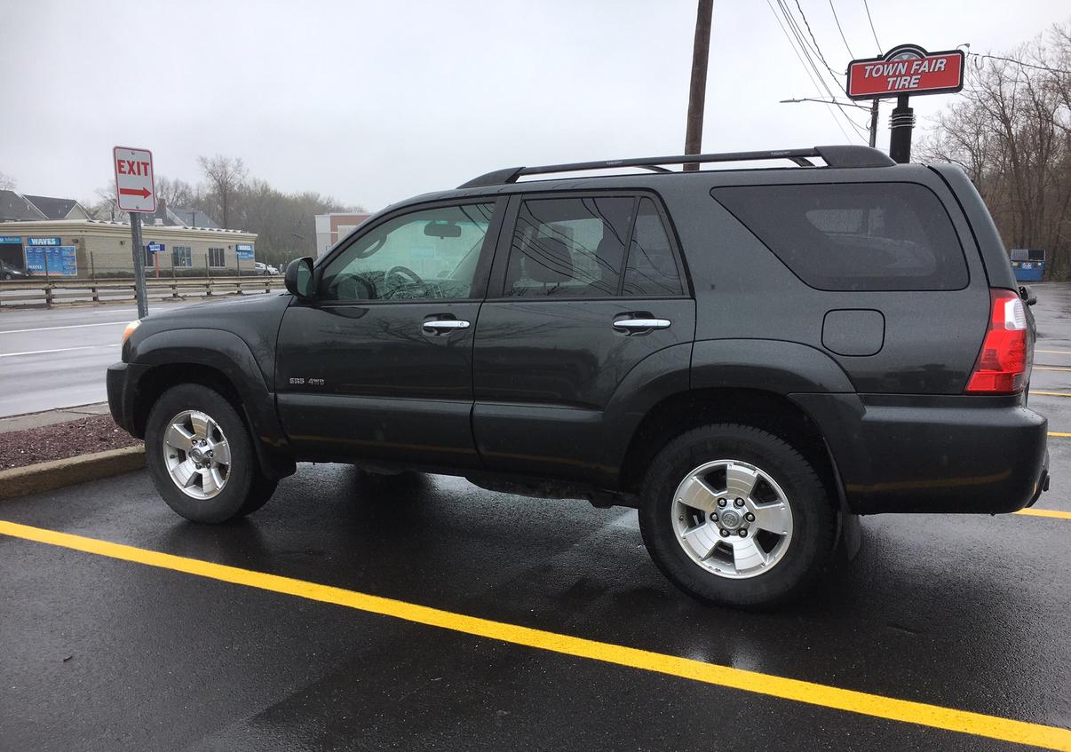

5100s all the way around with front @ 2.5, also have fj springs all the way around. 275/70/17 ko2s. Looks good but still got some more mods coming.
