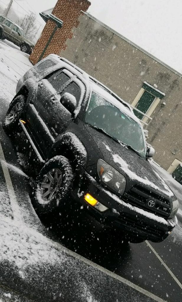

. Just got my toytec boss full kit installed. Edit. Just saw this was in the 4gen section. My bad! I dont know how to delete this post.

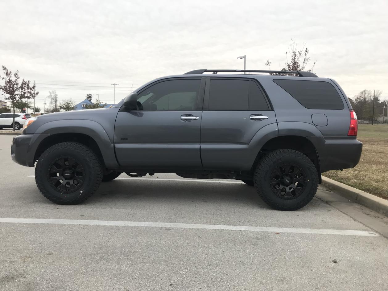

265 70 17 Wildpeaks mounted on 17x8.5 Method Mesh 0 offset
Got new wheels and tires mounted up today. No lift yet so I do have a fair amount of rubbing even going forward. Already have FJ springs and Shocks ready to be installed but just need to pick up a mild addition lift for the front. Thinking going with DS 1".

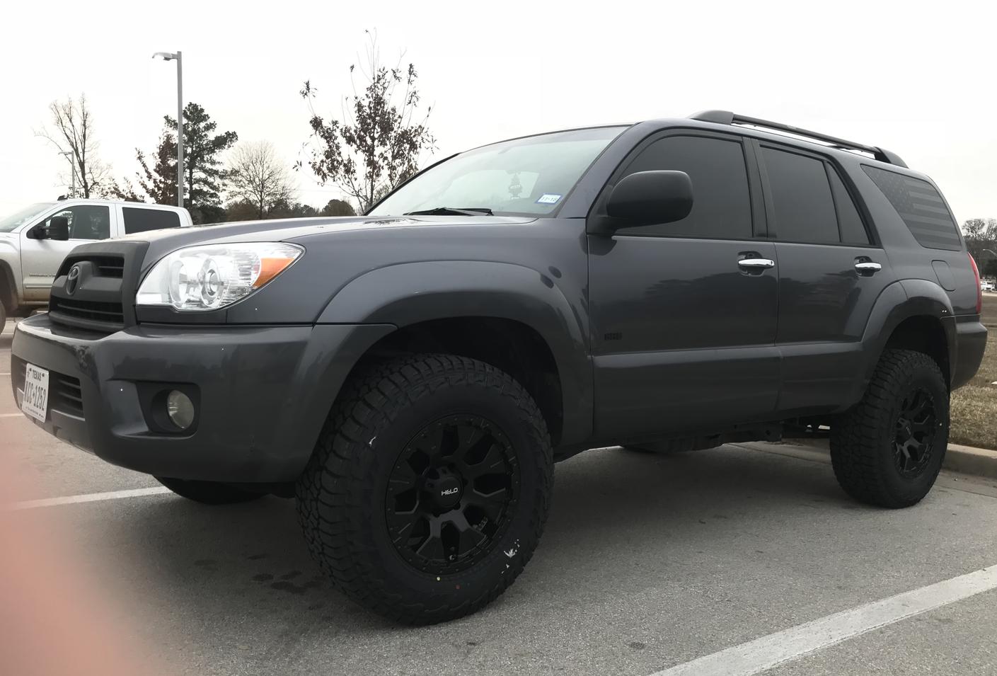

Daystar 2.5/1.5
HELO HE878 17x9 (-12 offset) ��
265/70/17 Falken Wildpeak
Had to remove front mud flaps plastic piece of front bumper due to the offset
Anyone have suggestions to eliminate road walking? Is it standard to replace UCAs to accommodate for this?

Quick answer: yes, aftermarket UCA’s will help. It’s your caster that’s probably out of whack after the lift. Aftermarket UCA’s will allow you to get a better positive caster which will improve driving stability. It’s the angle pivot of the steering axis. You want to get as close to 4 as you can.
Thanks! Kinda mind blowing that a $120 lift kit turns into a $1,000.00 lift kit since it requires an additional $800 purchase of UCA's to function properly... :redbrick:
$800? You can get good UCA's from the group buy section for $400 shipped.

Wow, i bought the same rims and tires (tires are 285 though). Havent put them on yet. Waiting for my lugnuts to come in. I'll post a pic up next week. Probably going to be some rubbing in the wheel well. Got the same lift as you.
I started out having the shop install the 285's thinking I could clear them since I was already clearing 265's with no lift..... BIG HUGE NO..... When they backed out of the bay I thought the 285's were going to rip my front bumper off lol. They looked awesome but with the 2.5" lift/HeloHE878/285s your only option would be driving straight haha. I was bummed that I had to pull them off and go with 265s but there was no way. It was rubbing in about 87 different places.
Even the 265's were rubbing pretty significantly and had to remove a few trim pieces just to clear them... It's all due to the -12mm offset that the HE878's have. Hope this helps out!
