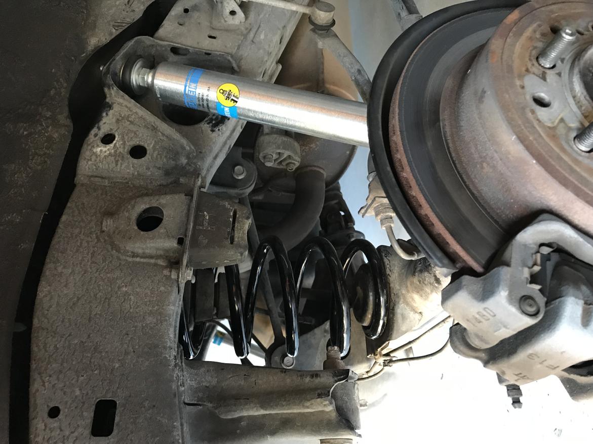

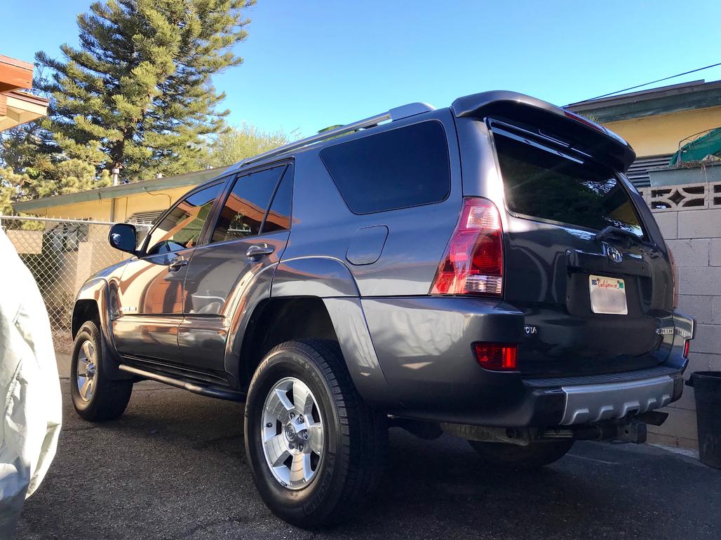

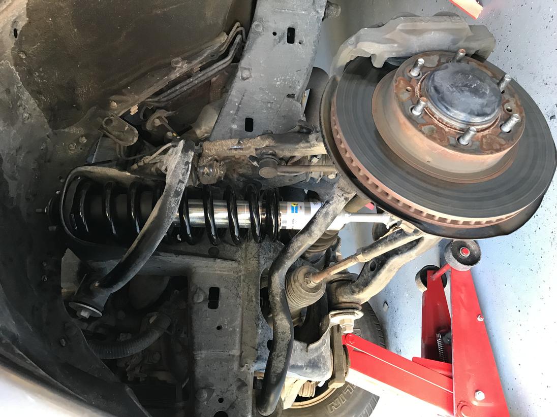

Got my wife a 1.25” bilstein lift. She has the stock 265/70/17. Idk if i should keep the same or go 285/70/17.
I’m sure if i go bigger i might need to trim some and maybe do can mount chop.
Anyone have the same lift and have pics?

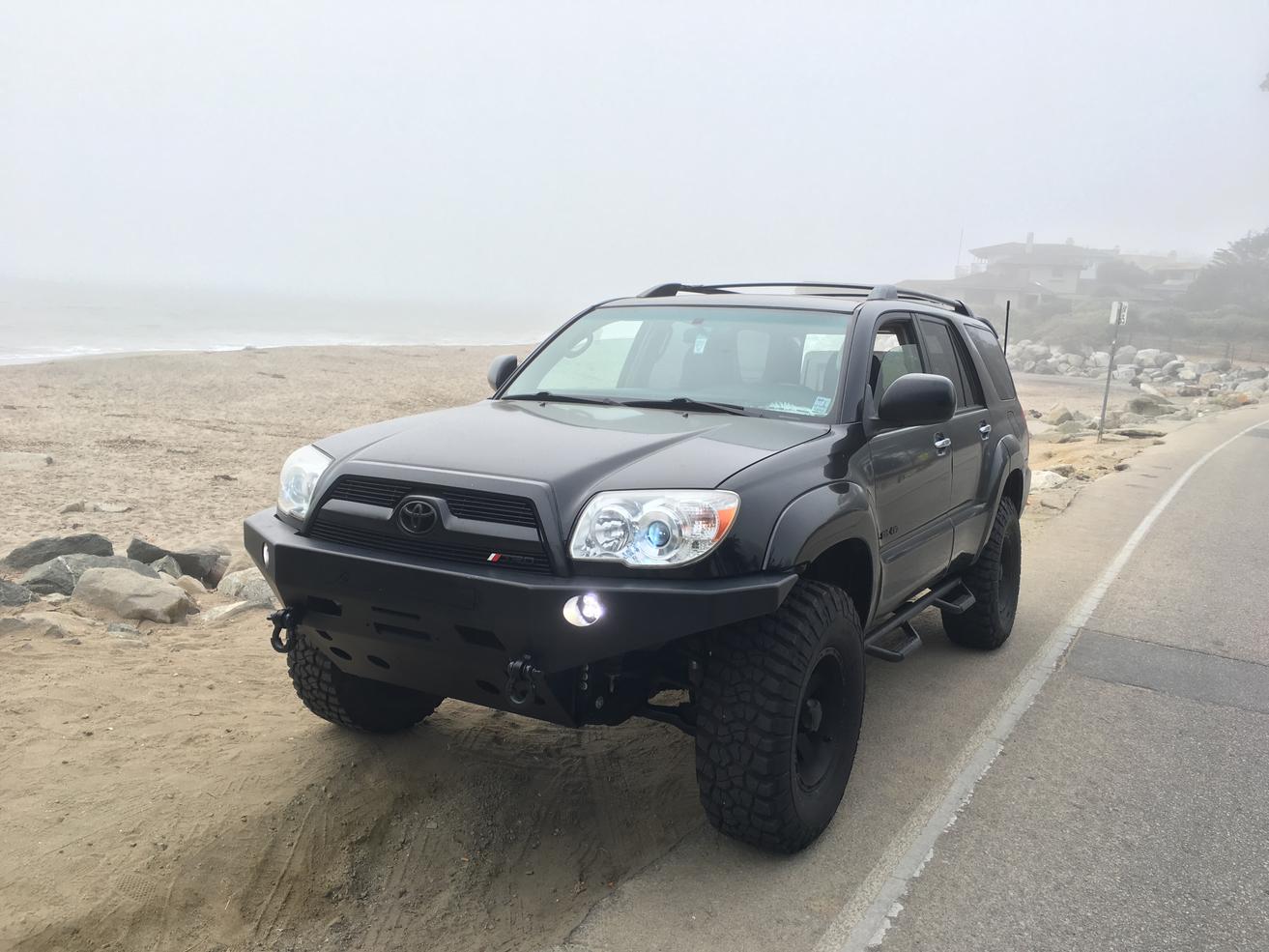

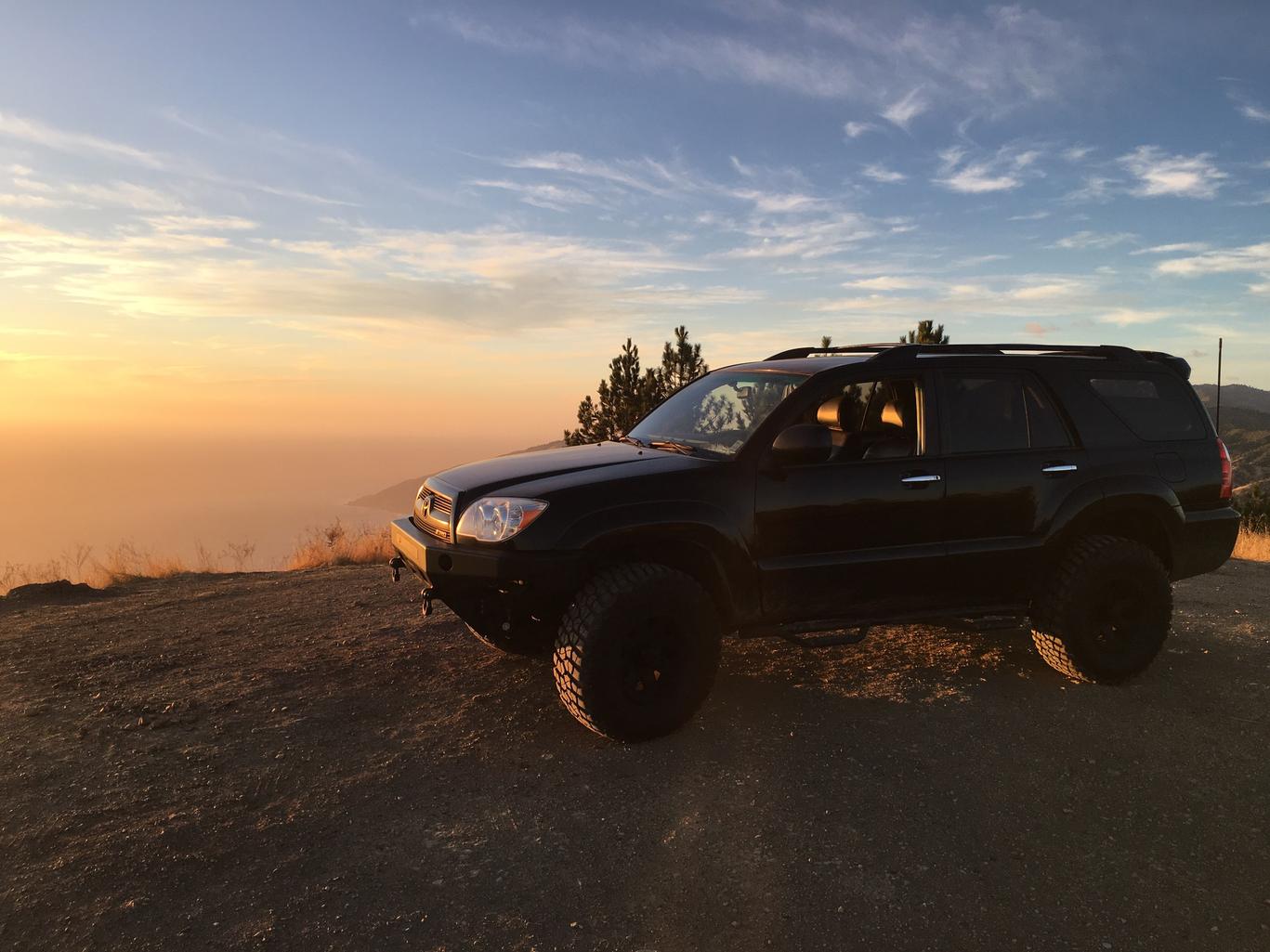

My 2007 SR5 Lift and Tires
Bilstein 5100 Series w/ 285/75r16 BFG M/T
Drives great . Maybe in the future I would get some nice UCA's
