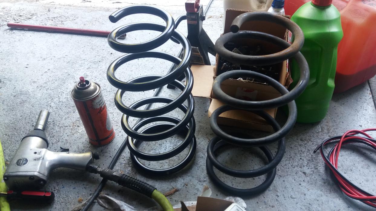

Current setup is 5100’s all around. Stock setting on them. OME 885’s up front, superflex rears, 1” BL.
Numbers are, from ground -
Front driver - 39 1/2
Front pass - 39 5/8
Rear driver - 41
Rear pass - 41
I don’t really “visibly” notice that rake but I guess I have it... my question is this -
If I set the billies up to their first notch (not EXACTLY recommended with My springs but I’m not too worried about that). Do y’all think I’ll be sitting level or be dealing with reverse rake without a 1” rear spacer?
Thanks in advance!

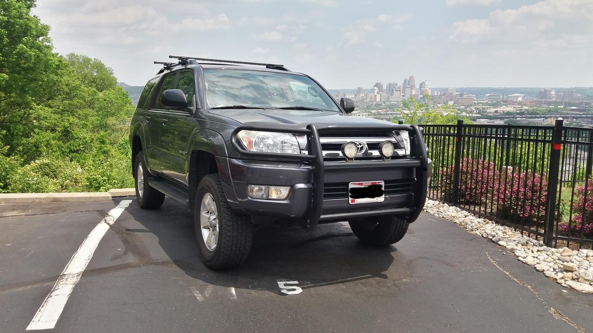

Sorry to not answer your question.. but I have a question for you..
Where did you get that grill?
Truck looks good
Truck looks good
I made it. Bought letters on customcargrills.com. On their website they have detailed videos on how to cut up the stock grill and make a pretty good looking satoshi style grill. I sourced the mesh myself because it was cheaper that way.
Also - thank you!

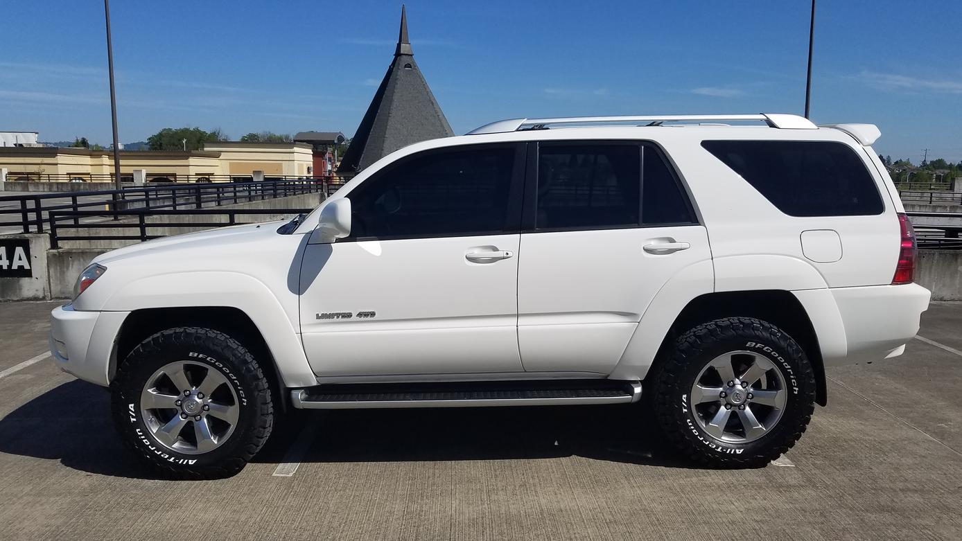

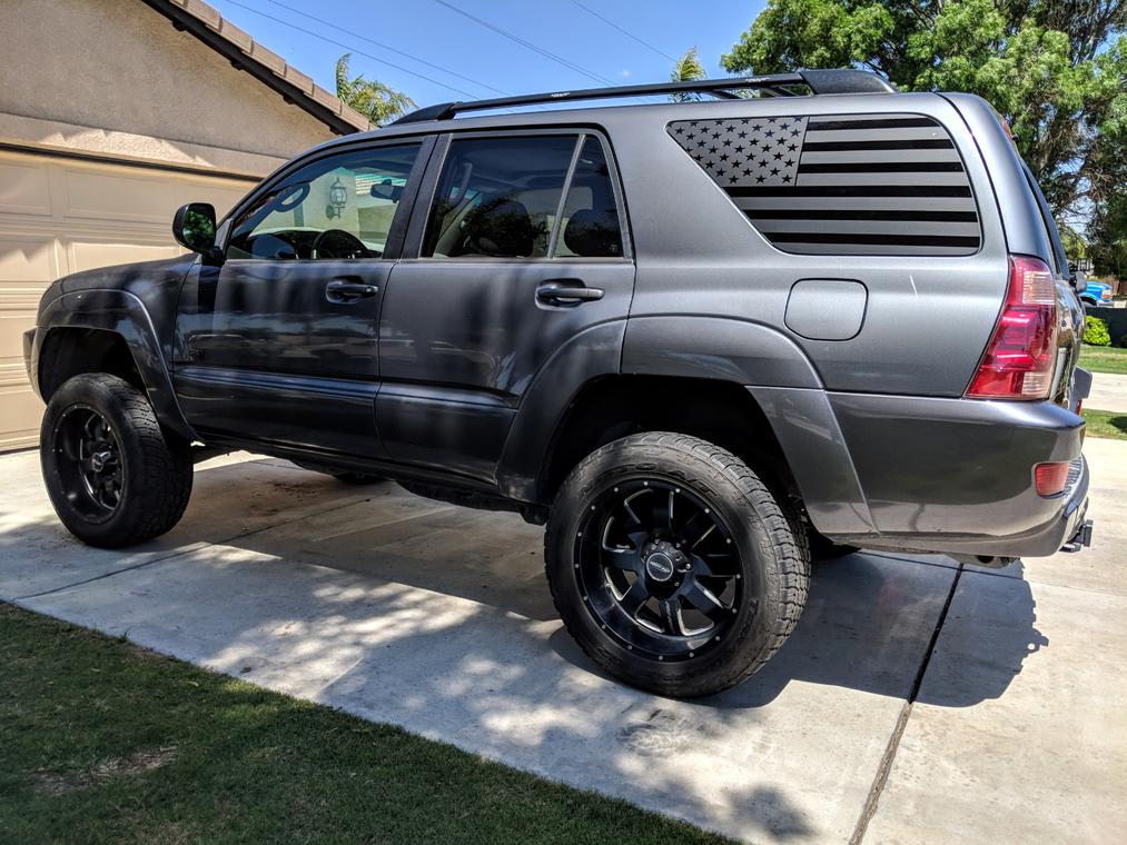

New shoes on my 4runner
just popped on some BFG KO2s. 275/65/18. they cleared the control arms with minimal rubbing on fender lining. Once Spidertraxx installed, major rubbing on liner. I plan on pushing them forward. I love the way my 4runner looks with new wheel spacers and 32s.

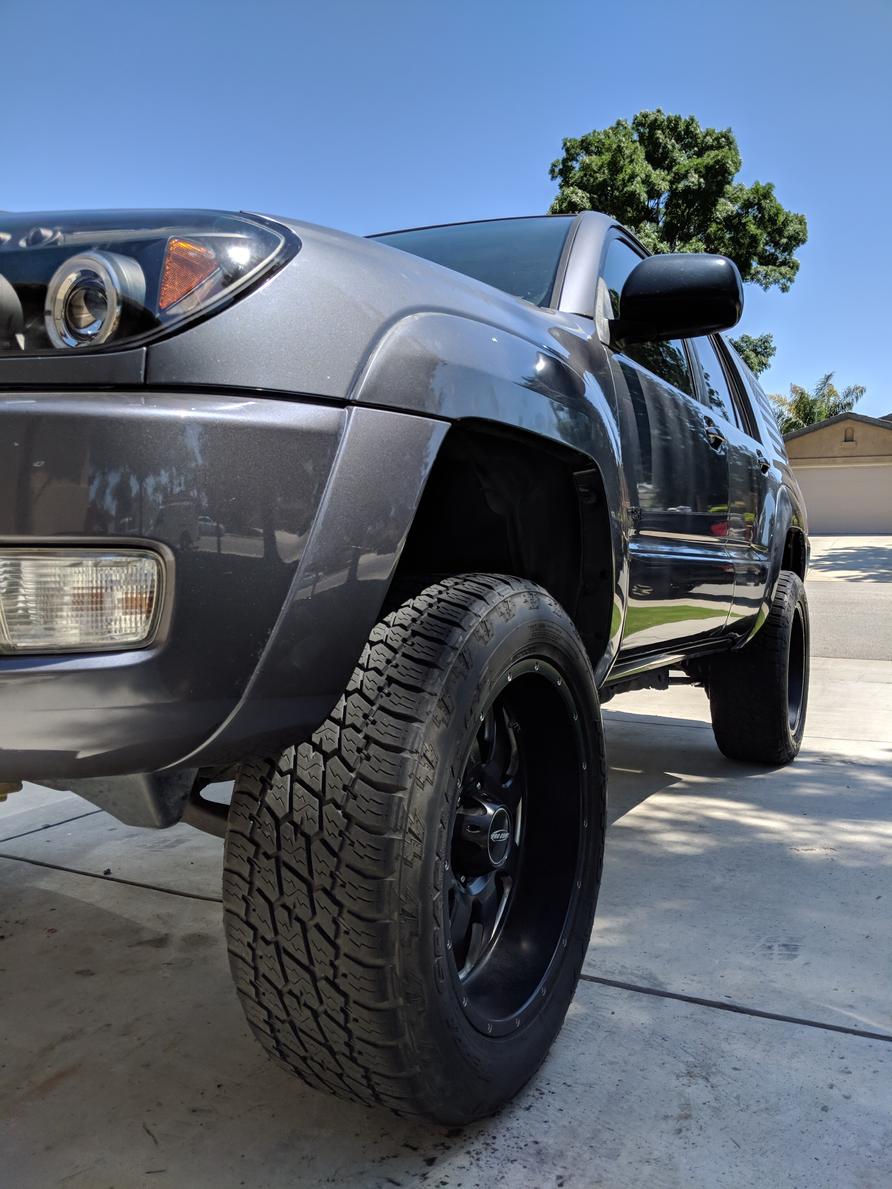

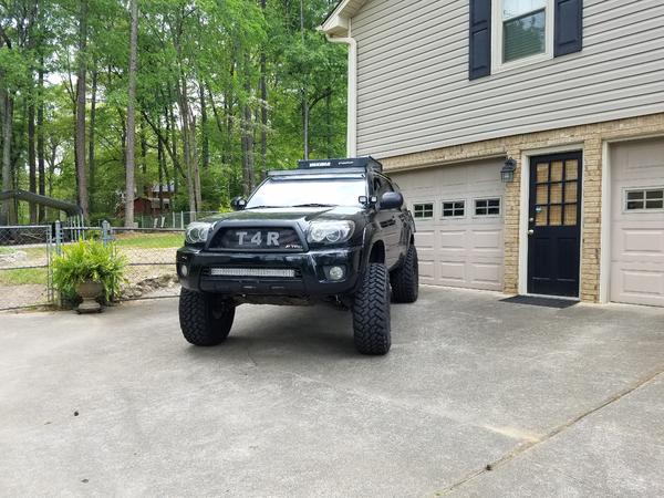

Front lift 5100 on .85, toytec spring 112620 and 1/4” plate spacer
Rear lift 5100 and 895
Wheels level 8 17x8 -10 offset
Tires 285/70r17 falken wildpeak at3w
What I would have done differently, gone with a heavier weight spring in the front. Rode great till I added the winch/bumper. Now it’s a bit divey. Was thinking of bumping the 5100 up to 1.75 to compensate, unsure how that would affect the ride.
How are you liking that lopro winch bumper, i'm not sure if id go full bumper or that option.
Does it come with the skid plate?

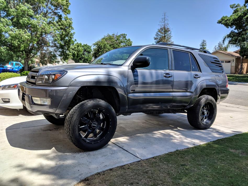

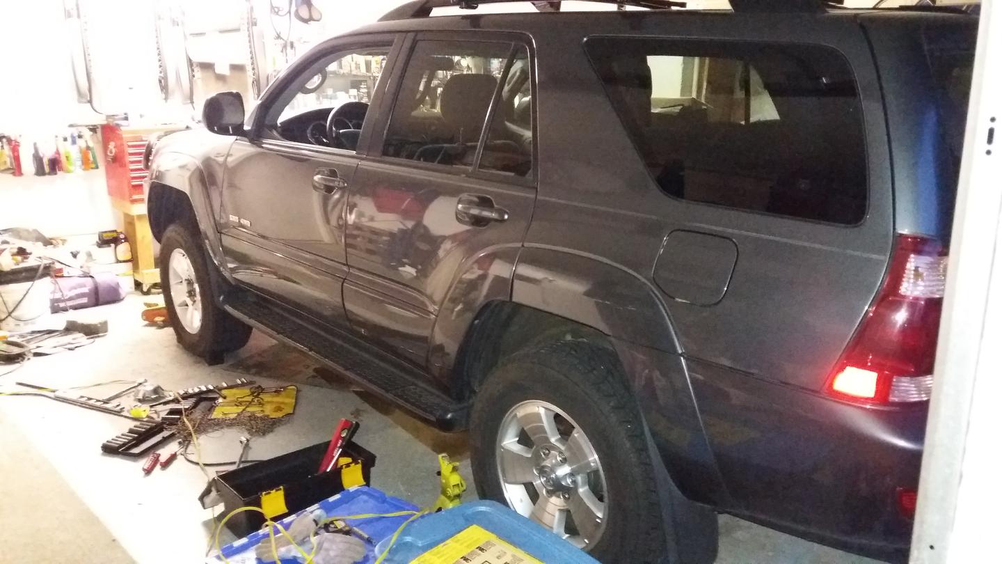

2.5/1.5 Daystar KYB strut plus combo on my 2005 v6 4x4.
New shocks and springs to go on the rear when the light comes back tomorrow.
Front is way high now right off the jack but should look good settled. You can see the sag from the big brush guard and age.
For sure had to remove sway bar and UCA to squeeze in the 2.5 spacer on the front. Wasted an hour fighting it at first then just gave in and it went quick. About 5 hours total for fronts. Hopefully just 2 or 3 for the rears.
Too bad the tires are nearly new or I'd go bigger lol.

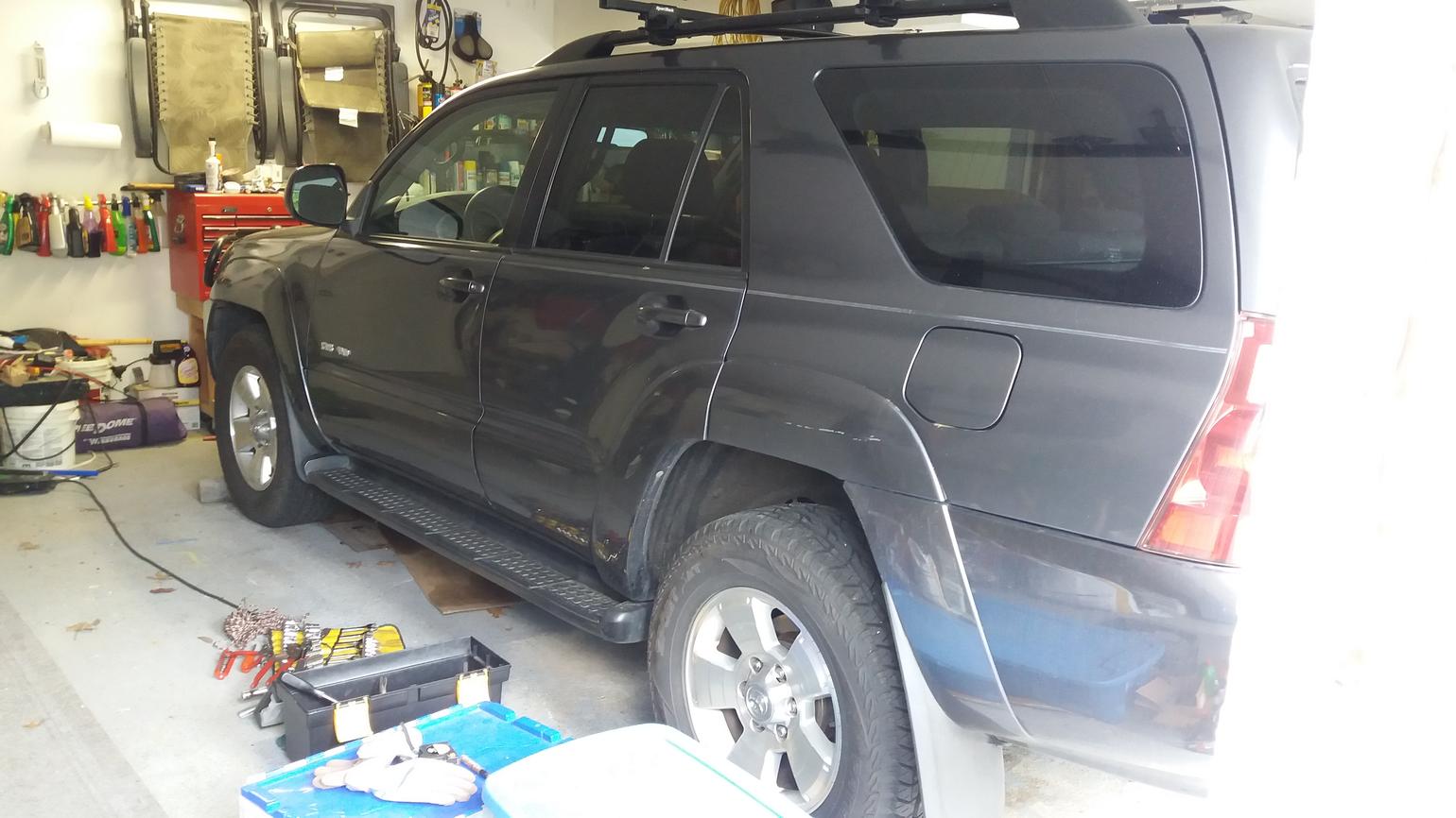

Rears on in about 2.5 hours. Sway bar end links had to come off to pry the rear down the extra bit but other than that, easy install of the reflex shocks and new springs.
Forgot to compare fronts in a photo, but they have +3ish coils. Rears have +1.

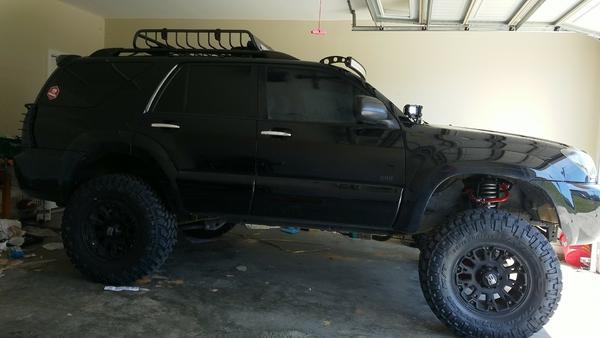

Excited to join the T4R forum and I just started with some upgrades for my 2005 4th Gen Sport Edition.
Here's what we did during the first phase:
-Toytec BOSS 2.0 suspension with 3" lift
-Spidertrax wheel spacers
-Trim packer to left rear
-Toyo MT 285/70/17 tires
This is what i'd like to add during the second phase:
-Relentless Fabrication "Defender" front bumper
-CBI skid plate
-Extreme LED light pods
-Extreme LED 30" light bar
-HID low beam upgrade

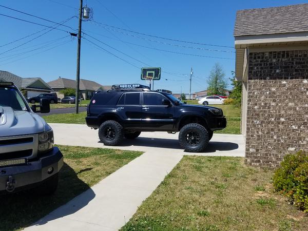

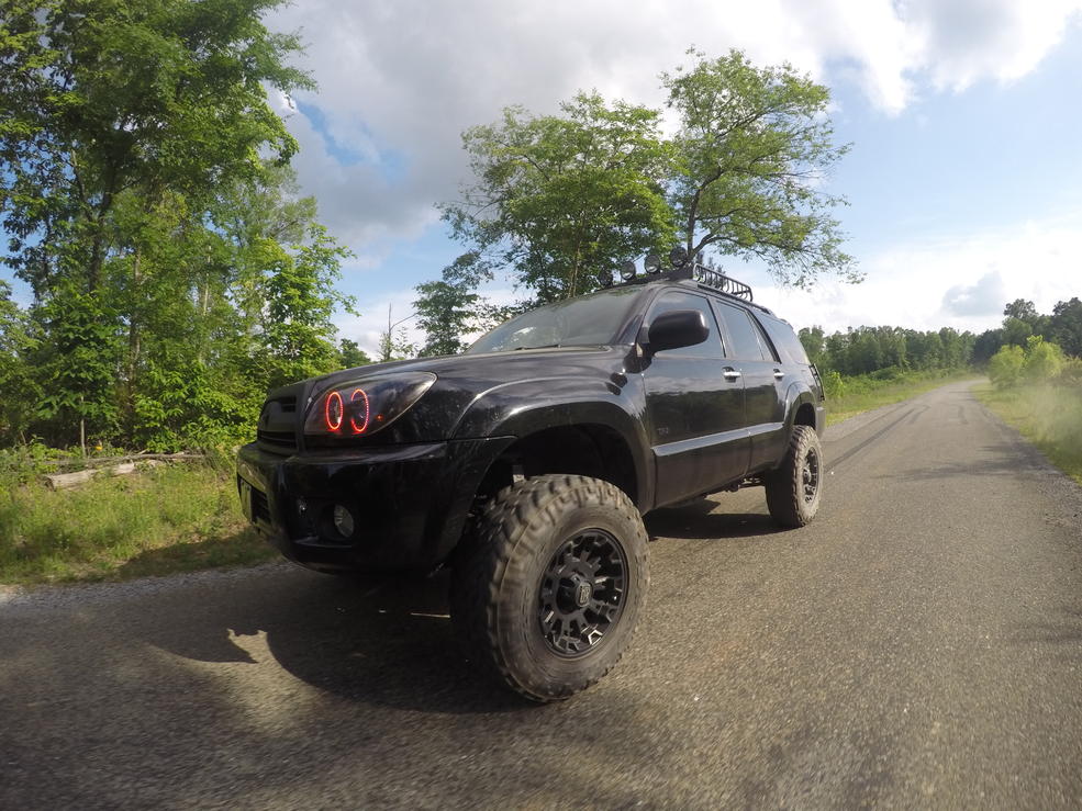

Suspension up front sitting on Maxtrac 4 inch spindles(yes sadly only 2wd) with Bilstein 5100's set at 0 with 2.5 inch toytec lift coils with a quarter inch spacer on the top, JBA UCA, and extended brake lines.
On the Rear - Fj 3.5 inch lift coils with the extendo fox 2.0 shocks with resi's, longer swayers from energy suspension, and soon to come is the inside lift block with air ride inside the fj coils to beef it up with lower links coming also(but that won't be on for another week or so)
Tires are 35x12.50 and only barely rub when offroad and flexed up or pinned into the fender well when turning, Ive got Body mount chops from relentless fab that Im in the process of welding on to fix this but really it fits the 35's very easy as i got almost 8 inches up of lift on the front from stock! Love the way it rides and handles, It had just the 3/2 toytec lift on it with 33's but decided to change it out and it was the best decision, Breaks necks everytime i get on the road (;
