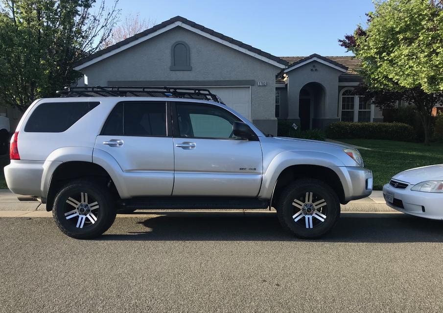

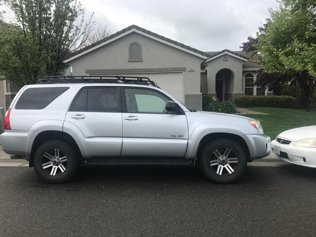

I ended up doing the Bilstein 5100s with OME 884s up front and toytech SuperFlex 2.0’s in the back. I think it looks great but I hadn’t accounted for the fact that the stock suspension already had 140k miles on it and it was sagging a bit. The end result was an lift of 3.75” in the front and 3.25” in the back.
I did it with a mechanic buddy of mine and it took a little over 2 hours because of rusted/difficult bolts but that was offset by the fact that I bought a new strut mount before-hand and compressed and assembled the strut the night before. We also didn't loosen the control arms at the cams and just pried the LCA down (definitely a two-man job but saved some time).
Currently wearing down the tread on a set of 265/70/16 Hankook Dynastar ATMs. Looking at BFG AT KO2s at 275/70/16. I would like to go up to the 75/16 but want to stick with a D load tire or lower and it can't rub cause it is my wife's DD.
The 4Runner is my wife’s DD and really didn’t want it too stiff which is why we did the Superflex springs in the back. We both love the new ride! Nose drive and body lean decreased and the ride is actually smoother on paved roads and forrest roads. Off road (light trails) I don’t notice a big difference in the ride but the clearance is SOOO much better.
The lean: This 3.75/3.25 lift is measured on the passenger side- driver side was exactly 0.5” lower in front and in back. It was dead level before he lift. It leans enough that I can notice but only when I am looking for it. I like not having one spring preloaded more that the other one but honestly I highly doubt it makes a difference.

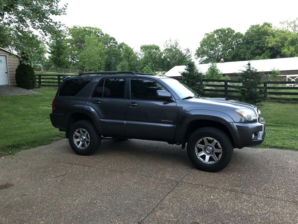

Hey y'all! I'm new to the forum, so if i'm doing this wrong, please don't flame me. This is my 2006 Sport Edition with 2017 Tacoma TRD Off-Road shocks and struts. They are Bilstein 4600s. I also have take-offs from a 2016 Trail Edition 4Runner with the stock 5th gen 265/70 bridgestones. I still have the stock 2006 rear coils, but they have a 1.5" daystar spacer on them. The one thing I look forward to changing about this all is getting some more aggressive tires. The bridgestones are great on road, but lack off-road. Glad to be here!

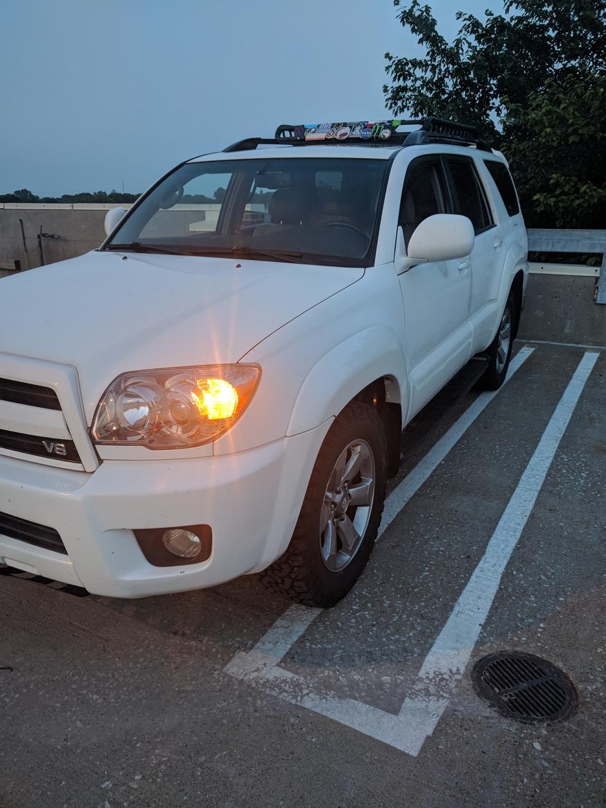

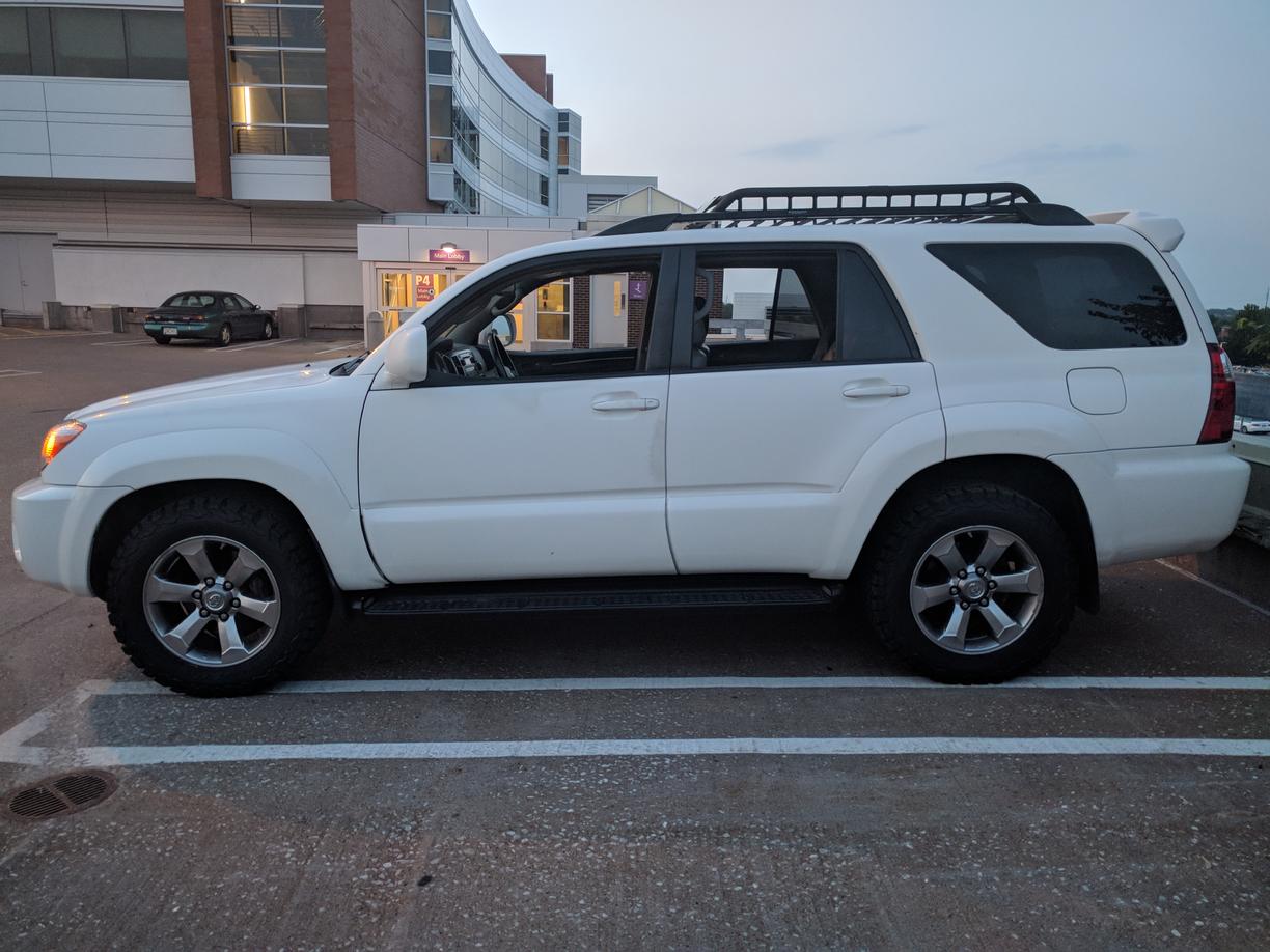

I just installed OME 886 with 895E rear springs. Bilstein 5100 all around.
No ARB bumper/winch and regular all season tires.
Closer look
CV Angle
Also installed Wildpeaks in 265/70/17
I'll post alignment numbers later but so far I like the ride. More planted and no more diving when braking. Hope to see the suspension settle down a bit as I put some more miles on it.

Thanks for the pics! That setup looks really good. Hopefully my 895's will make the rear sit a bit taller than yours.
Is yours the V8? I'm thinking it's a v6, but want to double check.
Are you on stock UCA's as well?
Yeah mine is the V6 in stock UCAs. Firestone could only get me to .5 caster but so far the ride the good enough for me. Are you thinking about getting aftermarket UCAs?

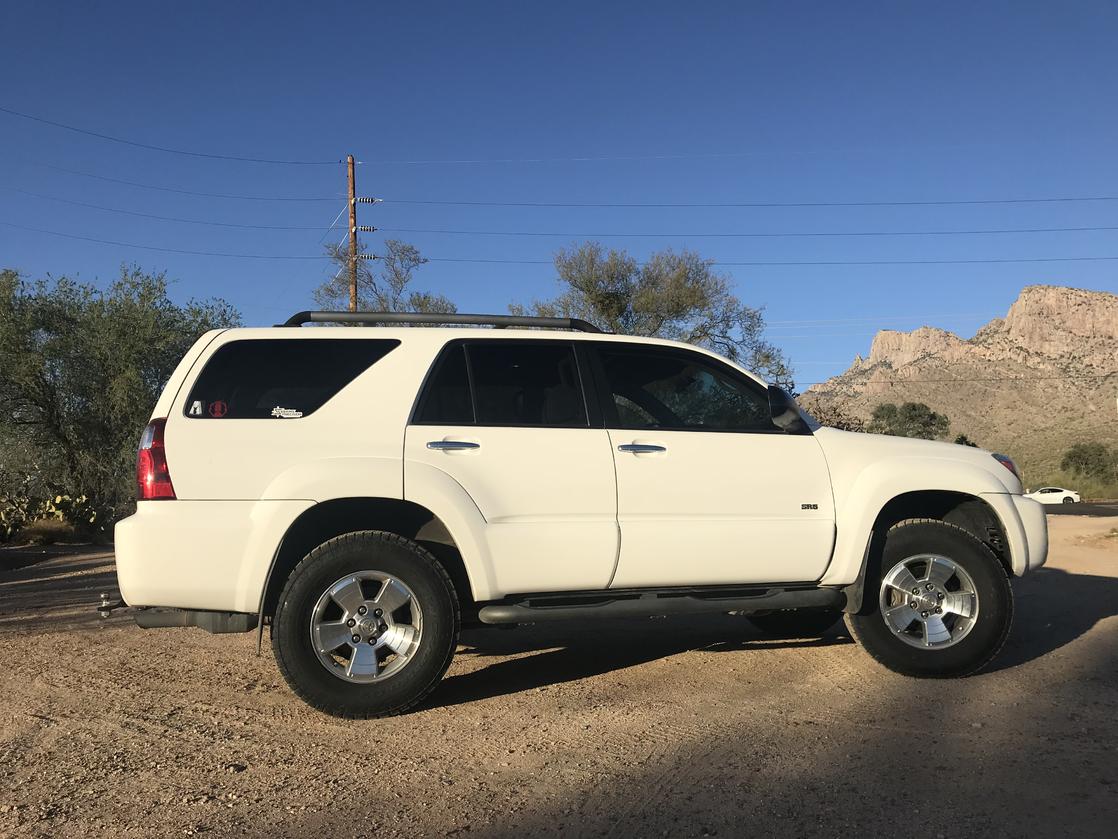

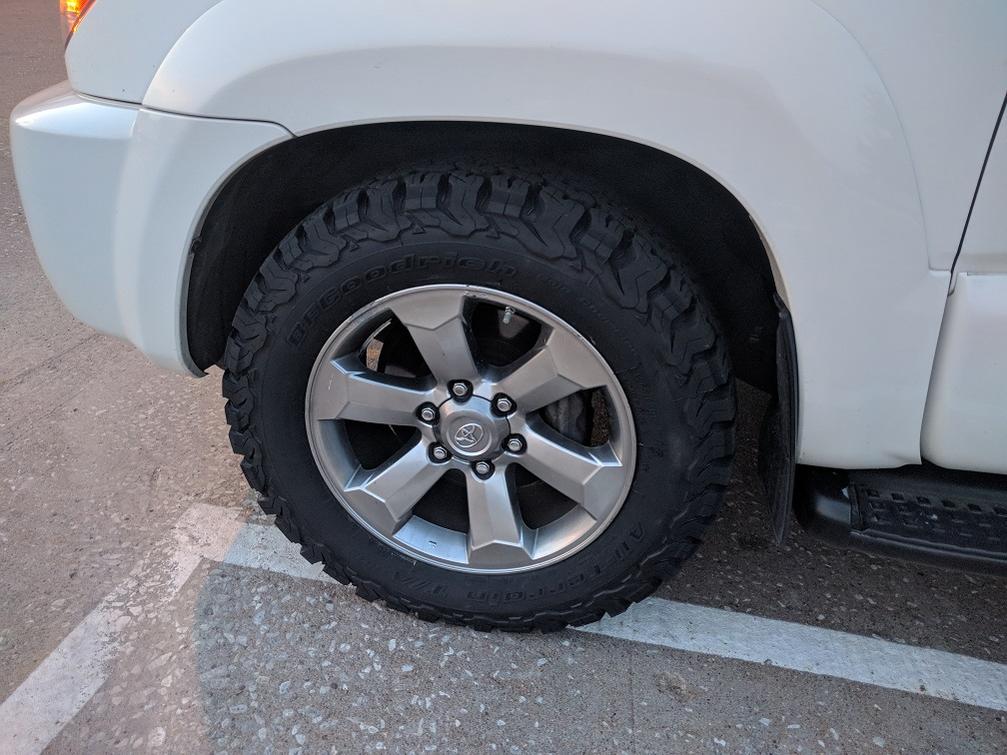

265/60/18 BFG K02's on stock suspension. Dirty and 220K on the clock-
As expected, they look a bit small and could use some spacing, but overall I am very happy with the tire feel/sound/look. :thumb:

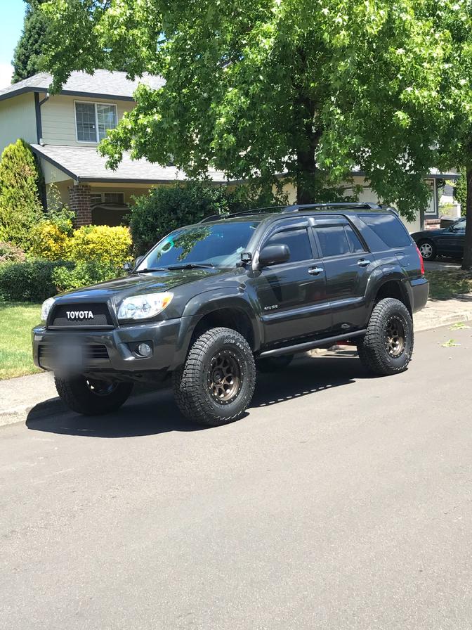

Icon extended travel coils w/heavy springs.
Icon Overland rear springs w/Icon 2.0 shocks
JBA Offroad UCA
RESZ Fab lower links
SCS Ray 10’s wrapped in Falken WildPeaks AT3W 285-75-17
