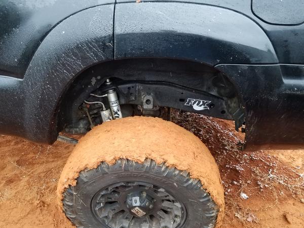

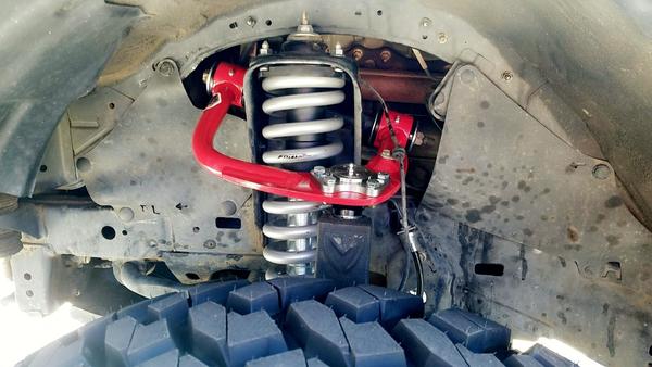

2006 4runner Specs:
Suspension up front sitting on Maxtrac 4 inch spindles(yes sadly only 2wd) with Bilstein 5100's set at 0 with 2.5 inch toytec lift coils with a quarter inch spacer on the top, JBA UCA, and extended brake lines.
On the Rear - Fj 3.5 inch lift coils with the extendo fox 2.0 shocks with resi's, longer swayers from energy suspension, and soon to come is the inside lift block with air ride inside the fj coils to beef it up with lower links coming also(but that won't be on for another week or so)
Tires are 35x12.50 and only barely rub when offroad and flexed up or pinned into the fender well when turning, Ive got Body mount chops from relentless fab that Im in the process of welding on to fix this but really it fits the 35's very easy as i got almost 8 inches up of lift on the front from stock! Love the way it rides and handles, It had just the 3/2 toytec lift on it with 33's but decided to change it out and it was the best decision, Breaks necks everytime i get on the road (;

How do you like the fox 2.0’s? I’m going to be upgrading my shocks soon and have been looking at these more recently.
Awesome 4runner!
Thanks man, appreciate it! The Fox 2.0 are awesome no doubt about it!! They def do their job and ride great! would recommend. Although if I had the extra cash I would have probably gotten King long travel shocks with the reservoirs but either way you are not going to be disappointed
Awesome, that’s good to know! My initial plan was to go with 5100’s all around but at the moment I’m leaning more towards the Fox 2.0’s. I’d love to get some Icons or Kings but I need/want to upgrade my suspension all at once and the price point for that right now is out of my range.
If I can get them ordered through the local shop here that I go to I’ll likely be going with the 2.0’s over the 5100’s. We’ll see. Thanks for the response man, and welcome to the forums!

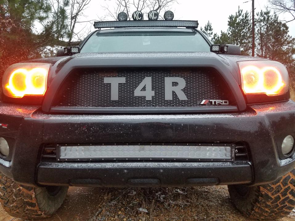

New lift yesterday, new tires today, test mission after work.
Icon stage 2 with SPC UCAs, 275/70/17 BFGs.
Rubs a little bit on the fender and on the sway bar if I really try.
Did you make that grill?
Bada$$ looking truck buddy!!!!
Preciate it! and yessir ordered the pieces off of custom car grills and put it all together, they got some pretty cool grills if you are looking to upgrade!

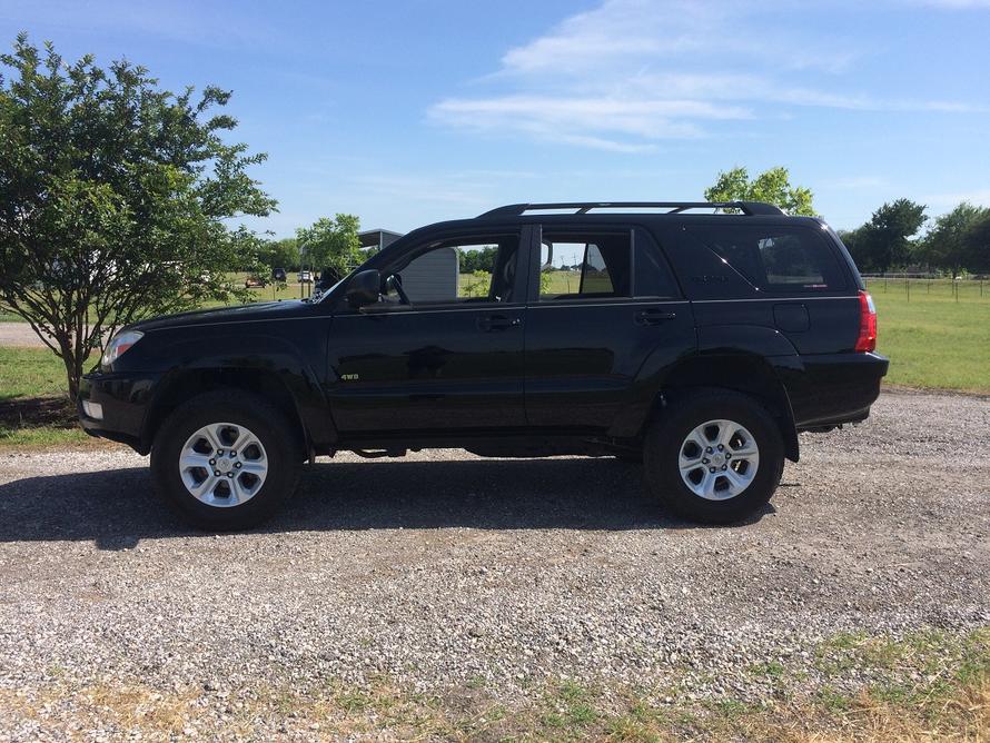

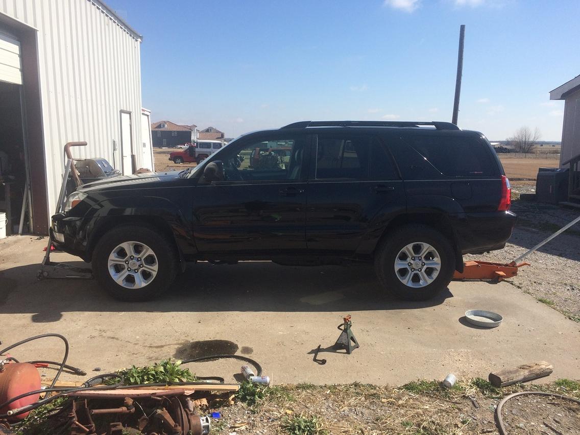

I went with KYB quick struts for an FJ along with a 1" spacer on top. I got over 2.5 inches of lift in front. Even after settling. Rear 1.5" daystar spacers along with KYB shocks. 265/70/17 Hankook Dynapro Atm tires. Measurements from ground to fender (I know its not the preffered way to measure) are
Front Driver 37 1/4"
Front pass. 37 3/8"
Rear Driver 37 3/4"
Rear Pass 38"
I am very happy with the way it handles compared to old stock parts. I don't off road much. In fact it has never seen mud. yet.... I also replaced lower control arms with aftermarket ones. And Upper control arms with Freedom off road that correct caster. Getting another alignment done this week. Also switched the rear sway bar links with longer 2nd gen ones with poly bushings and putting on a sway bar relocate bracket in the front due to contact on the lower spring perch. Heres some pics. sorry for the uneven ground and the after lift pic is before the front settled an inch. Ill update this with better pics soon.
before lift
<a href="http://s1255.photobucket.com/user/kros420/media/20170421_194714_1.jpg.html" target="_blank"><img src="http://i1255.photobucket.com/albums/hh632/kros420/20170421_194714_1.jpg" border="0" alt=" photo 20170421_194714_1.jpg"/></a>
after lift
<a href="http://s1255.photobucket.com/user/kros420/media/20180501_200222.jpg.html" target="_blank"><img src="http://i1255.photobucket.com/albums/hh632/kros420/20180501_200222.jpg" border="0" alt=" photo 20180501_200222.jpg"/></a>

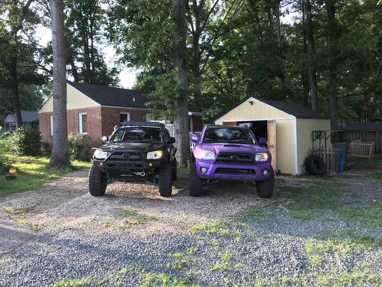

A little before and after. Went from a icon front toytec rear to a camburg 3.5 front with kings and a metaltech lt rear with HD springs and 1.5” spacers on top of the coil springs. And some SCS ray10’s 17x8.5 wrapped in nitto 35x12.5
Wrap or what? That looks sweet!
