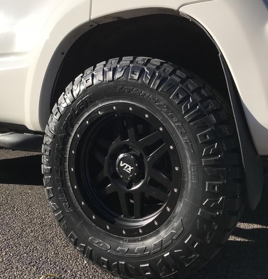

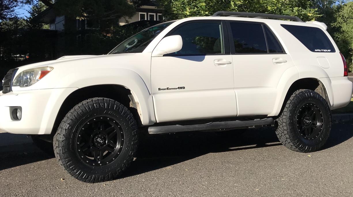

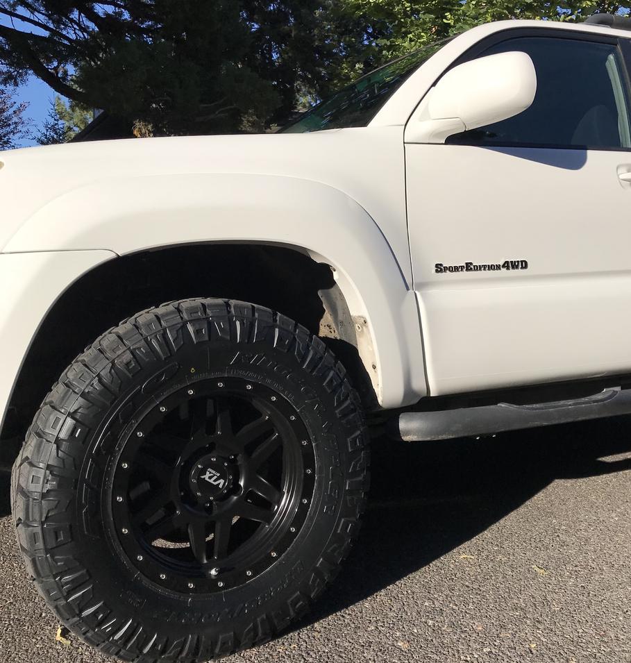

Whats up everyone. This is my first post on here. Bilstein 5100's all around set at 2.5 in front and using a 1" spacer in the rear to bump it a little bit. Just got my new 17" VTX Viper wheels mounted with Nitto Ridge Grappler 285's today and couldn't be more stoked with how it looks and rides. There was some trimming necessary in order to get the 285's to work, but it wasn't as much as I would have thought.

Very nice! I was wondering why my runner wasn’t sitting level? I put 2.5” spacers all the way around. I’m assuming that I shouldn’t have put the 2.5’s in the rear?
Correct. Yea, you'd want like 1.5" rear with that front setup. Also, remember, we can custom make ANY size you want, front or rear.

I am at 142k on my '08 with XREAS still engage. How do you like the bilsteins with the XREAS removed? Been thinking of doing the same..
I 100% recommend. I can feel the smaller bumps a little more but it rides and handles so much better than the xreas. It gives it a sportier feel. The whole body doesn’t roll on corners anymore and the nose dive improved significantly. I didn’t have any leaks or anything wrong with the xreas, I just wanted a suspension lift. It looks 1000 times better with the suspension lift. Not to mention it rides fantastic off-road. The faster I drive the smoother it gets. I was bouncing all over the place with the xreas.

The ride looks awesome!! I have a white sport edition as well. I’m looking at getting the grapplers, after seeing them on your car I think you’ve confirmed my decision!!
Update!
UPDATE: After a couple days and an alignment, I needed to trim a little more. If I had known from the start, I may have looked at some 275 options but given I already had it all installed, I had already started removing the insides of the genders and so forth so I didn’t care as much at this point :). Still super happy with the setup. As for the ridge grapplers, they are amazing. Been Drooling over this tire for a while and finally pulled the trigger.

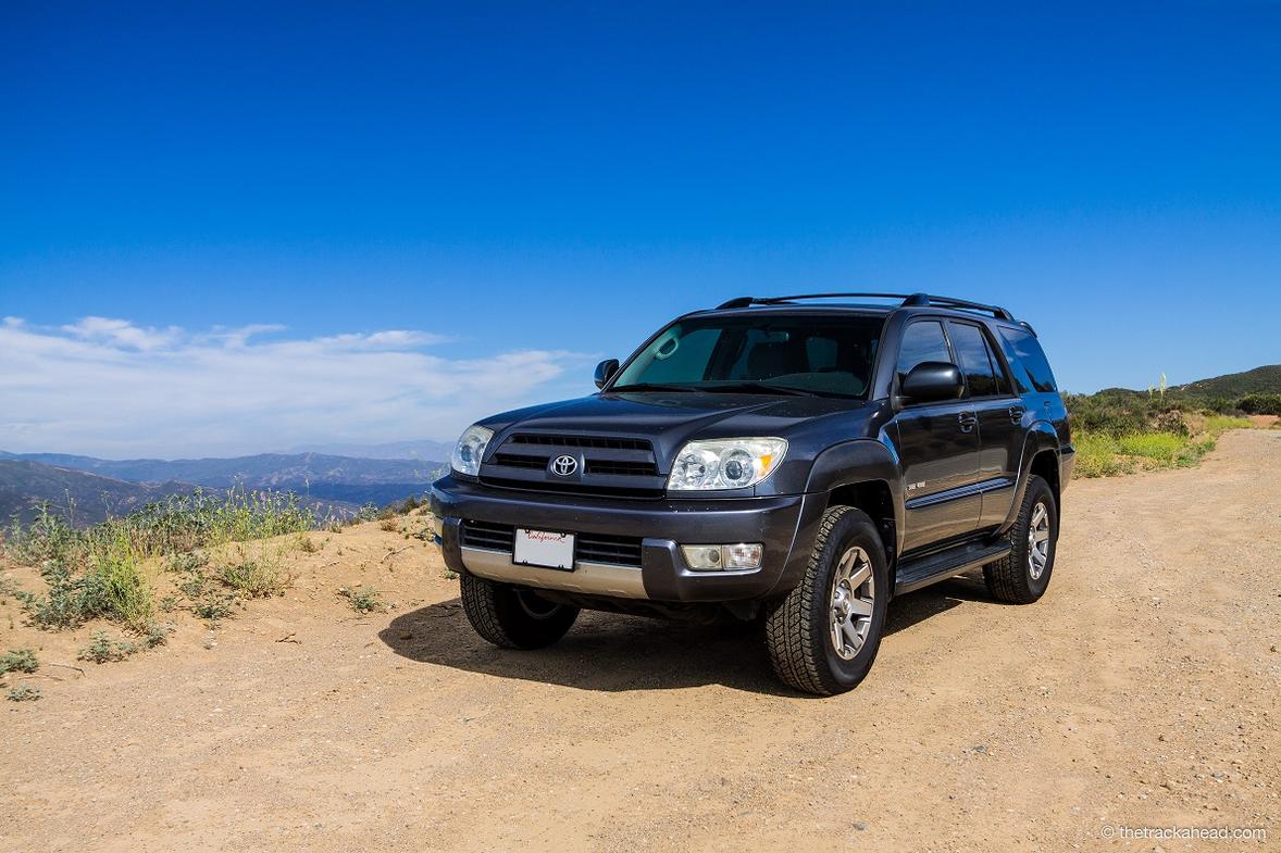

'03 4Runner SR5 4x4
At stock height:
With FJ springs and 5100's all around (front set at 0.85")
If you want to read more about it I wrote about it here.
And how it sits now with 5th gen TE wheels and with stock tires. When it's time to replace the tires, I'll be going with some KO2's to complete the look.
What size tires are those and what's the spring rate?
Tires are 265/65r17 Cooper Discoverer RTX. They were on there when I bought it, but they aren't bad. I will go up to a 265/70 tire after these.
Springs are C59-300 up front, 385/385mm, 17mm wire, 586LB and C59-505 in the rear, 405/405mm, 17mm wire, 220LB
