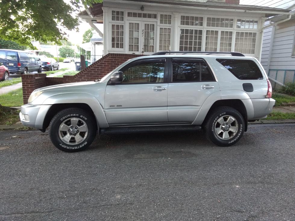

Quick question for you. I have a 05 SR5 with a 3" Toyota lift. I tried to get BFGs 265.65.17's and the tire place told me they will not fit. I ended up getting Destination ATs and they are ok but I have had BFGs before (on my older 4runner) and they last forever and look great. Could I simply just requested 270.70.17's and been good to go?
Yes, they will fit. I run 255-80's with a three inch lift, had to trim some from the fender liner but they fit.

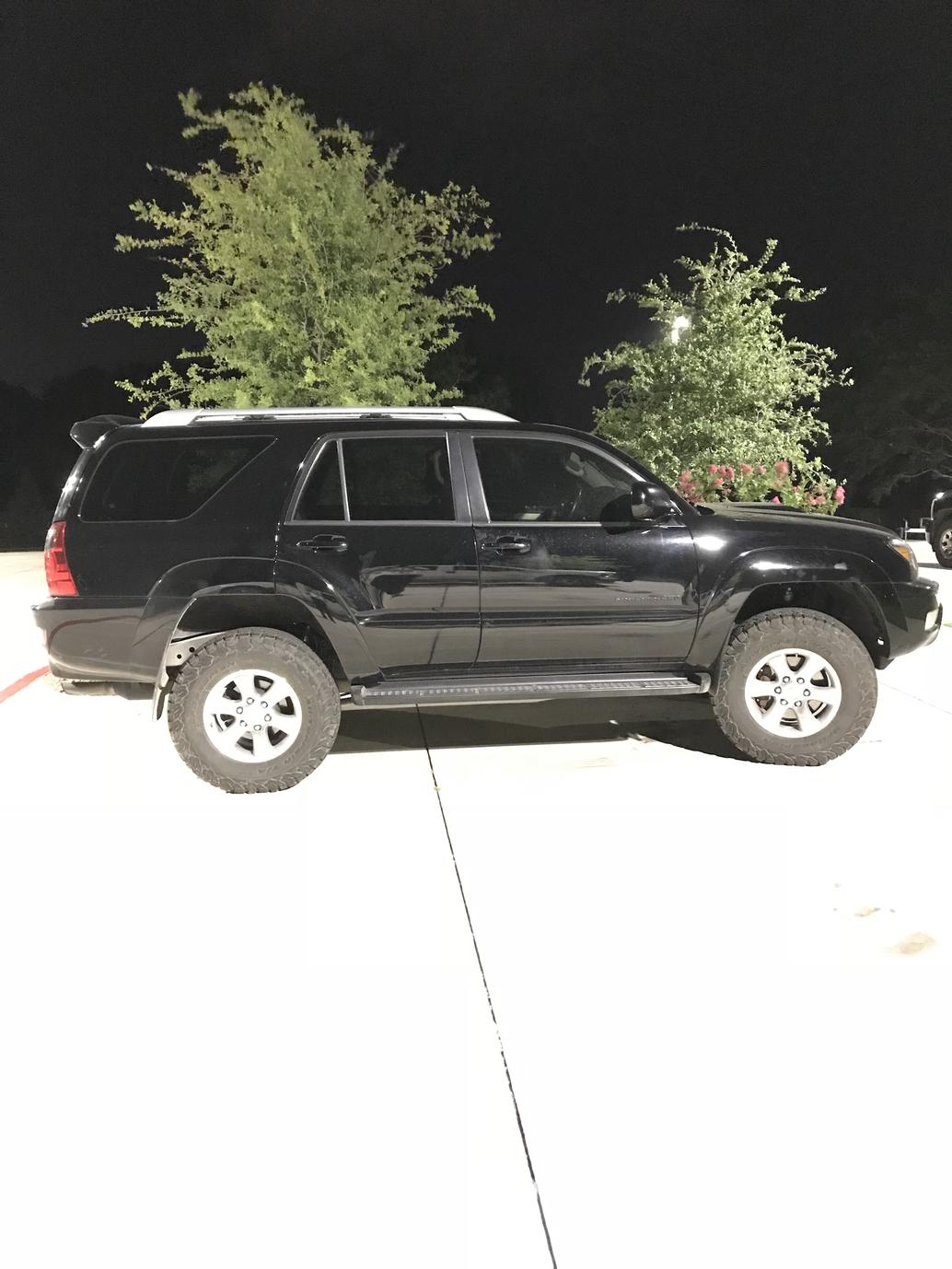

Noob here. Just got my 2005 Sport. Dropped in a level 1 Icon 3” and swapped out for 285/70 R17 BFGs on the stock rims. Love the setup, but weighing either spacers, new rims, or UCAs to resolve some rubbing issues on the control arms.

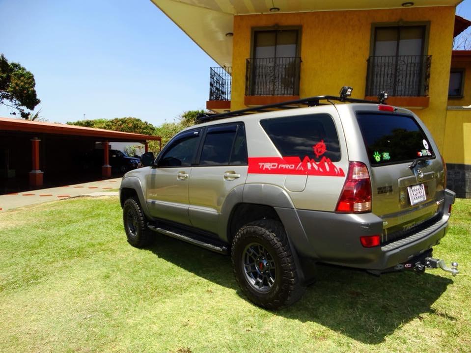

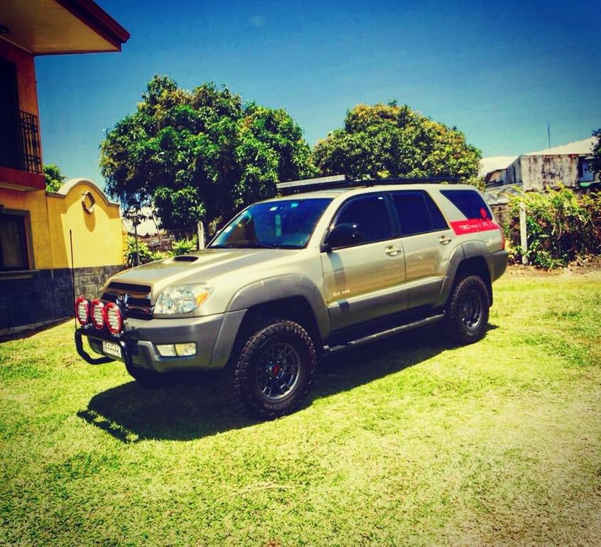

Finally finished my upgrade! Took me 7 hours to do the install all by myself which was a bit longer than I expected, but I'm extremely happy with the result. Biggest hiccups during install was a sway bar bolt that kept spinning, leaking inner CV boots, and the time it took to fit the rear springs. I used the bottle jack method on the rear axle and it just took forever to turn that thing. I prepped everything by watching YouTube videos and made sure I had all the right tools. Ratcheting wrenches are a must and the strap wrench for the rear shocks was clutch. Specs are:
Bilstein 5100s all around, set to 0
OME 884 front with 1/2" spacer on driver and 3/8" spacer on passenger
Toytec Superflex rears
SPC UCA's
Nitto Terra Grapplers G2 285/70/17
Spidertrax spacers
Alignment came in perfect, I'm glad I got the upper control arms. I think the tires are perfect and the spacers give it a nice stance. Let me know if you have any questions!
First photo is after lift, 2nd and 3rd are after tire install and alignment.
Sent from my SM-G965U using Tapatalk
This looks perfect! Exactly the look I'm going for with the '04 V8 Limited I just picked up. Same tire is my first choice.
How much trimming/cutting did you have to do for clearance? What size spacers?
