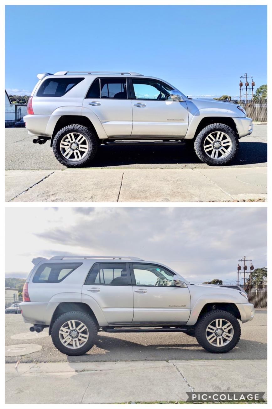

1EB804D0-8B03-41D6-880A-F7A5D0E0DBD3.jpgJust swapped out 600#3” ID bilstein 6112 springs (max perch) 700# eibach 14” inch 3” ID. Got a little more lift and a bit less rake. Ride is very firm, but I hope it settles. Top picture is 600# bilstein springs (broken in), bottom is 700# eibach springs freshly installed (not broken in). 1/2” inch spaced on driver side and 1/4” spacer on passenger side. Got the silver eibach 700# spring just for a little more bling.

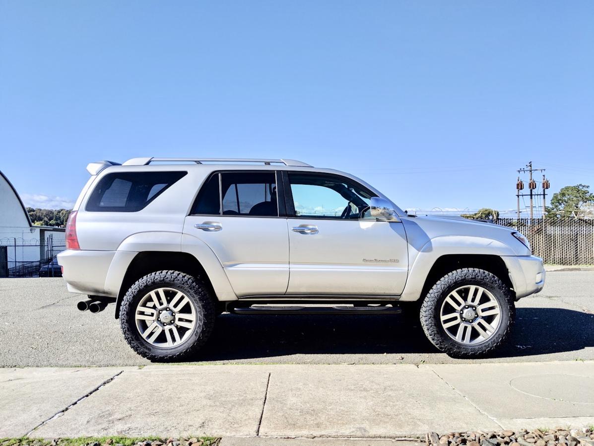

its my time to show. collected parts for a while and got the job done. 2011 17" gen 5 alloys which i believe are 7j ET15, so it pushes the wheel out further away from the strut by 3/4" , and sticks the whole wheel out further by 3/8".
+ 255/75/17 yoko geo's @32.1" dia.
monroe quick struts , new 1A-LCA and UCA & OEM hardware. so really just stock suspension refreshed with rough country 2/1 . no rubbing.
Ive gained 3" on the front, and 0.5-1" on the rear , at 15" under the side step.
from the ground 37" at front, and 22" to fender lip on all corners except driver side rear which is 21.5" , the springs are old in the rear so i may refresh them and it bump it up maybe 1/2".
before the fender clearance was this:
18.5, 19, 21.5, 21

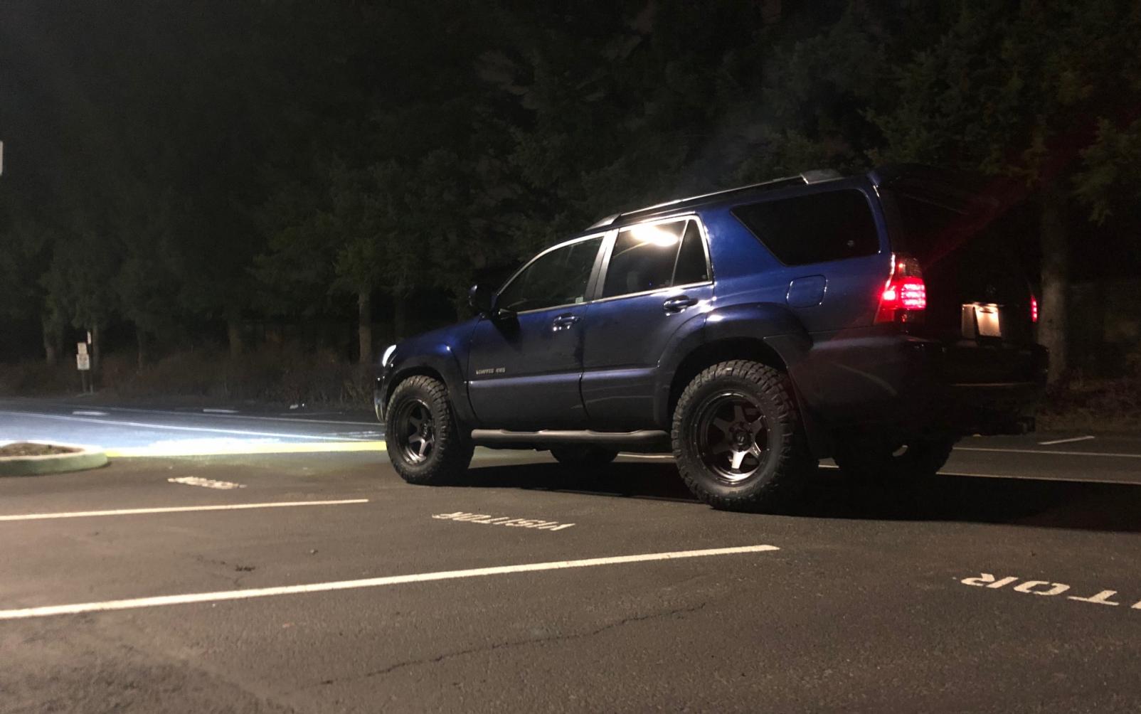

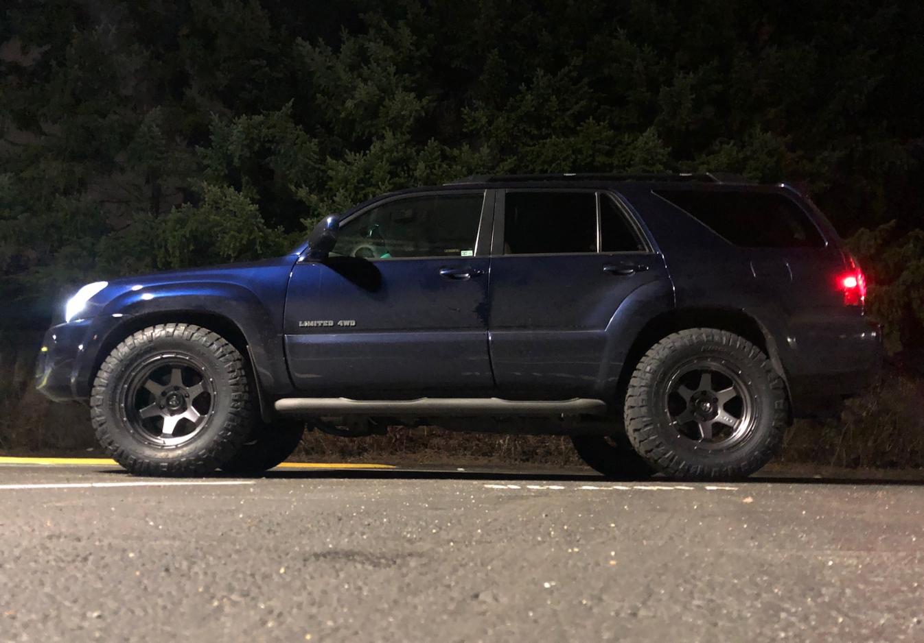

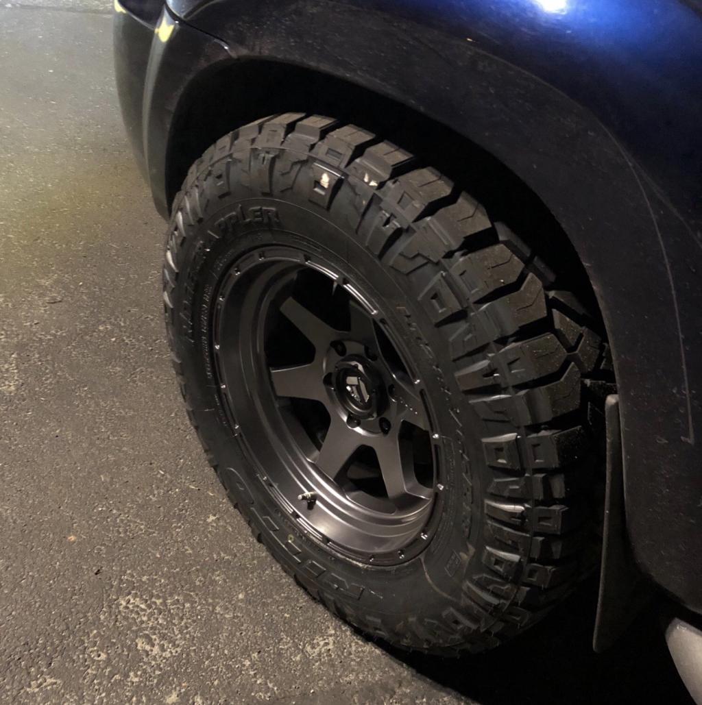

NITTO 285/65/18 Ridge Grapplers on 18x9” wheels with negative 12 offset on STOCK suspension.
Toytec ultimate with ICON UCA’s going on in a couple weeks. Nothing you guys already don’t know. Clearance with wheel well is tight. Rubbing front fender liner with turns. However... for those curious as to just how big of a tire you can run on stock suspension, the liners can be trimmed.
Regarding the tires and driving/highway manners... The Ridge Grapplers are a mix of the Nitto Terra Grapplers all terrains and their Mud Grapplers. These are amazing tires. Tons of grip. Quieter than my Toyo all terrains. Nearly silent on the highway... which is incredible considering the huge sipes for snow and mud. Very happy with these.

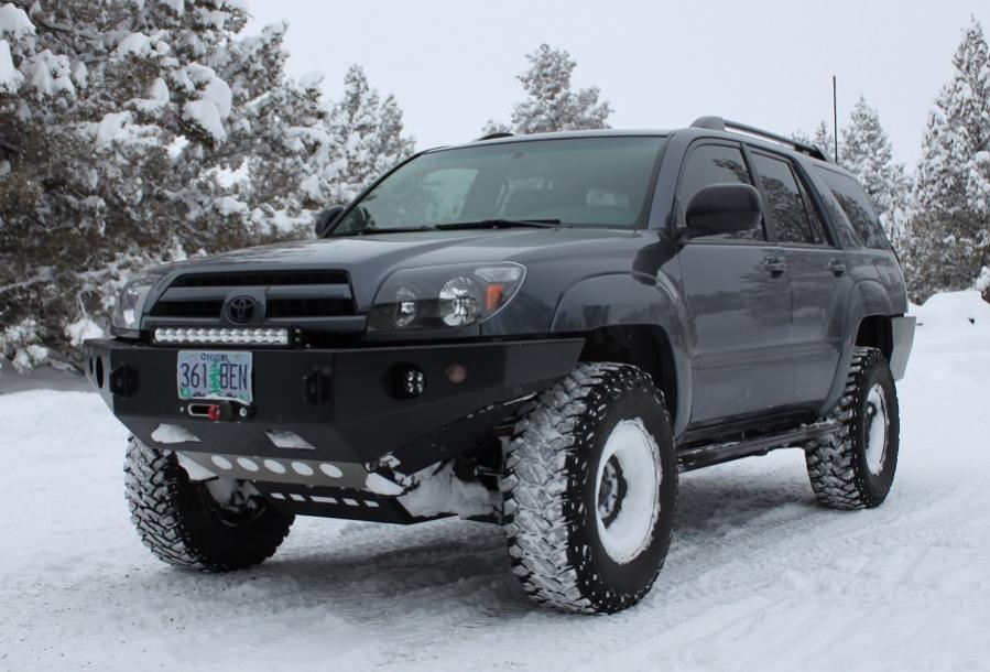

Going to copy lift, wheel, and tire details here in case my signature changes in the future.
Lift details:
Dobinsons Suspension
Front: 3" - C59-302 + GS59-220
Rear: 2.5" - C59-675V + GS59-701
Tires:
Nitto Ridge Grapplers
275/65/18XL
Wheels:
Method Standard Machined
18x9" with -12 offset
Rear is sitting a bit lower than normal as the 5 factory rims are loaded in the rear.
Old Rims, but obligatory "not a pavement princess" pic.
Link to Imgur album.
