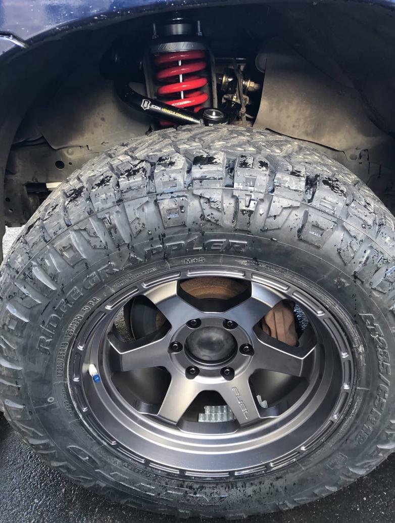

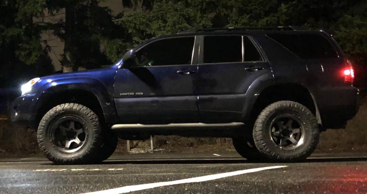

Going to copy lift, wheel, and tire details here in case my signature changes in the future.
Lift details:
Dobinsons Suspension
Front: 3" - C59-302 + GS59-220
Rear: 2.5" - C59-675V + GS59-701
Tires:
Nitto Ridge Grapplers
275/65/18XL
Wheels:
Method Standard Machined
18x9" with -12 offset
Rear is sitting a bit lower than normal as the 5 factory rims are loaded in the rear.
Old Rims, but obligatory "not a pavement princess" pic.

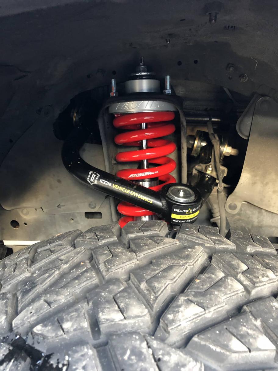

Toytec 3” coilovers and Icon delta joint UCA’s are on!

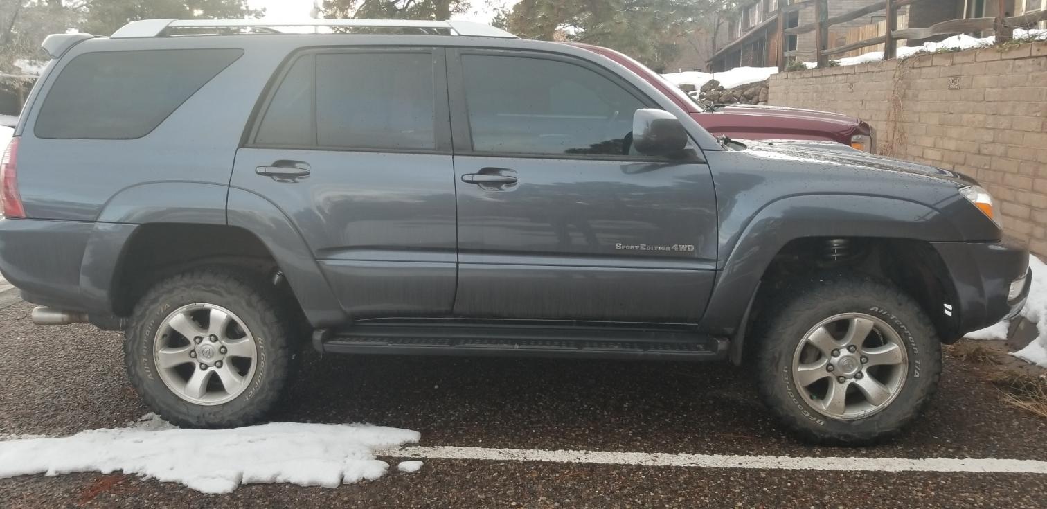

2008 V6 Limited.
2.5”/1.5” Daystar spacers on a clapped out Xreas stock suspension.
17”x7” TRD Wheels
255/75r-17 BFG KO2’s
