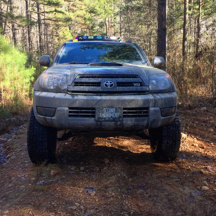

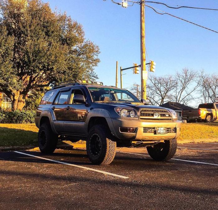

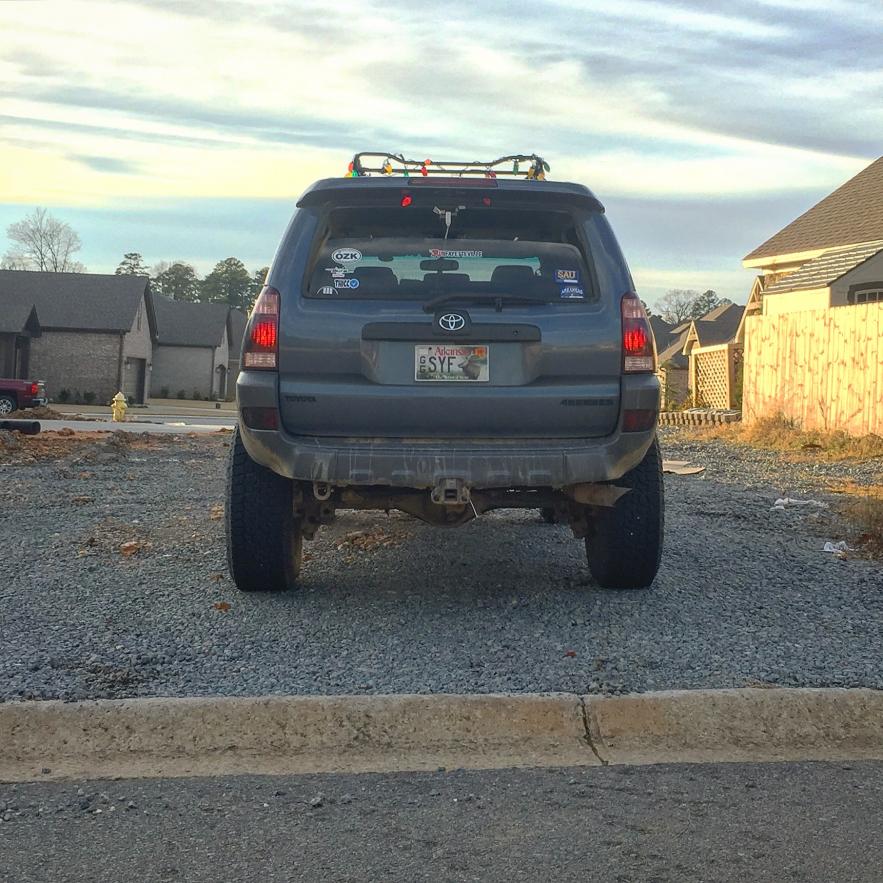

5” lift and 34s
Vehicle specs: 2003 Sport, V8, 2WD
I’m running Bilstein 5100 shocks on all four corners set at 0”. In the front, I have Old Man Emu 884 springs for 3.5-4” of lift. In the rear, I put in Wheeler’s T12 springs for approximately 2” of lift. I have a 10mm Old Man Emu trim packer on the driver side rear and 1/4” spacer on the driver side front to level it out left and right to accommodate for driver side lean. On top of all this, I have a 1” Toytec body lift to help clear the bigger tires. At the moment, I have stock UCAs but am upgrading to SPC soon. My tires are Falken Wildpeak AT3W in 285/75/17 (Yes I said 75 instead of 70). My wheels are Trailmaster TM220 17x9 with -6mm offset. Also have 1” wheel spacers to widen the stance a little bit. Almost forgot about my 2” bumpstop drop from Toytec.
For my set up, I had to trim about 1/2” from the rear bumper and 1” from the front fender to clear the tires when flexed out although I still run to an extent. Highly recommend getting UCAs with your lift

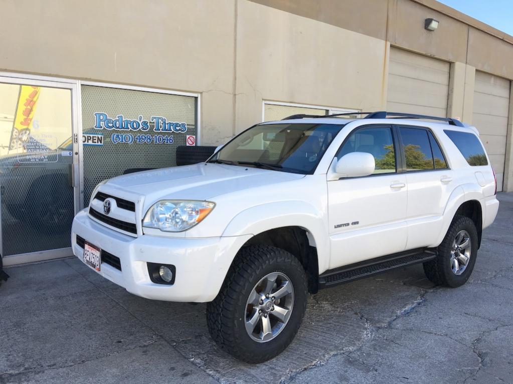

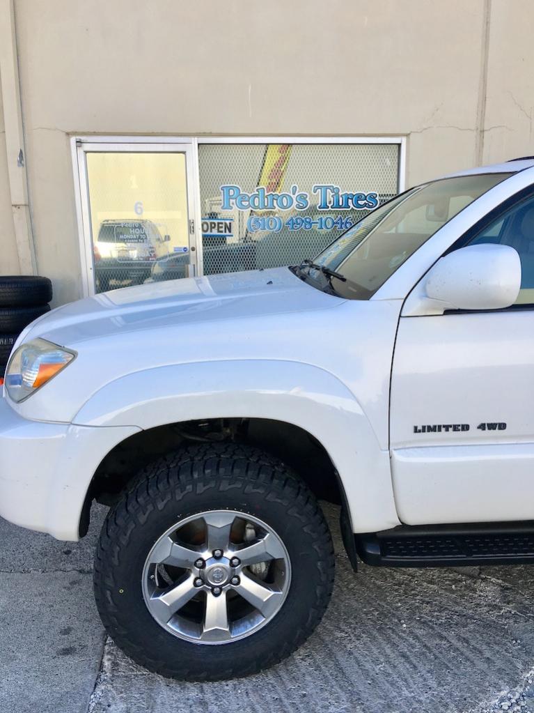

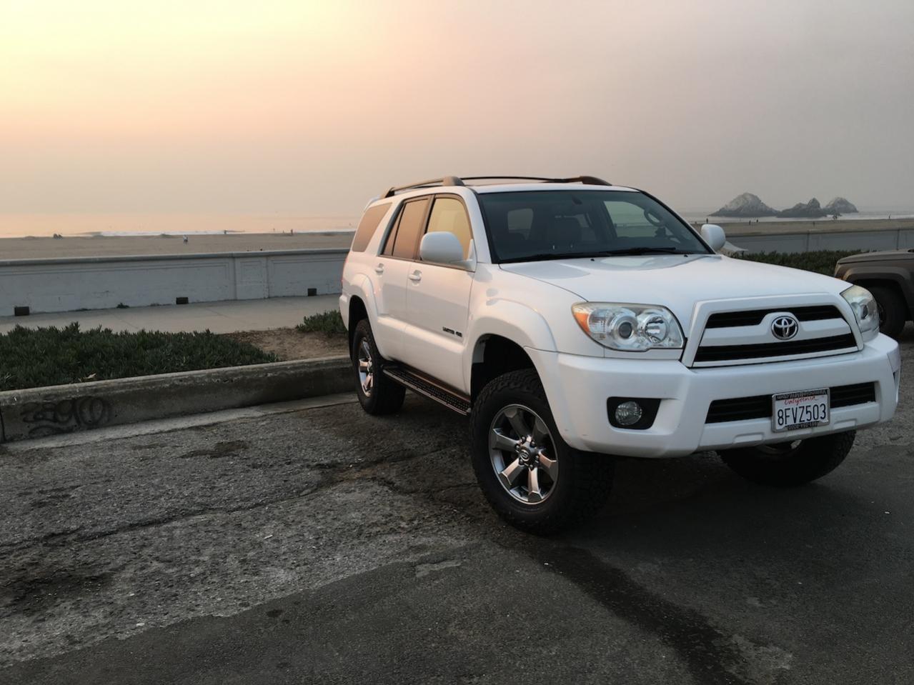

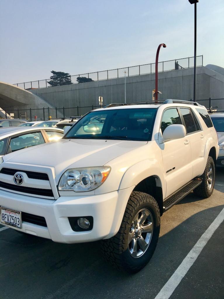

Bilsteins 5100 all around + OME 884(F) with Icon 52700(R) + Stock UCA.
OEM rims w 275/65/18 Falkens

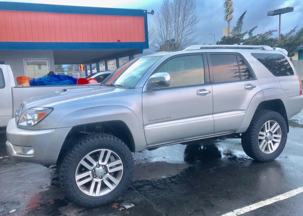

Before and after pics of the OME lift. Exact setup as follows.
OME Setup
Front Shocks
1 x OME-90021-P Old Man Emu Nitrocharger Sport Front Shocks - Softer Valving
Trim Packer
1 x 95PF5 - OME Trim Packer
Front Coils
1 x OME-885 - Old Man Emu Front Coils
Front top plate spacers
1 x TOP1-T-A - Front Top Plate Spacer Kit - Aluminum Finish
Assembly with new top mounts and bushings/washers
1 x TMP-05 - Top Mount Kit (includes assembly)
Front diff drop kit
1 x RM83011 / TAC-DR-05 - Toytec Front Differential Drop Kit
Rear Coils
1 x OME-896 - Old Man Emu Rear Springs
Rear Shocks
1 x OME-60004-P - Old Man Emu Nitrocharger Sport Rear Shocks
Upper Control Arms
1 x 25480 - Specialty Products Company Upper Control Arm
Wheels: 2018 4Runner Trail Edition
Tires: 275/70R17 BFG KO2's
Suspension: Stock Non-XREAS (Before)
I tried to get the pics from the same angles to provide a close comparison.
BEFORE
AFTER
BEFORE
AFTER
BEFORE
AFTER
Overall for the money this setup is excellent and would recommend it to anyone however, long term impressions are yet to be seen. I couldn't justify going beyond this kit cost wise as my 4th Gen is only used for weekend trips out into the desert and camping.
I am interested to see how it rides once I am able to put on the CBI front and rear offroad bumpers with tire carrier. I purchased the HD springs (Front 885 & Rear 896) with the intentions of building out the rig and putting a rooftop tent on as well. Toytec does advise "Med and Heavy coils are rated to handle additional weight from aftermarket bumpers, winches, and accessories and should NOT be used without stated weight already in or installed at all times. All lift figures are based on averages." which I currently do not meet however the ride is fine, at most a bit bumpy in the rear with no additional load yet and the spare currently removed.
I imagine once I find the time to throw on my complete RCI skid set and sliders this is help as the total weight added will be roughly 285 lbs. (No I don't care about weight)
Any questions feel free to ask and I am more than happy to answer them.

You noted the front diff drop but was there a rear one, too?
How much lift did you get?
There is no rear diff drop. Just for the front. The increase in the lift overall was 3.75 - 4".
The OME gives about 3" by itself and the tire setup another 1". Overall I'm very happy with the results. Enough ground clearance for what I need and looks great. It's been installed for about 3 weeks now and I've put 500~ miles on it, so its had some time to settle.
I think it might settle a bit more over the summer when it gets scorching down here and when I also add all the extra weight I intend to do in upgrades.
