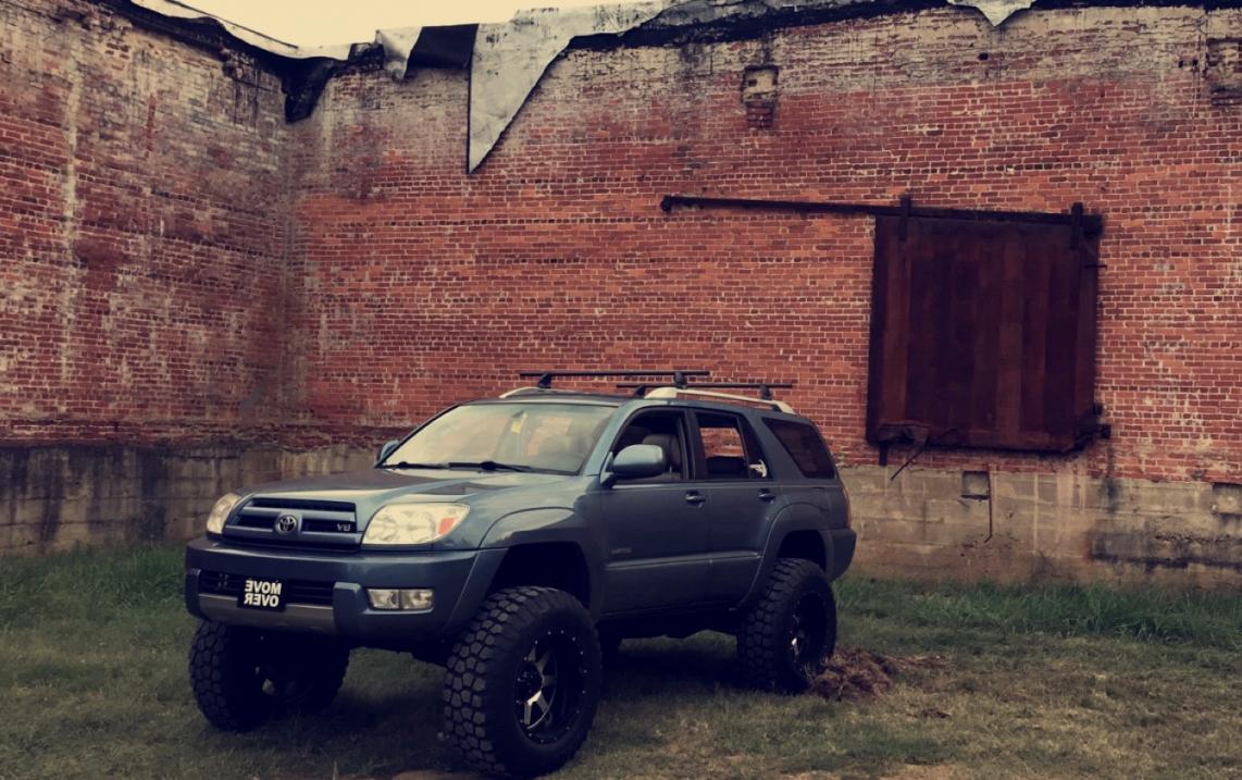

+3 front, +2.5 rear. 285/75/17
Those look sharp! The Tuff wheels were one of my top 3, or 4 choices when I was wheel shopping before ultimately choosing the Fuel wheels I have. I like that you can change up the look on the Tuff wheels just by changing out those bolt on chrome pieces to a color if you want. I had considered doing the red accents since my truck is black just to give it a pop of color and tie in my red powder coated calipers.
Thanks, Im squeezing them tight. I had to chop a lot of body mount and plastic. The rear needs trimming now.

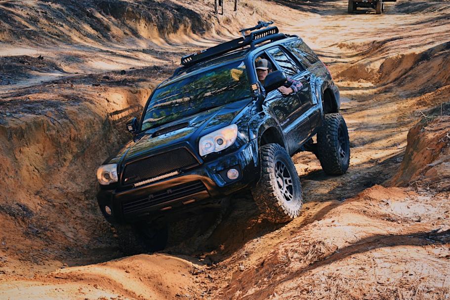

Here's my '08 Urban Runner (xreas disconnected).
OME 884 front coils
Bilstein 1" rear coils (part# 36-281817)
Bilstein 5100 all around, set at 0
Falken Wildpeak at3w 265/75R16
Pro Comp 2069 wheels
05 V8 2wd SR5
Rides and handles amazing. Stock control arms, no wandering. Don't carry heavy loads, so I chose coils with near stock spring rates.

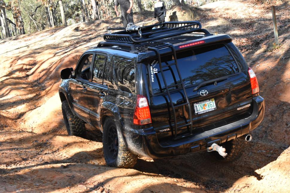

Front: OME 884 Springs with Bilstein 5100, Camburg UCAs
Rear: Icon Overland Springs with Bilstein 5100 shocks
Wheels: Icon Satin Black Rebounds 17x8.5 (0 offset)
Tires: Falken Wildpeak AT3W 285/70 17
