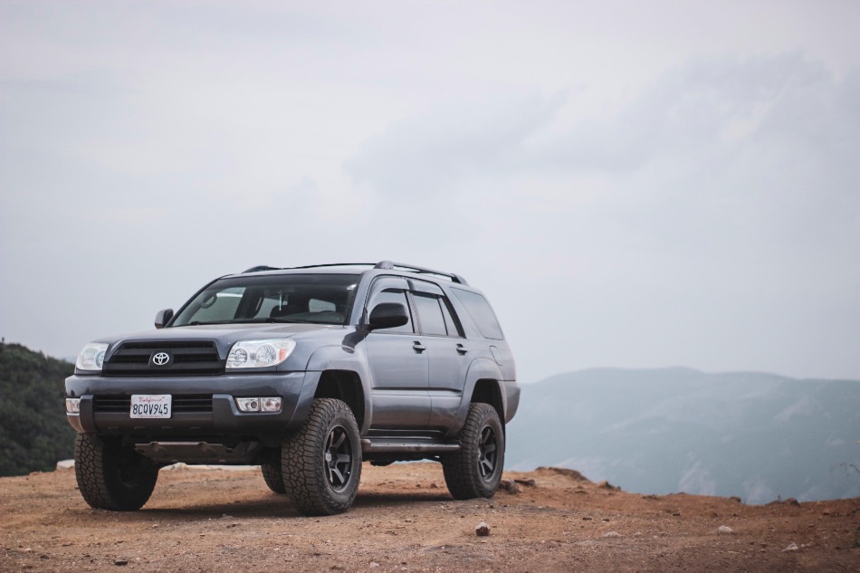

Hey guys been lurking for a while and wanted to show off my runner.
King 2.5's front and rear, TC UCA's and a 2" ICON spring in the rear. 17" Method's wrapped in 285/70/17's This is my first 4x4 "build" so I would love to hear what you guys think/ tips on how to get more performance.:peace:

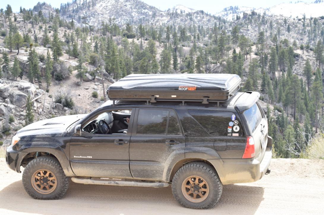

Whats going on everyone! Finished up my setup and took her out to the trail today for a little shackdown
2019 tacoma trd offroad shocks with 2inch spacers in the front and daystar 1.5 in the rear. Still have stock shocks in the rear but Bilstein 5100 are on the way :thumb3:

How much are you rubbing with those 34's? Are you rubbing a ton when you're wheeling? Did you re-gear? I love the setup man.
I had to do some trimming and BMC but no rubbing at full flex. I didn’t feel the difference going from 32s to 34s with the V8.
I have headers and y pipe going on soon that will help gain back any power lost.
Thanks man! Surprisingly, it's not disconnected. The only rear upgrades I have are the Toytec Boss Shocks, Dobinson Springs, & Toytec Aluminum Bump Stop Blocks. Thoroughly impressed with the articulation from an inexpensive upgrade.
which dobinsons are you running in the back? Obviously the off road performance is good, how do you feel about the on road ride?
I don't recall the exact number but they are the 3" medium duty springs. Ever since I added the Wilco, full-size spare, hi-lift, gas tank, and water tank in the rear I've noticed a bit of sag in the back. With all the extra weight, I will be upgrading to heavier rear springs. Having said that, they're great!
Hope this helps.
Are you at a solid 3" lift? I still rub with 33's when I stuff but i'm only running a 2" spring in the rear and then leveled in the front. It doesn't rub bad enough to do anything about it but it would be unacceptable if my tire was any bigger. what springs are you running?
I'm running the Dobinson C59-677V which gave me 3" lift in the rear.
The tire will still travel the same path with a 2" spring as a 3" spring if you are truly fully compressed. There should be no rubbing differences between the two springs.
