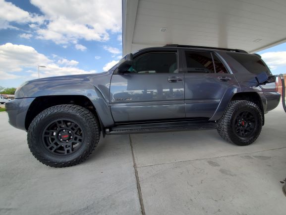

Daystar 1" Leveling Kit, TRD Pro wheels, Falken Wildpeaks 265/70/17
The tire will still travel the same path with a 2" spring as a 3" spring if you are truly fully compressed. There should be no rubbing differences between the two springs.
So adding another inch of spring will just make it more difficult to achieve full compression right? Can you explain this further?
I guess it would depend on the spring rate, but even if a spring gives more lift it could still have the same spring rate as a shorter lift spring.
The simplest explanation is that they just change static ride height. The travel of the tire is only limited by the shock's extended length (or suspension joint binding) at full extension and the rubber bump stop on the frame for full compression.
