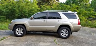

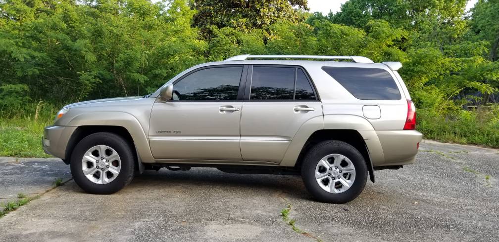

Your runner looks great man! Im planning on getting this stage 2 icon kit installed and hopefully grab the same wheels. If im planning to run 285/70/17, do you think ill have to BMC?
Would you be able to snag a pic from the front? id like to see the stance with these wheels.

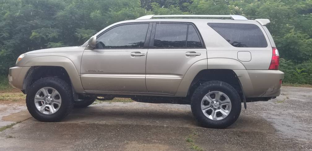

Switched my wheels from VTX Rogue to SCS Ray10 17x8.5 -10mm

With 285/70/17 you're probably going to need a BMC still. I'm currently out of town but I don't mind getting some pictures for you.
Looks like you're in Houston also!
My first set of wheels were 17x8.5 -6 with 285/70/17 Nitto Trail Grapplers and I rubbed hard on the body mount at full lock and when backing up. You will need a BMC.

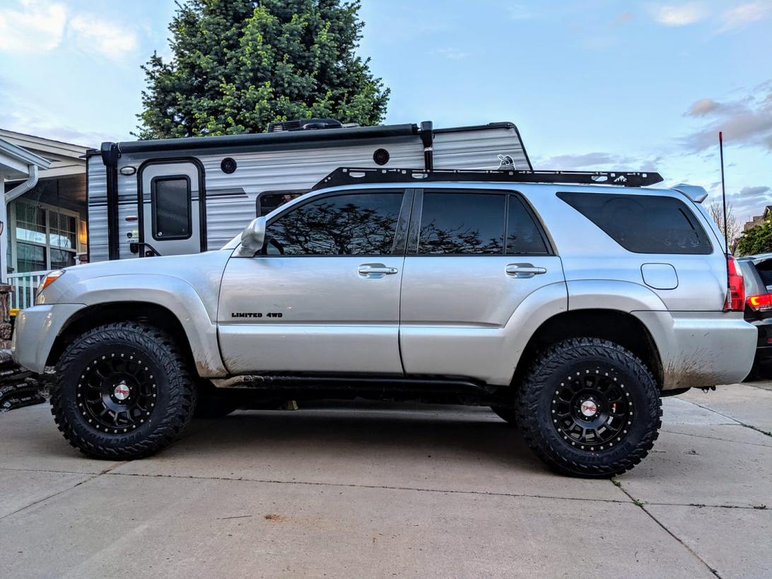

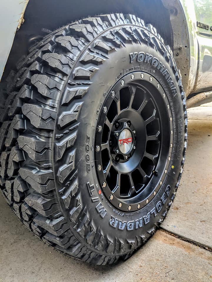

3" Toytec lift, Camburg UCA, Yokohama Geo G003 MT 285/70/17 with Pro Comp Rockwell 17x8.5 wheels with modified TRD caps.
Just bought a set of these wheels myself last night when SCS released their new inventory. Looks like we'll be twins soon - I went dark bronze and am putting them on my black 2005 SR5.
Bilstein 5100s on highest setting with rear coil spacer, FJ Trail Team Coils, SCS Ray10 17x8.5 -10, Yokohama Geolander G003 285/70 r17
Minor rubbing that was fixed by pushing fender liners forward and very minor trimming

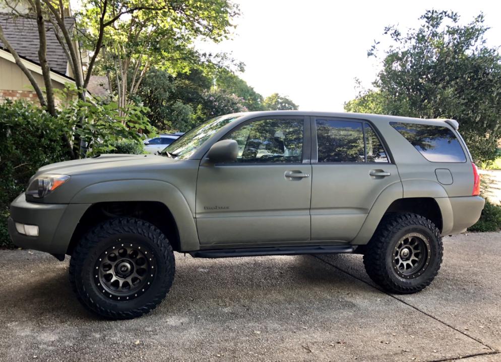

Wheels:
* LT255/80R17 Toyo Open Country AT2
* Spidertrax
Front:
* Bilstein 6112
* 1.5" Cornfed Spacer
* JBA UCAs
* New OEM LCAs
* 5th gen rotors & calipers
Rear:
* Bilstein 5160
* Dobinson C59-505
* Rear driver side spacer
Tell us more about that paint job!
