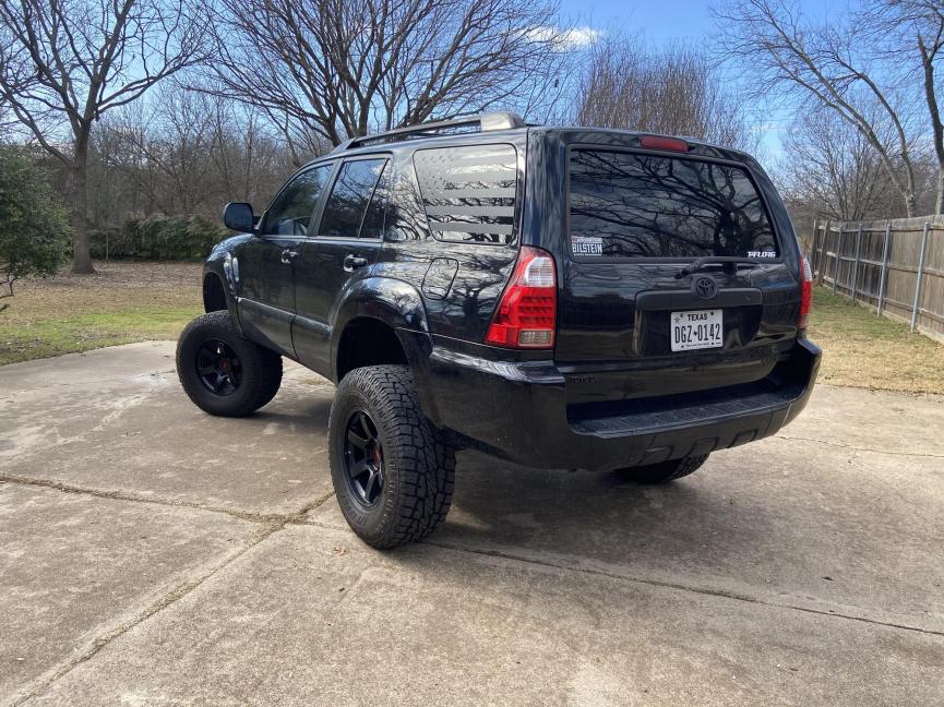

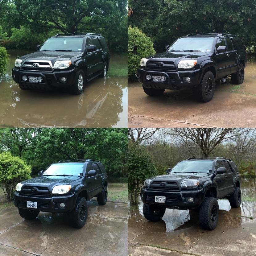

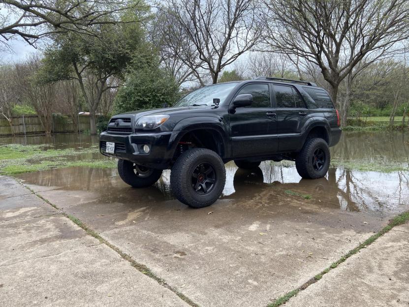

TL: stock
TR: daystar 2.5 front only, MB 352 +18 offset 285/70/17
BL: Bilstein 5100, front OME 885, JBA uca, rear Toytec Superflex, 1.25" spidertrax
BR: added +4in lift spindle and 1.5in rear spacer/ Level 8 mk6 -12 offset and 1.25" spidertrax
