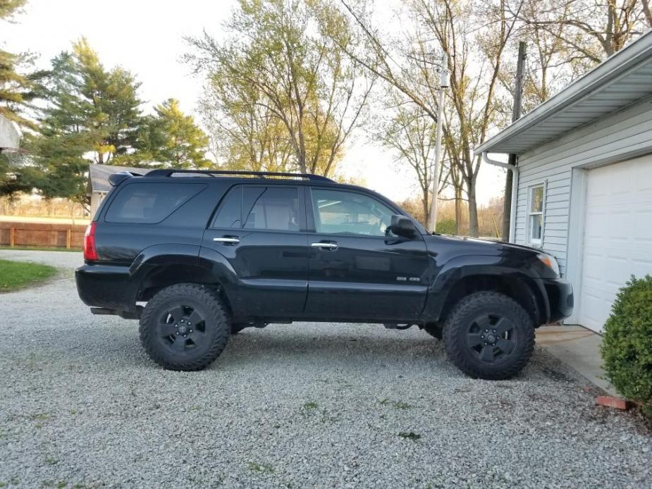

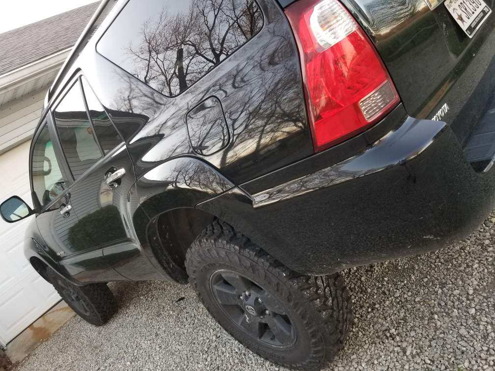

Just mounted some 285/70r17 P rating Falken Wildpeak. I like them so far. Also noticed that I'm getting CV binding with my 3in spacer lift (that has been on the car for a longggg time) so I picked up a used set of front 5100s and dobinson 314 coils that will be mounted eventually and drop the front end down 1/2 inch. Hoping I still fit these tires! Just had to remove mud flaps and trim behind them a little bit so far.

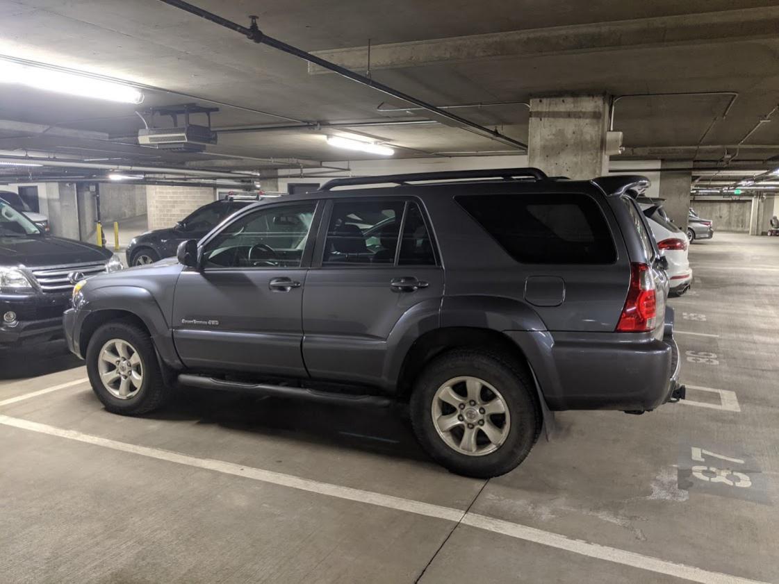

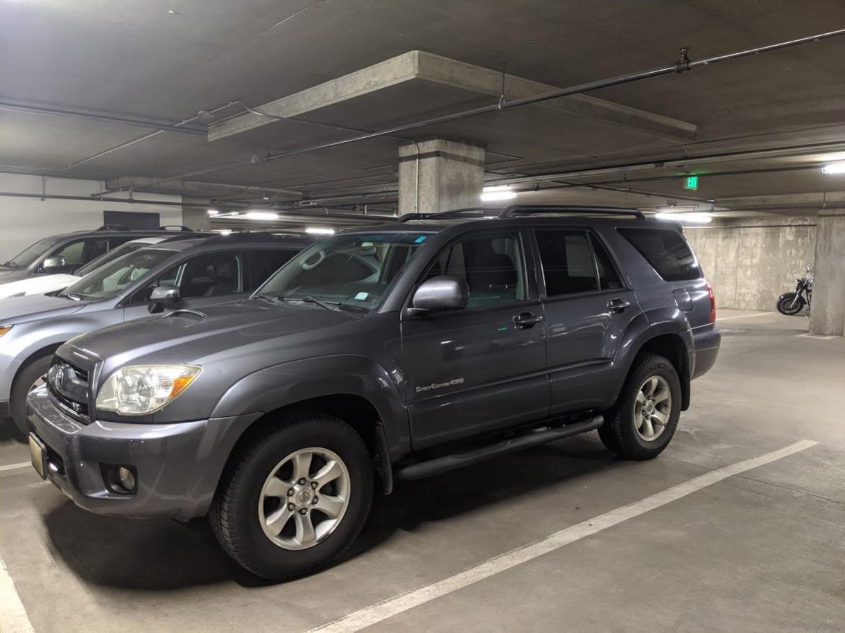

Before:

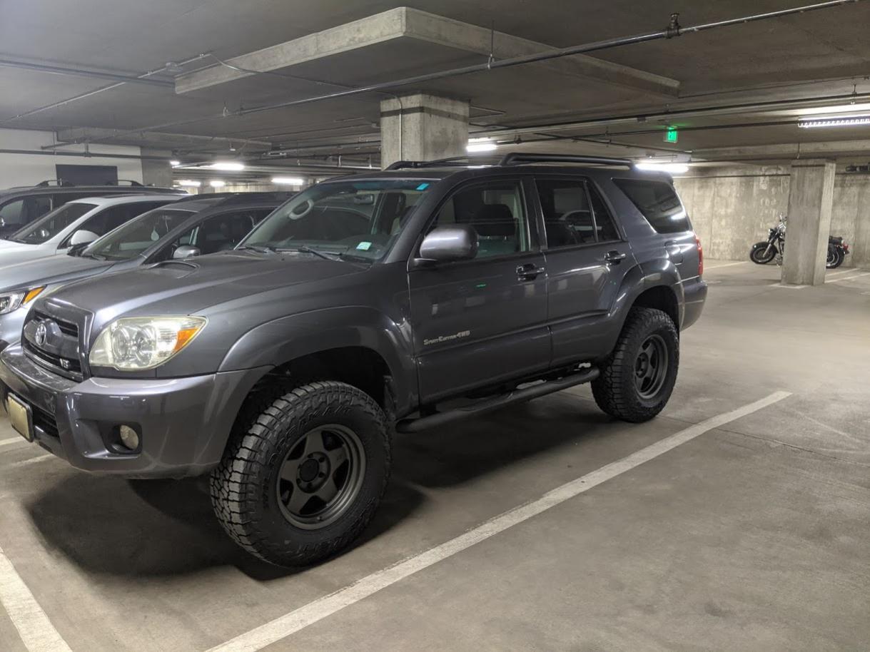

After:
:frisky:
