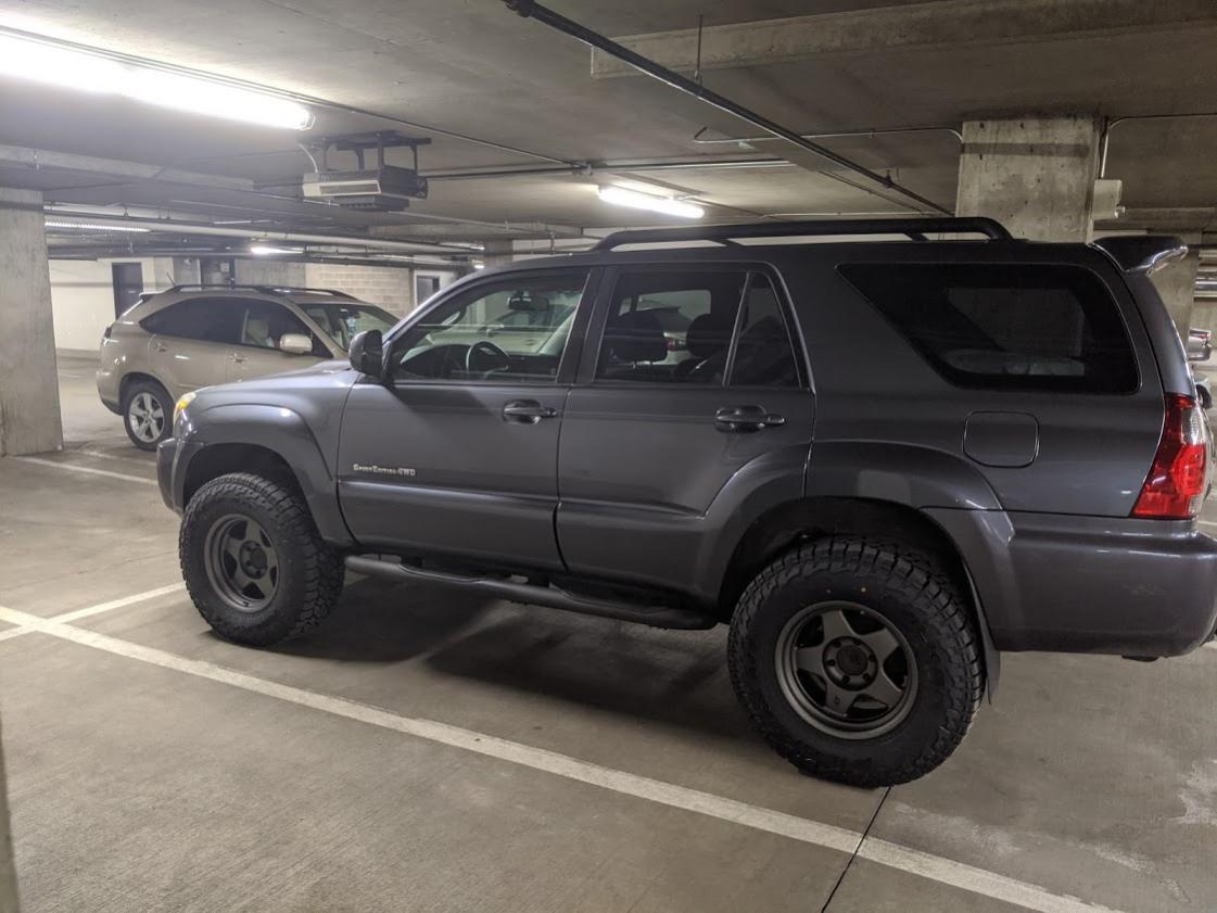

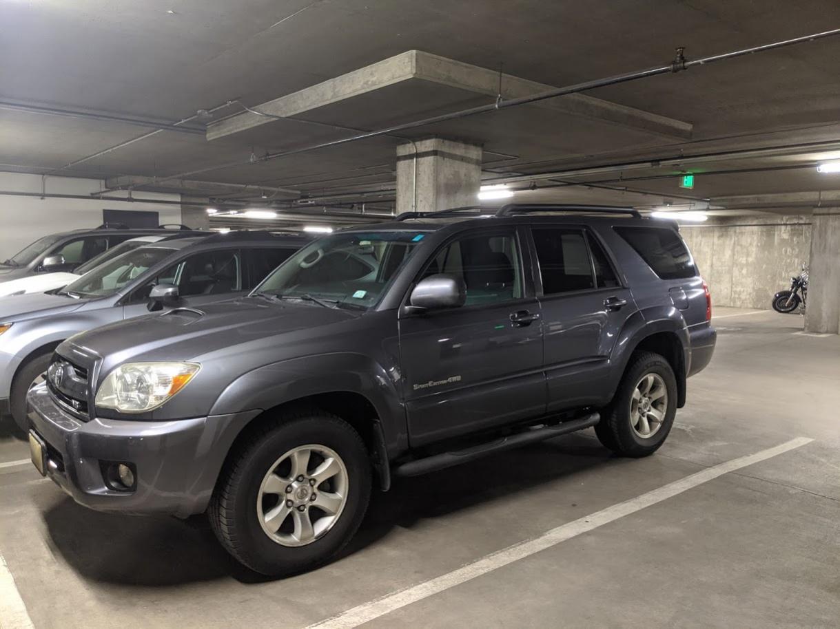

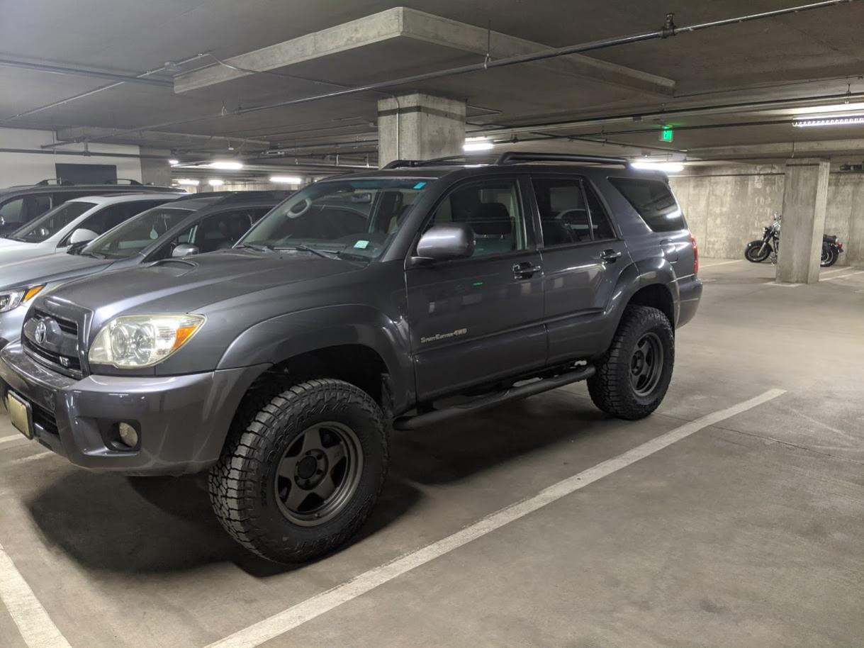

Had the lift for 2 years (maybe i dont remember)
Dobinsons 3"
17" FJ/T4R 8 Holes +15mm Offset
285/70/17 Kenda Klever RT
Love the way it rides now with the bigger/heavier tires.
First Picture is after the lift with original tires and wheels (265/70/17 G2s)

How do you like the Klevers? I've been eyeing those for a while. Very affordable. Any issues on highway? And I assume you are running wheel spacers to get that stance?

somewhat recently i saw someone raving about those Kenda MTs...liked more than big name brands

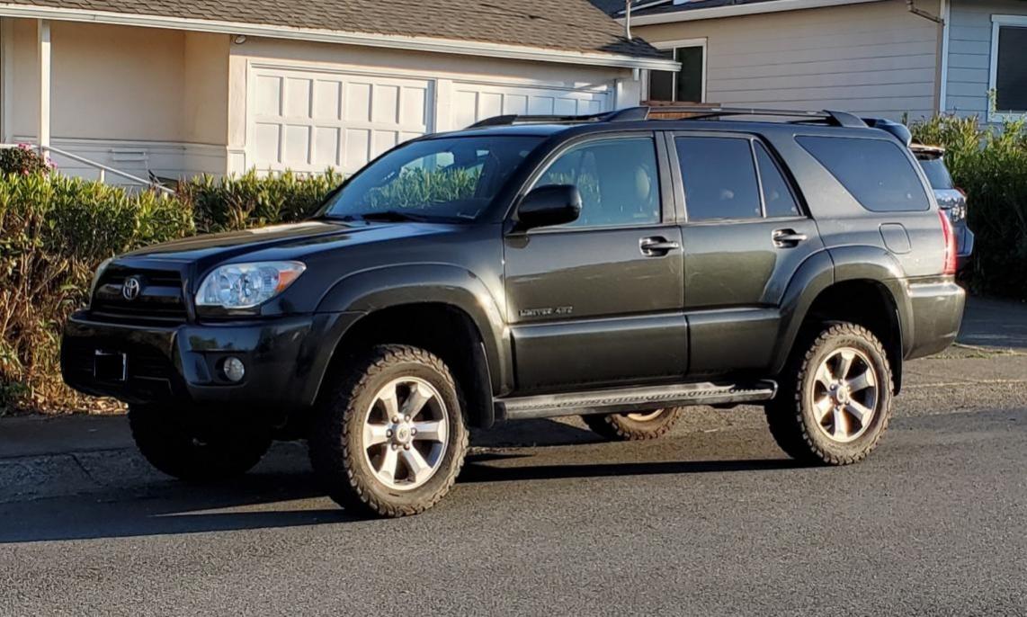

Ironman 4x4 Foam Cell Pro with SPC Uppers and 285/70/17 Falkens on SCS F5's 17x8.5 w/-10 offset.

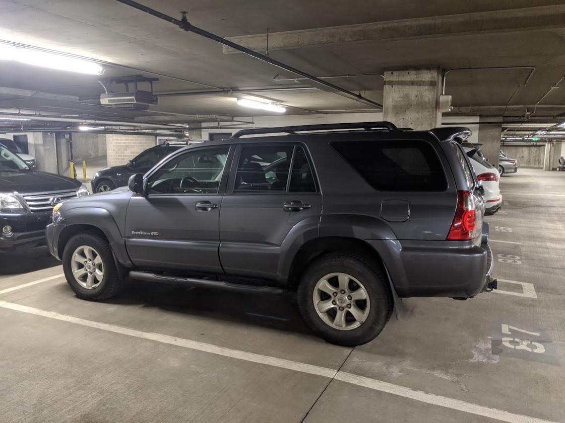

Here is a crappy pic with stock wheels, I will post some better ones but perhaps I'll wait until I get the wheels and tires.
