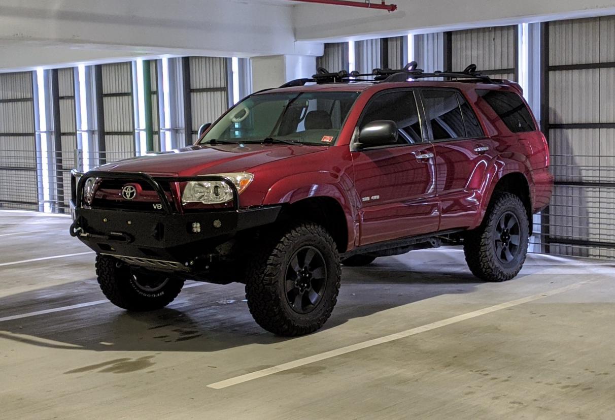

Replaced my old setup i've had for 100k miles: 5100s set at 0.85 with FJ coils and FJ wheels
New setup: Dobinsons front C300 GS 221 rear C599 GS705
Konig Countersteer

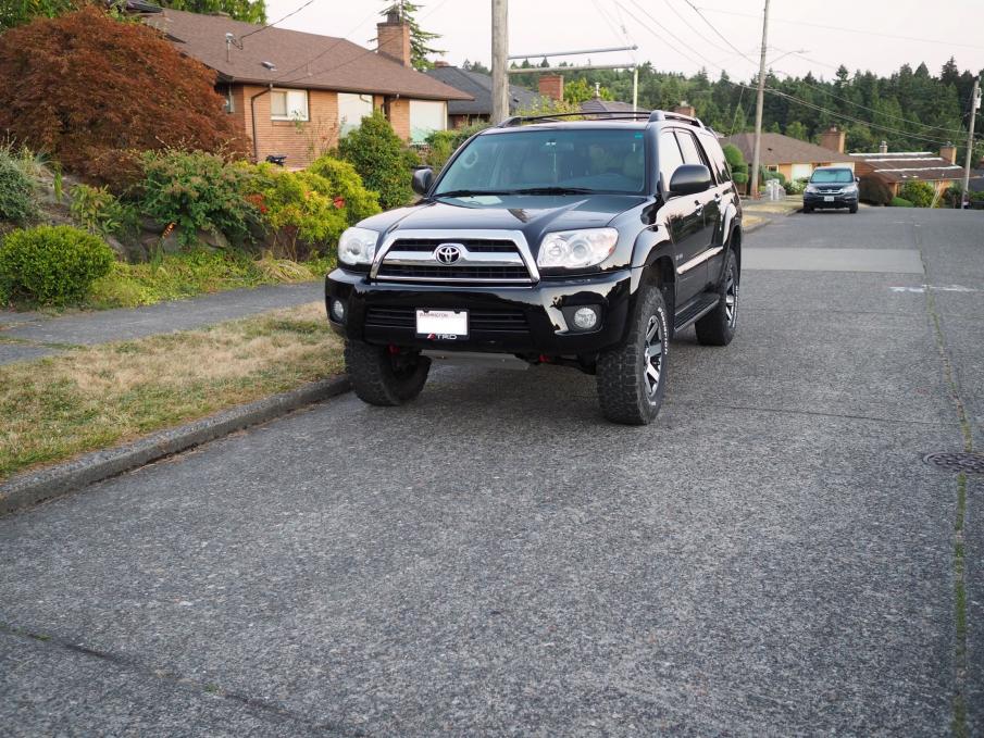

Man I can’t get over how similar the back ground is. It’s like that game “What’s different” :
Potted plant has flowers. Second story window is open. Truck parked in the alley. FUN
And nice 4Runner. I went with Dobinsons recently too and very happy.

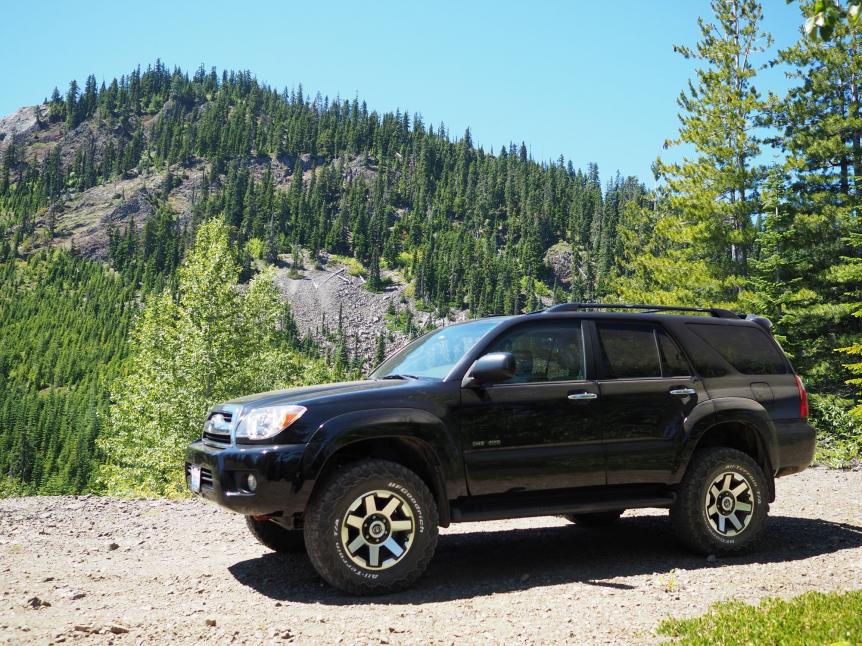

Lifted
OME 885/895 (nitrochargers all around) with 275/70r17 BFG K02s. Wheels are off a 2020 4Runner TRD. Loving it so far.

Still having a tough time deciding between ome 884s or the eibach pro truck coils. I don't have any extra weight up front and don't plan on adding any - I do a fair amount of offloading and am worried the ome 884s will settle more than the eibachs would. I know the ome gives a smoother ride than eibachs but just want to know which would be best for the long term. I also am seeing lots of conflicting info about the amount of lift gained from the 884s. Really am trying to stay around 2.5" of lift.
That's a nice truck! Looks to be about the same as mine. I have an 07 sr5 4wd v6. How much lift did you gain with the 885s? How long have you been running this set up? Any settling?
Right about 3" of lift. Had the setup for a few weeks, no settling yet but I am expecting .5" or so over the first couple months.
Do you have any extra weight in the front? Or a v8? Most of what I've read says the 885s will give over a 3 inch lift with the v6. I'm trying to stay closer to 2.5 would the 884s be a better option for me?
FYI, I got 2.25" with 883s on my v8. After about 5 months, still the same.
Measured again and it is a bit over 3", probably closer to 3.5, but my factory suspension was kind of saggy. I have a little bit of extra weight from heavier skids and a compressor (maybe 50lbs). If you aren't planning to do new UCAs, then 885s might be too much and you probably will have alignment issues. I added t120 nitro UCAs so I didn't have to worry about that. I also wanted to mostly level the truck, and so paired with then 895s, the 885s do that. 884s are the same spring rate, just a bit shorter.
In any event, I expect it to settle some over time.
