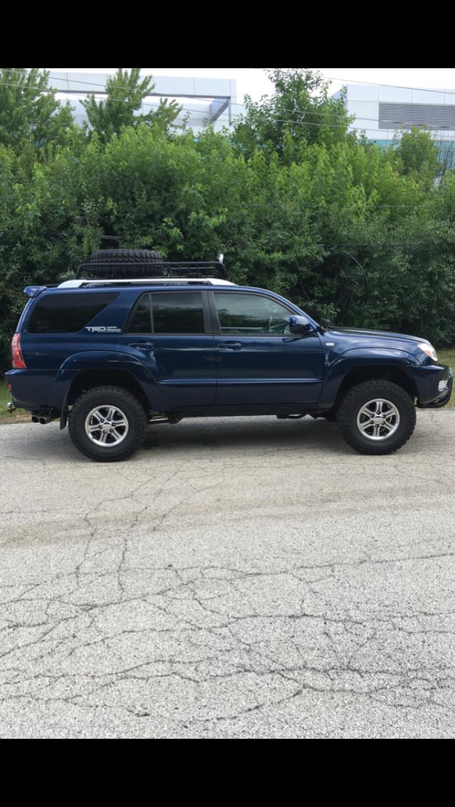

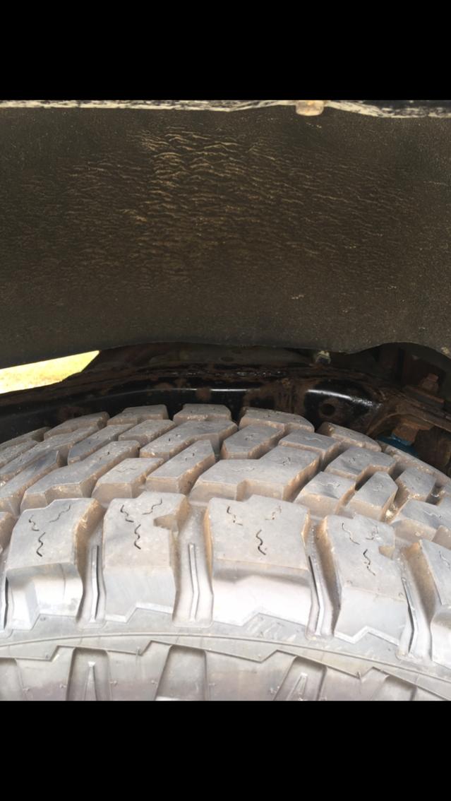

My 2004 Limited with Daystar 2.5”/1.5” spacers and the Toytec 1” body lift kit. Pic in the rear wheel well shows the gap between the chassis and the body after the body lift.
16” port/dealer installed rims (bought used) and 265/75r16 Dick Cepek tires, ~31.9” diameter. Originally had 17” rims. “Winter” tires 255/80r17 Toyo AT2 tires on 5th gen 7 spoke rims, ~33.1” diameter. Running boards removed.

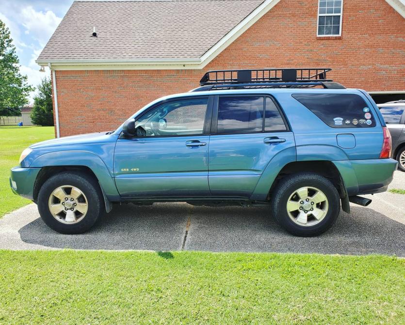

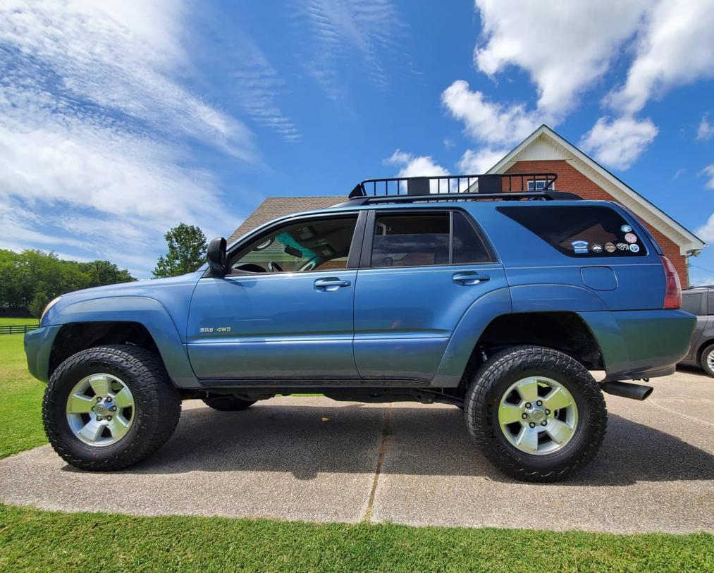

I've been lurking on this site for about a year now, ever since I got a 2004 sr5. I would never have tried to do the whole lift myself if it had not been for the threads on here, but a couple weeks back me, my dad, and my son spent a loooong Saturday putting putting Bilstein 5100's, FJ springs, a Daystar rear lift, and some Falken 285's on this guy and I'm loving it. The only issue we had was replacing the front driver side UCA. The previous bolt was STUCK and it took a saw and a gear puller to finally pop that thing out. Thanks to everyone! I have spent HOURS reading through this site.

Good on you for learning to do it yourself. Saved about 1k depending on labor in your area. Tires look good! I have the same ones and love them.

Wow clean set up! I think I’m going to keep my stock 17’s (same as yours) and do the lift/tires on my galactic gray mica. You inspired me to stay with the OEM look bc I cannot find a aftermarket wheel that I like or will look good in a year or 2.
