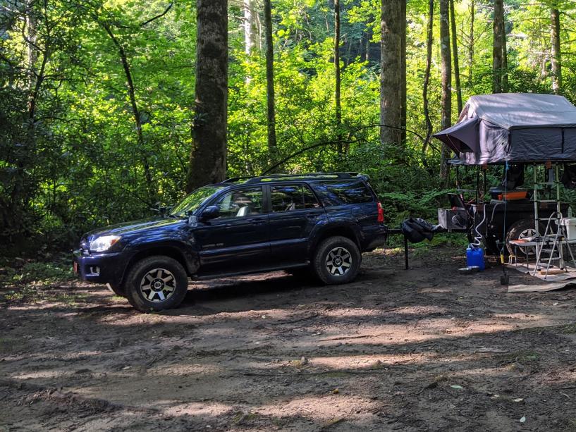

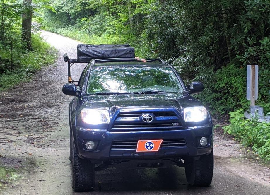

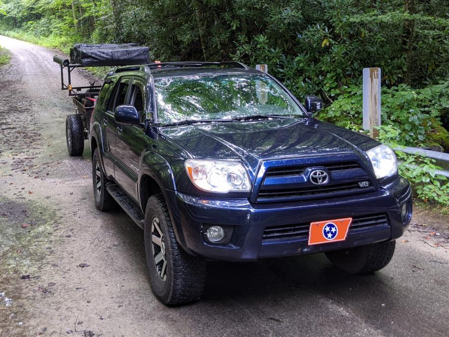

Wow clean set up! I think I’m going to keep my stock 17’s (same as yours) and do the lift/tires on my galactic gray mica. You inspired me to stay with the OEM look bc I cannot find a aftermarket wheel that I like or will look good in a year or 2.
IMHO, the 5th gen 17x7.5 inch 7 spoke wheels with the black background look great on 4th gens. I bought mine as new takeoffs from a wheel store on eBay for only ~$110 each. If your 4R is Galactic gray, you may prefer the 7 spoke wheels with the gray (gun metal?) background. My 4R is Stratosphere Mica, so I went with the black background.
I also have a set of the 17x7 inch 6 spoke 5th gen rims, but they don’t look as good as the 7 spoke wheels. They look very stock to me, nothing fancy. I think it’s because they are all one color, like the stock 4th gen 5 spoke wheels.
My 7 spoke wheels also have 33” (255/80r17) Toyo AT2 tires on them, and the 6 spoke wheels have 32” (255/75r17) Yokohama G015 tires on them.
One of my kids told me the 4th and 5th gens look very similar to him, so maybe that’s why the 5th gen rims look like they belong on a 4th gen.
I went with the original wheels mainly because I'd already spent so much I couldn't justify new wheels too, but I agree. I ended up liking the look!

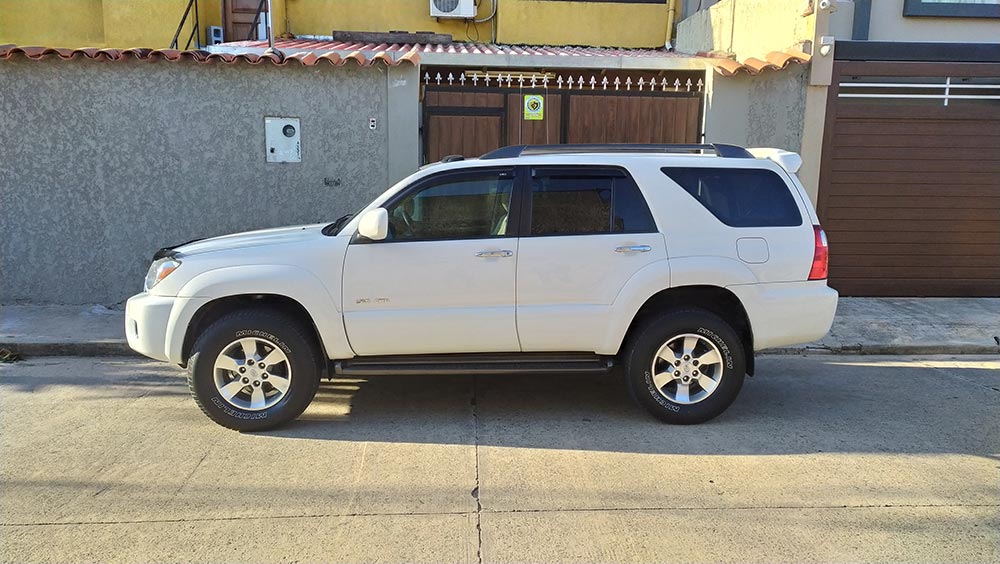

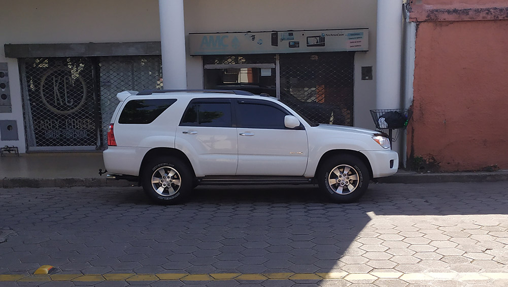

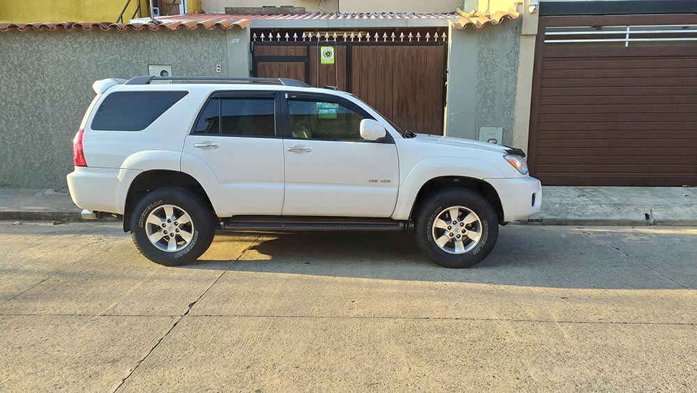

Spacers Lift for my 09' SR5
Now I can post on this thread! :naughty:
A 'custom' lift, 2 inches front, and 1.5 inches rear.
We can't find proper lift kits where I live (only Old Man Emu, but it's out of my reach right now).
With the tank full of gas (as in the pictures below) right side is about 0.4~0.5 inches taller.
First pic is stock (the day I bought it).
Overall I'm pretty happy with the results, I think it looks way better with the lift :bravo:
