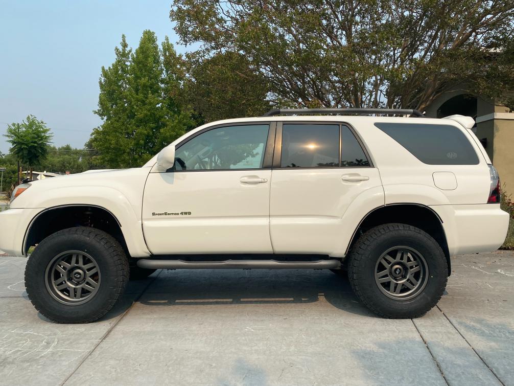

I joined this forum in 2008 after buying my Sport off the lot (first new car in my family). Planned on upgrading it at the time - started humbly w/ Weathertech mats. Then life happened, as it does.
Fast forward to 2020 - I've got a meager 99k miles on the old gal, and X-REAS is shot, and tires need replacing. Perfect time to begin what I'd "started" in
08.
Toytec 3" Ultimate, Chaos UCAs, Stainless brake line extension, SCS Stealth 6 Gunmetal 17s, Toyo A/T III 285/70/R17 blacks (lurked long enough to call them 33s). I'm in love.
Dang she looks good!

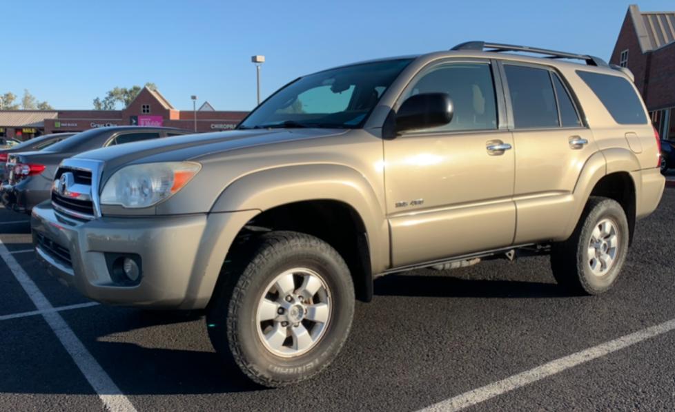

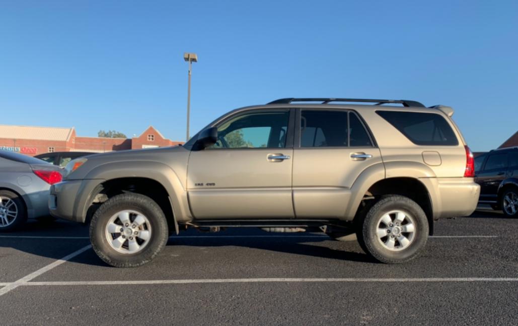

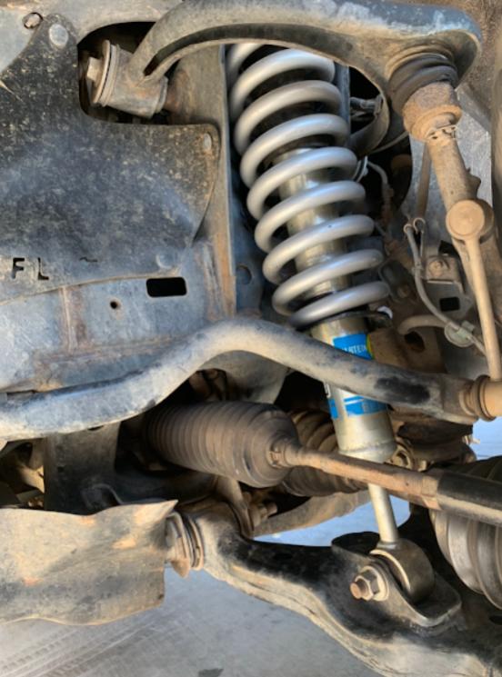

I posted a while back asking whether to get the OME 884 front coil springs or the Eibach 112-620p's (paired with bilstein 5100's). I ended up going with the Eibachs and love the way it turned out. Set the billies back down to the 0" position and threw the eibachs on and received exactly 2.5 inches of lift in the front (also added 1/4" top plate spacer to drivers side) and rides much better than it did when I was preloading the factory springs with billies set at 2.5". If anyone is interested in pics I can post them later.

Sorry for the delayed response. Here are the pics I took. Plan on getting larger tires very soon to fill the wheel well a little more. And like I said before I have retained a little forward rake by a little less than an inch. I plan on replacing the rear springs in the future as well, I currently have the FJ springs with 1.5 daystar spacers in the rear.

Awesome looks great, those springs seem to go nicely with the 5100's. I might end up goin with the eibach's. Might go with heavy springs in the back because I plan on having a couple hundred pounds of weight back there with a sub and and hopefully bumper
