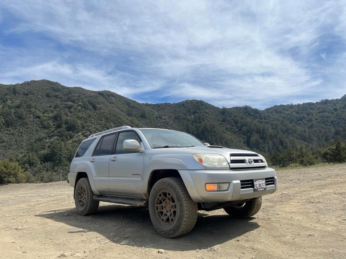

2004 Sport V8 2WD
Bilstein 5100 @2.5" front; stock springs all around
17x8 AGP Pro Bronze
265/70/17 Falken Wildpeak A/T

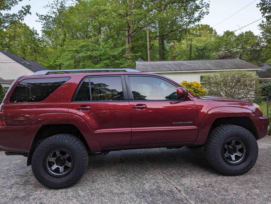

Finally....
OME 885/895, Fuel Block D752 wheels, Falken WildPeak AT3W 285/75/R17. OME UCA's, new LCA's, new tie rods and axles.
Just picked it up from the shop today. I will have to do a bit more trimming, but it rides great.
(Hope the attachment works)....

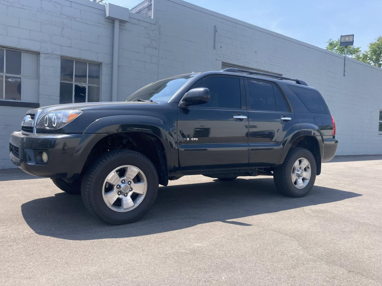

'07 V6. OME 884/896 with their shocks. Drawer system in the rear was making the 895's sag. JBA UCA's. OEM wheels with 265/70/r17 KO2's. New OEM LCA's. Front fender push. Mud flaps removed.

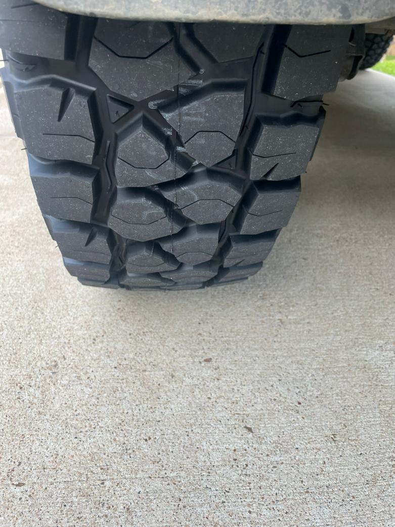

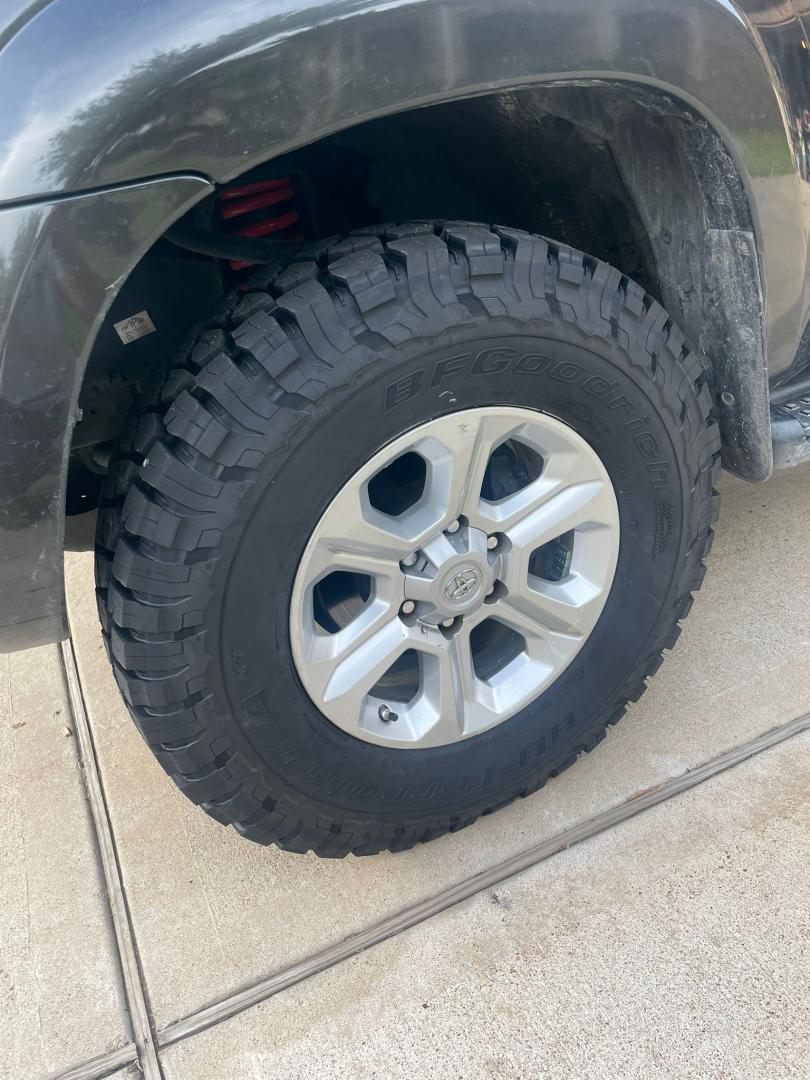

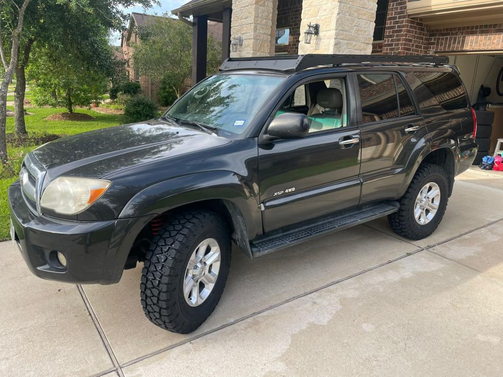

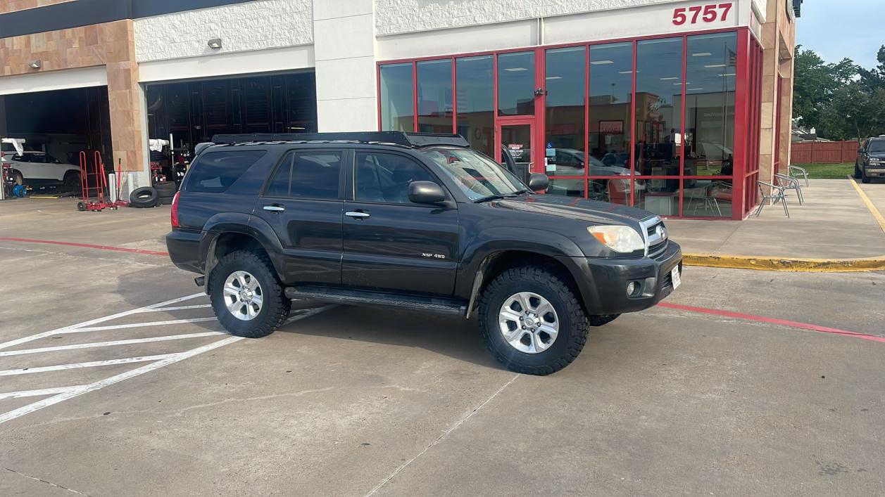

4th Gen 4runner with 255/80R17 BFgoodrich HD Terrain KT
Just added new BFGoodrich HD Terrain KT on 255/80r17. Got about 2 inch lift in front and 2.5 rear with Dobinson coil overs and Bilstein's 5100 at 0 level. Original upper control arms and only rubbing front mud flaps when turning at full lock. Need to test with flex if something else rubs. I got the gen 5th snow flake wheels( 17x7 with 15 mm offset) no wheel spacers.

Finally....
Gorgeous. So that’s lifted in front and back?
Super interested in this. Any more pictures and/or thoughts? I'm looking at going to a 32" 255 tire. How does it look/drive without spacers? I would want to add spacers so long as it doesn't cause rubbing. Thanks
