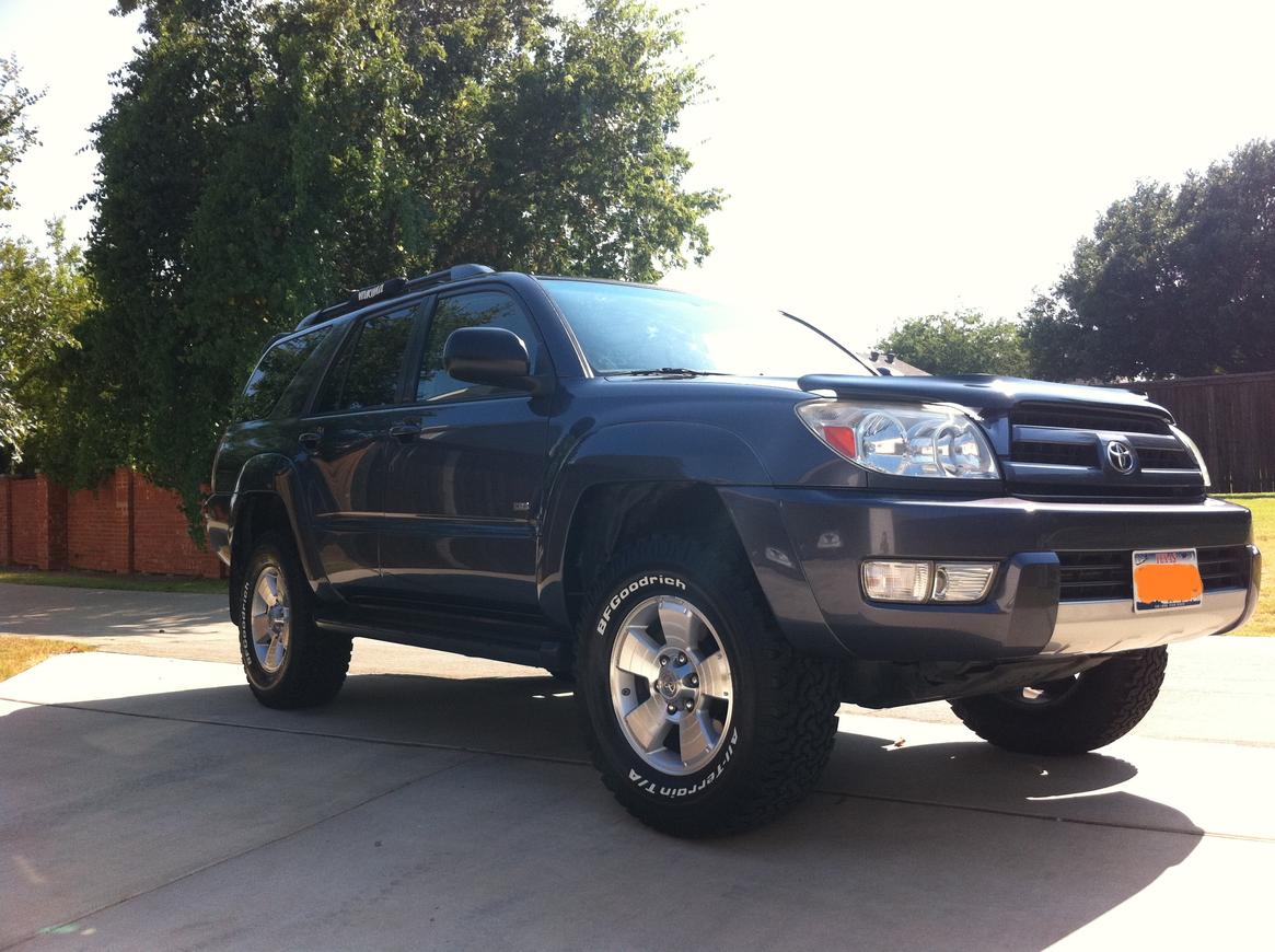

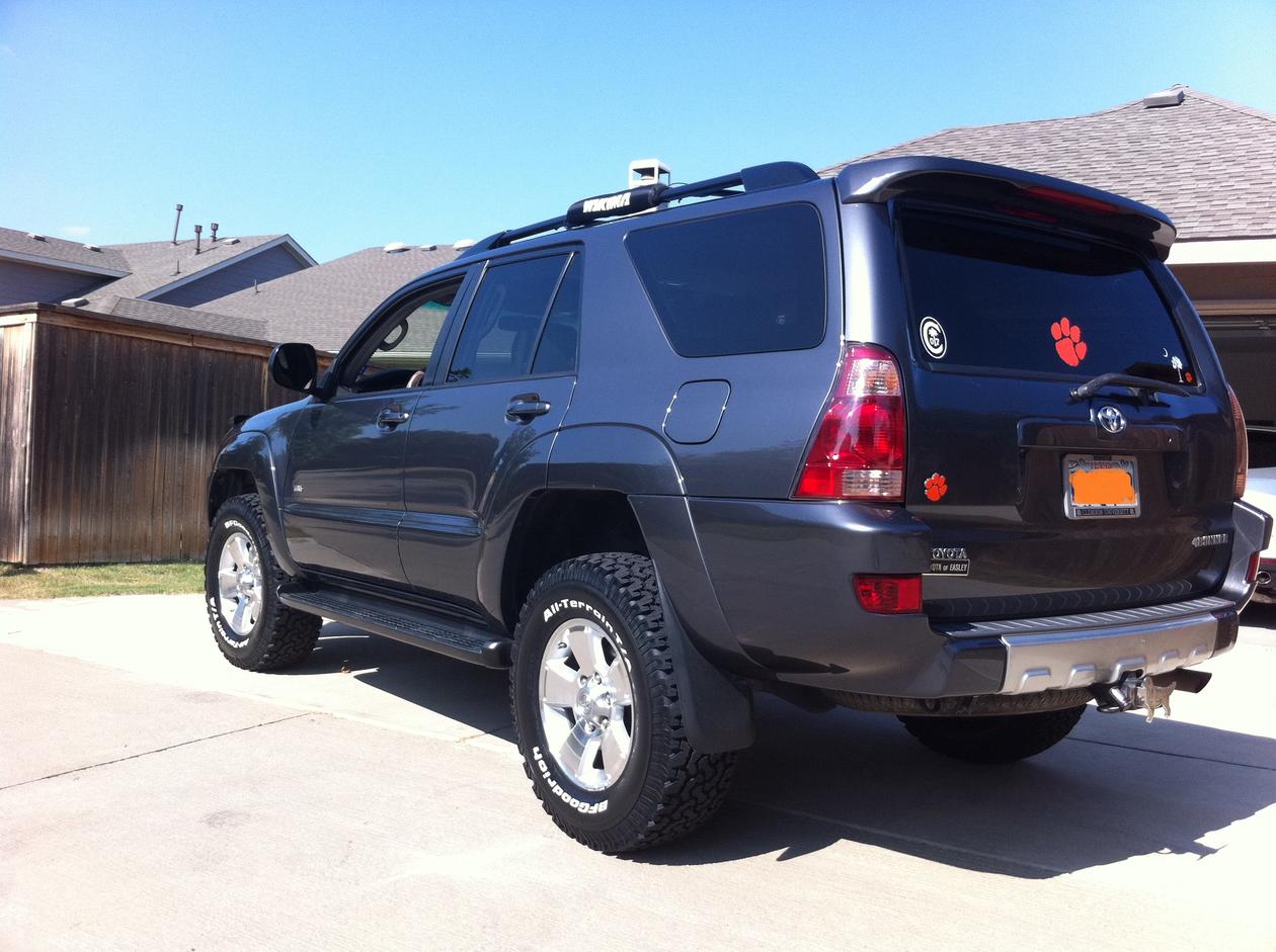

Sweet looking truck!! I'm am about to do the same lift and tires on mine. Big Plus on the white letters out. You just need to slap some spidertrax on it and you're set. They made a huge diff on mine.
Thanks man...acutally just ordered the spidertrax this morning...can't wait to throw em on!
Very nice looking! Looking forward to pics with spacers. BTW, have you monitored gas mileage with your new BFG'S?
Thanks. I'm putting the spacers on Friday so I'll post up a pic. Just got them in.
As far as has mileage goes I'm at about 19-20 hwy. Not too bad...so far.
Beanz...also, how are your Off Road Lights attached? Are the mounted on the bumper or grill?
BTW, I really like the look of your Truck. (I would keep the white lettering.)
