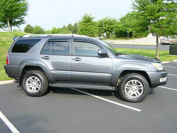

Okay..I know this topic has been beat to death. But I'm looking for some advice/opinions for people who have had their lifts/leveling kits now for a few years.
My '03 Sport V8 just turned 57K miles and it's time for some new rubber. First of all, I have the Sequoia wheels - 17 x 7.5 (which have a diff offset than the stock wheels).
1) I'm thinking about powder-coating the wheels black (or maybe buying an extra set and doing it since its kinda hard having it without wheels for a week). Any opinions on a Galactic Grey with p.c. wheels? Or should I stick to the stock anthracite color.?
2) I want to put bigger tires- Nitto Terra Grapplers --preferably 285's. This truck will see no off-roading at all .........just for looks. I would assume with the "better" offset, I will still need some trimming. Since it has the XREAS, is there a preference of Brand now since you guys have had the leveling kits/spacers for a bit. Do you regret going the cheaper route with just spacers? And will I need Spidertracks spacers also??
3) I also considered getting the TRD 18x9 wheels instead -- but correct me if I'm wrong......it appears a 285/60/18 Nitto on the 18x9 wheel is actually SMALLER than a 285/70/17 Nitto on the 17" wheel.
The attached pics are of my stock wheels and the TRDs.
Like I said, I have gone through ALL the threads about this.....but now I'm looking for everyones input since you can evaluate the pros and cons of what you did. It looks like most people have had the kits for a few years now. Thanks.......

If that's the size tire you want, then you'll probably want a 2/1 leveling kit. I don't think you'll need wheel spacers considering that your Sequoia wheels have a slightly wider offset than the stock wheels.
I have 17" FJ wheels on mine (same offset as your wheels) and just a 1" front leveling lift with the stock size tires. But I decided early on that I wanted to keep the stock size tires but just a more aggressive tire. So that's why I only went with the 1" leveling lift. If I wanted bigger tires, I would have gone withe the 2/1 spacer lift instead.
It's not quite the same but HOJeepsters rig looks pretty to me. http://www.toyota-4runner.org/4th-gen-t4rs/54309-06-sport-daystar-lift.html On the other hand unless you paint your roof rack I say leave the wheels as are; I think they look great.
I would think a 2/1, 2.5/15 Daystar or the IronCladLou 2/2 would be great for continued XREAS use. Look through the Lift and Tires thread at the top of 4th gen, you'll see pics of all of them. I really like the look of Lou's ride.
I love those Sequoia rims:D The 18's are nice too but I love the Sequoia rims. 285/60/18 is shorter than the 285/70/17. If you want comparable look at the 285/65/18 size.
A few guys have had great luck with the 275/70/17 or 275/65/18 size. It's taller than the 285/60/18 and shorter than the 285/70/17. You can carry a full-sized spare too...

I agree.........once I saw HOJeepsters I considered the dark grey powdercoat too instead of the black. I was looking for the nice, wider offset, and its not much of a difference, but it looks like the 17's may be about a 1/2 inch wider.
I was looking for some of the same info on this thread http://www.toyota-4runner.org/4th-gen-t4rs/62343-lift-tire-question-03-sport-v8.html from people with spacers and XREAS, I posted a question here based on some feedback I got from someone about how spacers can mess up the XREAS fluid distribution causing it to be less effective. Hope it helps.
You put the wrong link in...
I'm not saying spacers and XREAS are perfect every time but they do play well together. Read here: 2007 Toyota 4Runner Sport Edition Lift That page covers the how's and why's of XREAS and what the spacers do. Once you read that you'll come away going "it has to work, maybe a tiny bit less effective but it has to work..."
