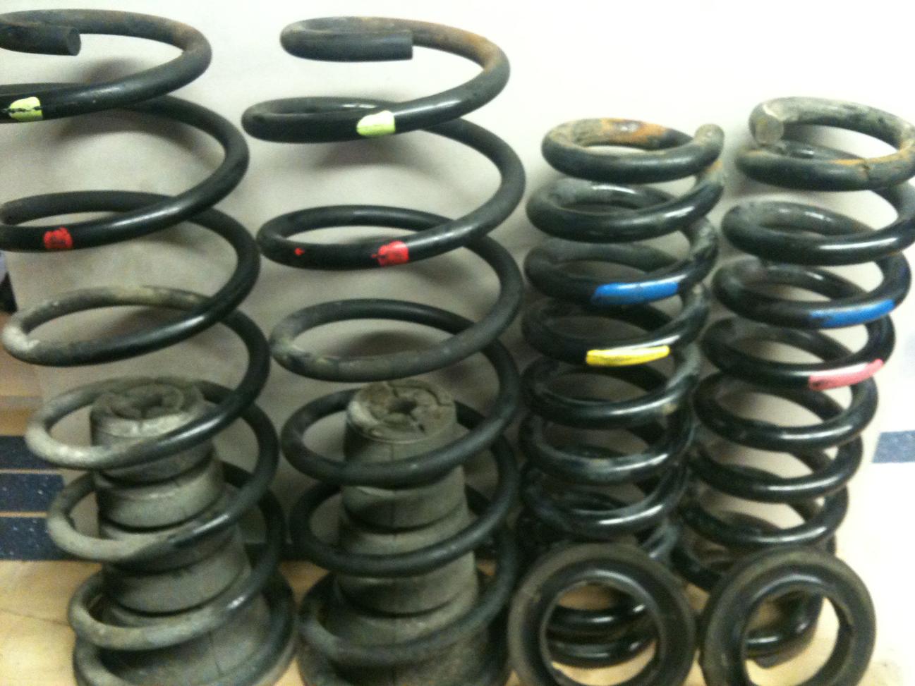

I run 265/75/16s on my '99. Wanna buy my old tall springs??:D
To answer your question from Yotatech, I run '99 tall springs with Bilstein HD's, it rides pretty nicely. I drive a lot and have no complaints.
As far as your other comment on Yotatech, lift or no lift, if you take corners like "a madman" in a 4Runner eventually you will flip it. Better chance on the taller tires too. If you want to drive it like a car, but a car before you hurt yourself.
