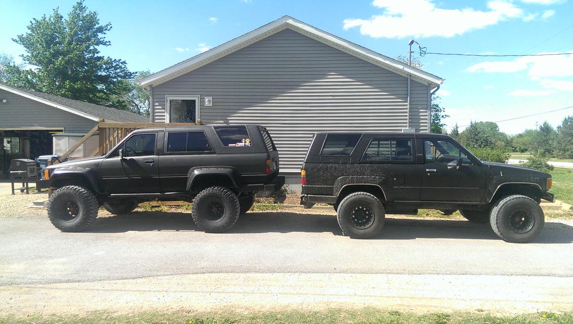

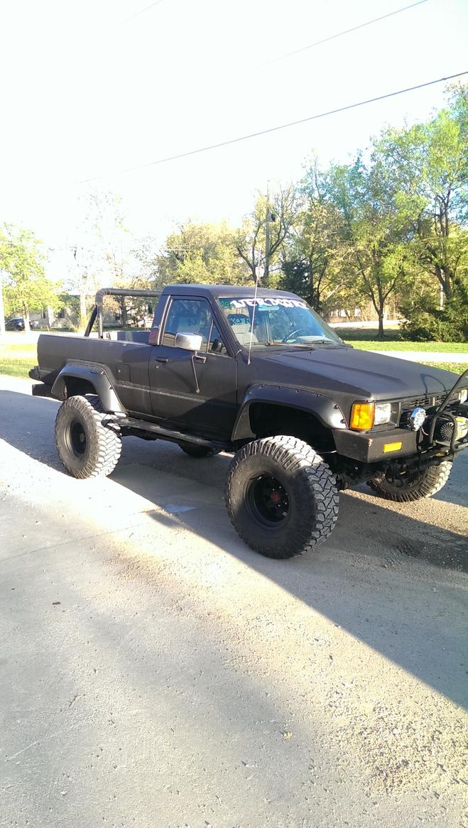

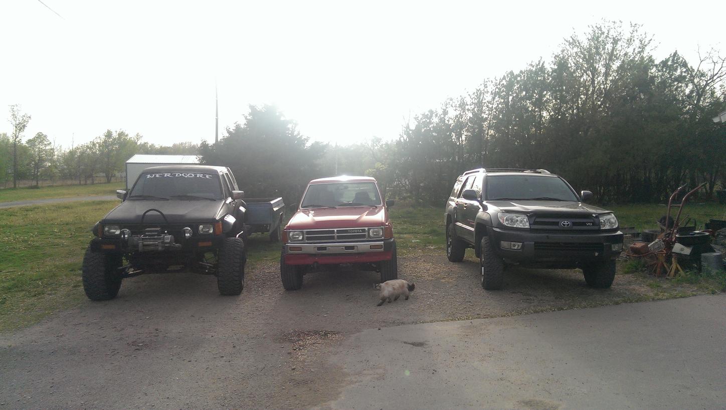

Well after some time and some other mods this little guy is done (For now). Thought i would update and post some pics. Thanks for all the advise and help, it got me this far :)
Along with my other kids.
Now that i post this I see why im always so damn busy. I also installed the LCE power package with the big bore throttle body, LCE cam, header, air intake system, injectors, and added a new cat and flowmaster 44 muffler, and some Micky MTZ 35's. Loving it so far !!!
Next item on the way will be the Marlin crawler 4:70 T-Case to slow things down a bit for the big rocks. The Blazeland kit has been holding up very well so far and so have the OEM balls joints on it. Had it out at the ORV areas here about 6 times so far and has been over some rather nasty rocks and waterfalls with great results.
