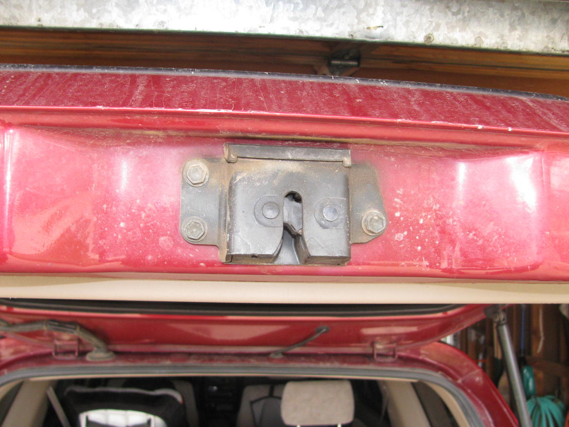

Sounds like the problem you are having is that when you open the rear hatch, the dome light does not come on? I had the same problem, replacing the liftgate latch (see pic) solved the problem. I found a used one for $30, no issues since.
Liftgate Latch for 1999 Toyota 4Runner|69350-35020
I too was having the same problem for the past 8 months. It was off and on though, until the beginning of July when it went completely dead. I just went to the junkyard and grabbed one. I just got done Installing it and it works! Thanks for the 411 and have a good day.
Awesome. Glad it solved the problem for you. Seems to be a pretty common issue.
I have a second spare latch from a junkyard. If anyone needs one send me a PM and we can work out a fair price.
