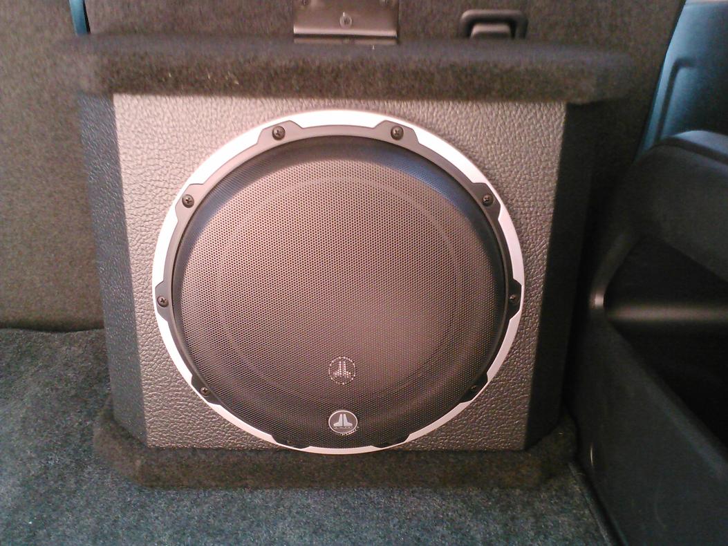

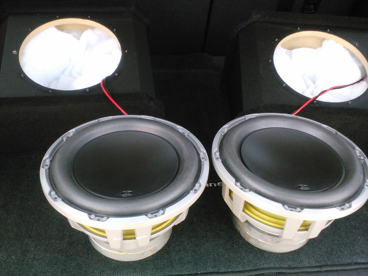

JL Audio is at the top of the league, wrt high-end mobile audio. Here's a few pics of my own investment. If you'd like to see more, just click on my avatar, or my name and see a written description of all my JL Audio equipment.
