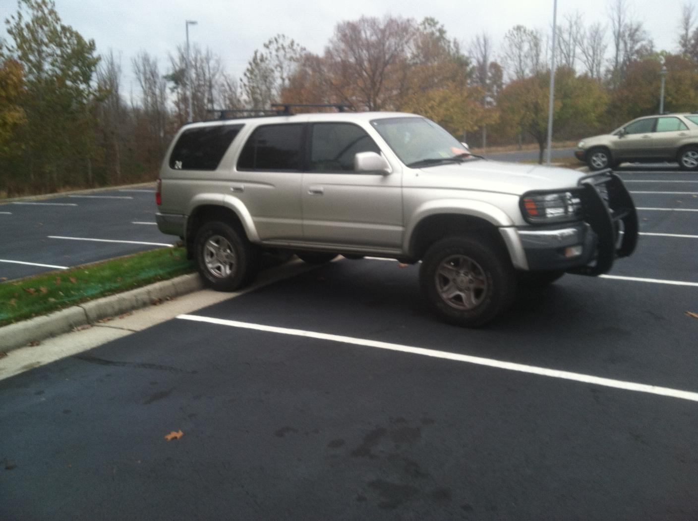

I have 265/70/R16 right now. I think what I will do is a 2 inch body lift and either the following for tires:
285/75/R16
305/70/R16
255/85/R16
Any recommendations? My 4runner is my daily drive and my off road vehicle. So maybe A/T? Because M/T wear down faster. I think I will keep the same stock rims I have now too. Ill post a picture of what it looks like now. All opinions (not just on tires) are welcomed.
-Buddy
Here it is

If youre looking to actually go wheeling in this a body lift really isnt doing anything exceot raising your center of gravity. You dont gain any additional ground clereance from your axles. Over all youll just raise the body enough to fit a larger tire. with my 4 inch suspension lift I am also adding a 2 inch body lift to be able to fit 35s but as for me I wouldnt run a body lift by itself. Its much cheaper, but it looks much cheaper as well especially for no gained performance.
Biggest lift you can get with the stock A arms is about 3". You can get about 4" suspension lift out of the rear if you don't mind the stinkbug look. That is plenty to fit the tires you are trying to fit.
I am a bit morally opposed to body lifts, although they can make things a little easier. Coming from someone who has rolled his truck, here is the rule of thumb that I like to encourage people to follow: lift only enough to clear the tires size you want. Lower center of gravity will make you more stable on the trails and on the highway. Then just cover up all the parts you don't want to scrape on the ground with skidplates :D
I did some searching on some build threads of other people with 3in and 33's and I think ill do that. I won't bother to save money for a body lift cause that is just $200 that could allow me to get tires sooner. Any opinion on size?
Size of lift or tires?
A BL and larger tires will increase your ground clearance though. For some tire sizes, you need a BL to retain full suspension travel without rubbing.
I don't understand why a SL and bigger tires is so highly recommended... When fully compressed, the rubbing will be just as bad as the stock suspension height. Yes, rubbing will be less during everyday driving.
ETA: True, a SL is always cooler than a BL :)
