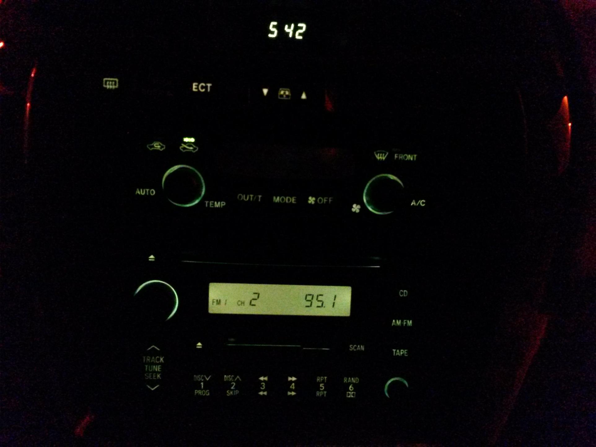

Hi all
This morning I start up my 4runner and notice the light that displays the climate control and temperature, has burnt out. I have no clue on how to go about and change it, if it can be changed. If anyone knows how to, I would appreciate your help!
Thanks!
Easy fix: http://www.toyota-4runner.org/3rd-gen-t4rs/83928-changing-bulbs-c-unit.html#post724336
For future reference, check this thread to find answers to commonly asked questions:
http://www.toyota-4runner.org/3rd-gen-t4rs/69744-3rd-gen-faq-tutorials-documentation-reference.html
EDIT: The pictures in the first link are no longer working, so see this thread: http://www.toyota-4runner.org/3rd-gen-t4rs/132012-write-up-climate-control-dash-bulbs-2000-limited.html MODS - can we replace (or add) the original thread in the FAQ with this one?
FYI OP, you'll have to go to a Toyotoa dealer to buy the bulbs, go ahead and buy two of each bulbs they pull up on their computer and replace all of them, roughly $9 each. I personally avoid LED replacements, mixed bag of results.
