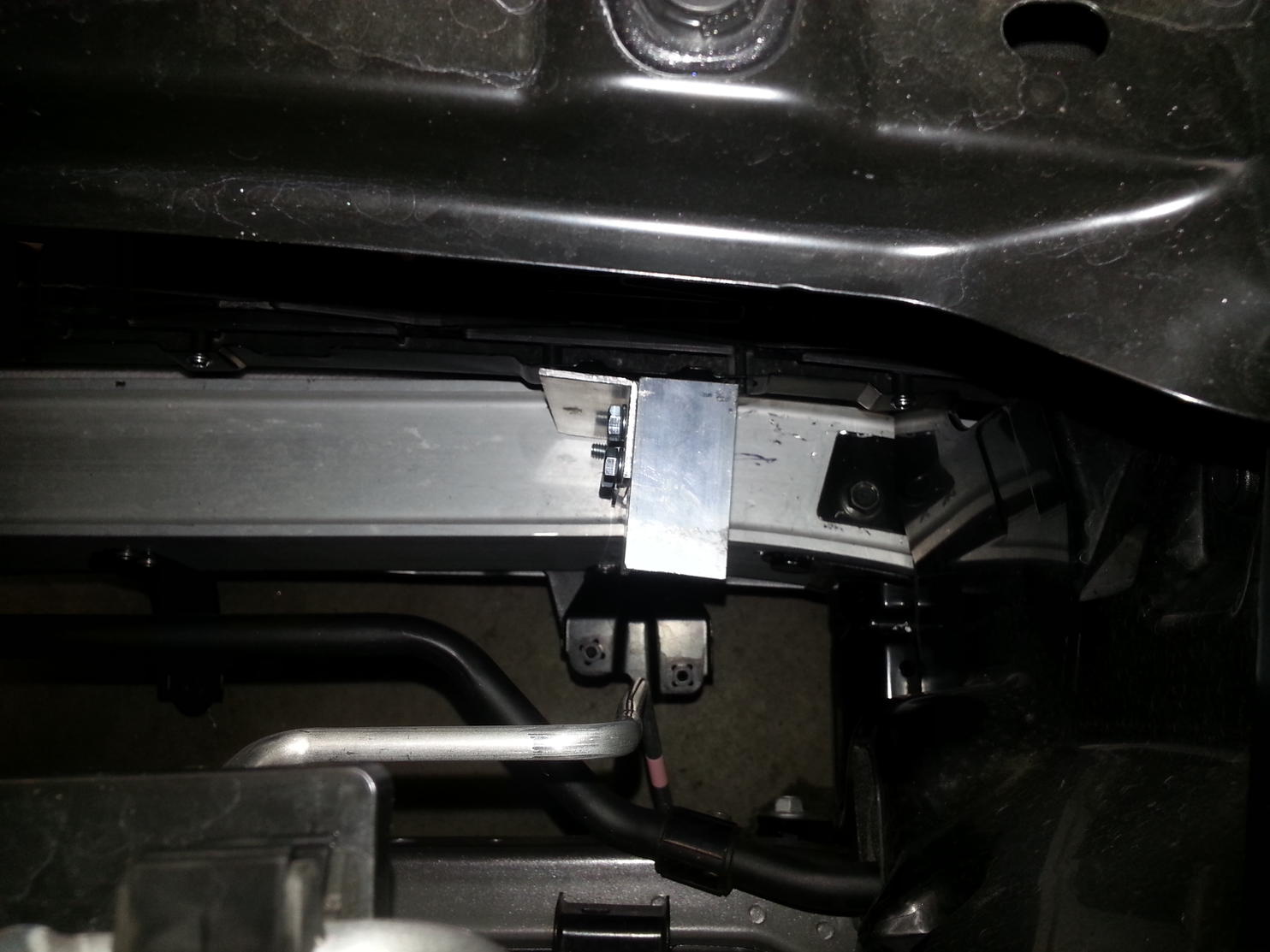

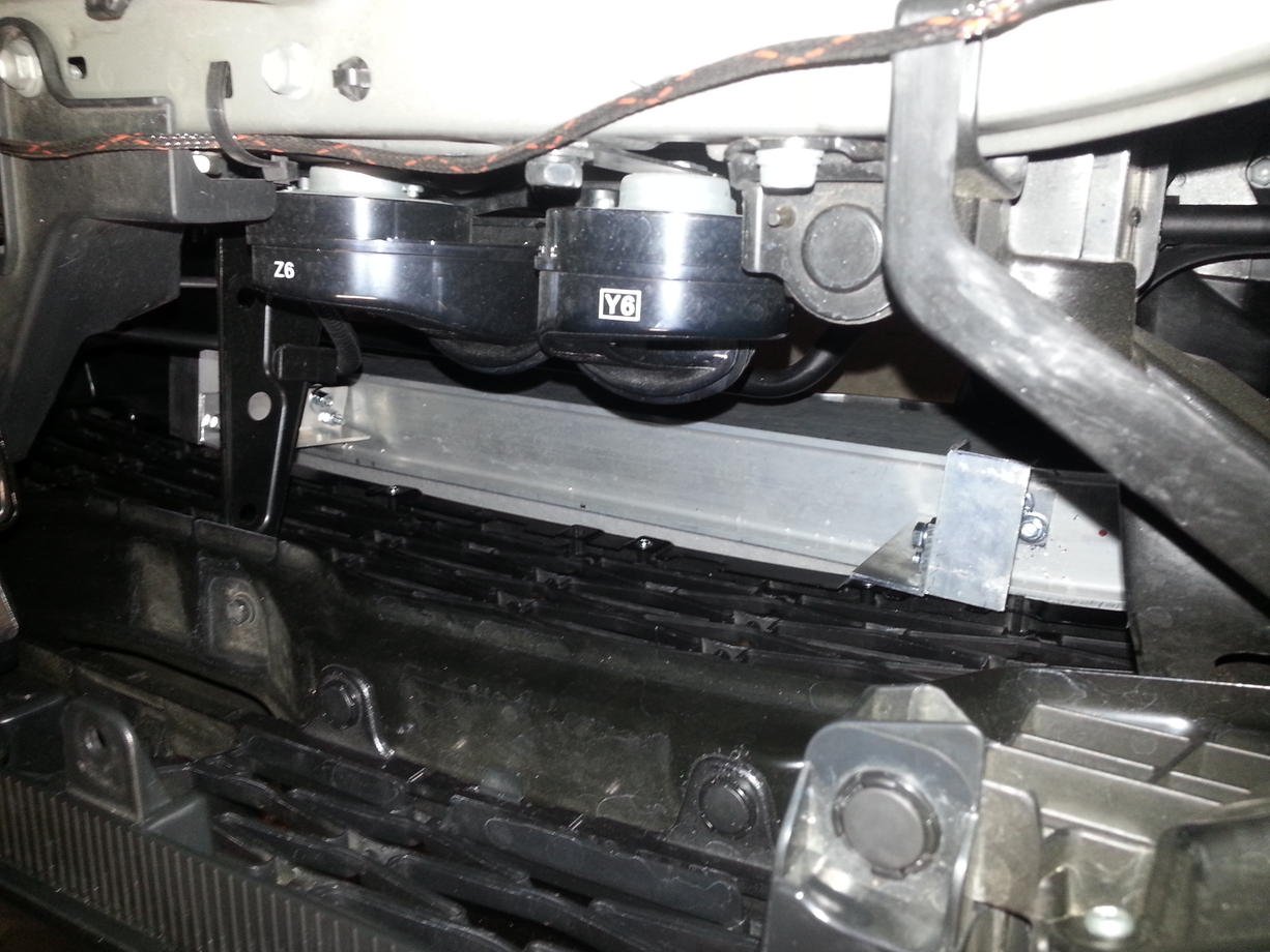

I did three separate pieces of angle L aluminium for each side of light bar. One laying flat on support as a base, one going up as a vertical riser, and one attached to side of the riser, flat side up for bar to bolt to. Maybe a foot of angle aluminum per side (thats plenty), bolts of your choice, a hacksaw or sawzall, and a drill for the holes. That's how I did mine. I looked at [MENTION=103267]Saker[/MENTION] build to be honest and he had some good ideas.

Look in my sig it will take you to my link on my LED bar install. Maybe someone can help you fab something or you can have someone look at Lexusbstrdchild setup...remember you can always but a flat bar across the top to facilitate more options!

I have a picture of mine mounted, but it's on a Limited and I was able to use the bracket that came with the lightbar. Simply drilled and atpped two holes for it.
Link to my lightbar mount

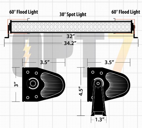

After looking at the replies the lightbar I have mounts on the side. Here is the diagram. Also, I cannot use the lower bumer for mounting as I will be installing a hidden winch system there.
