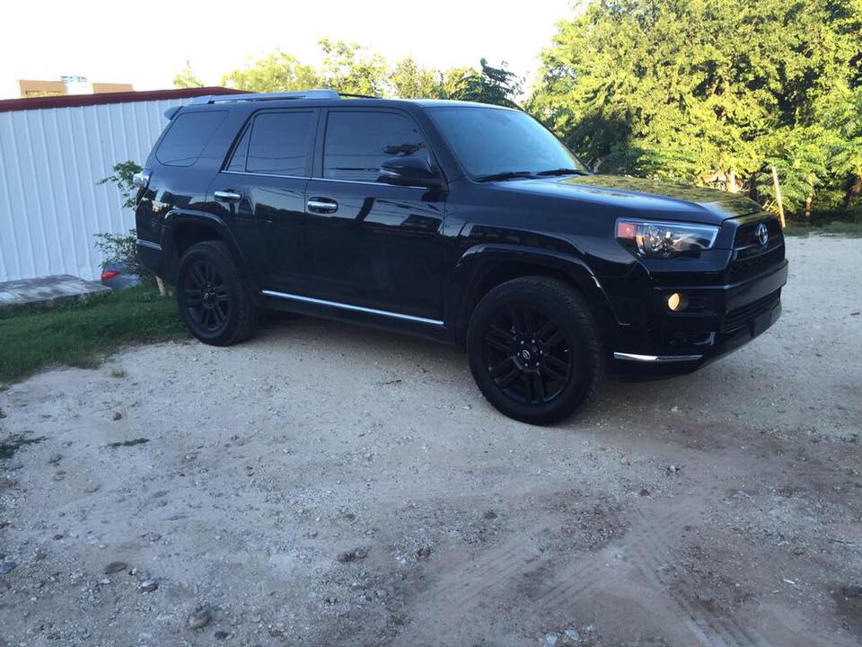

She looks much meaner now.
I will 2nd this, looking to do a trd full front swap but I would be super happy with that!
That will cost you thousands though.
You can just just put a TRD Pro garnish on and plasti dip all the chromes. That would look awesome.
Did you order your parts from your local dealer? How much did it it cost you?
I bought a TSO Pro grille which is an aftermarket product and the upper radiator from the dealer. I still can’t justify the price of these two pieces of plastic though.
So it’s overall $650.
thanks man, looks awesome. IMO it is def worth the money.

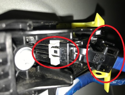

I see that some of you have already color matched or blacked out your door handles. i posted this on a different thread but no luck, hoping i can get some help here.
I have a 2010 Limited with the touch sensor door handles and really wanting to switch out the chrome for the black TE handles.
I’m thinking the LE door handles might be slightly different from the rest because of the sensors? Has anyone with a LE have any info on this?
I figured it out and I thought I’d post it just in case others are running into the same problem. On LE handles you’ll have to disconnect the sensors before you can take of the outside door handles. Once you’ve removed the inside door panel and you get behind the handle, the handle is held on by a clip and the actual connector. In the image below, it shows that I’ve unhooked the clips (right) and the next step is to disconnect the connector (left). Once you do that, you should be able to remove the door handle.
