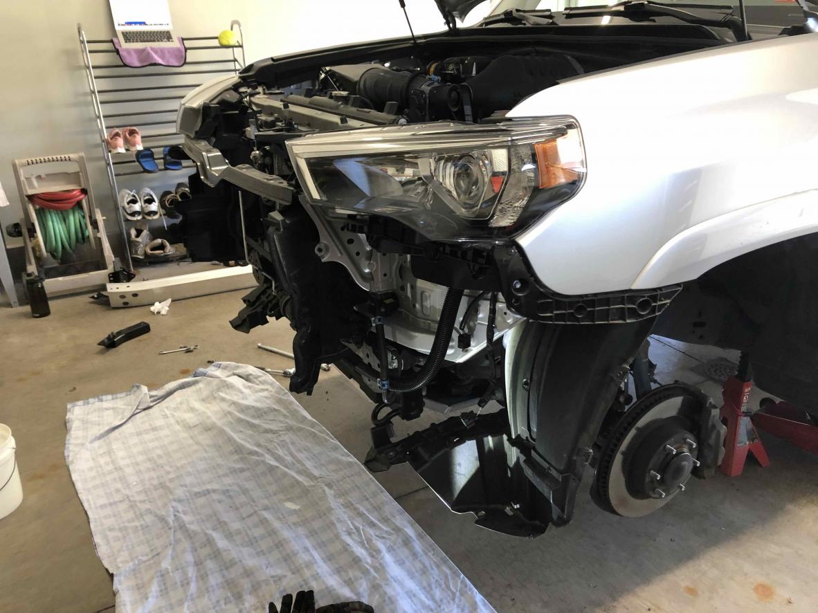

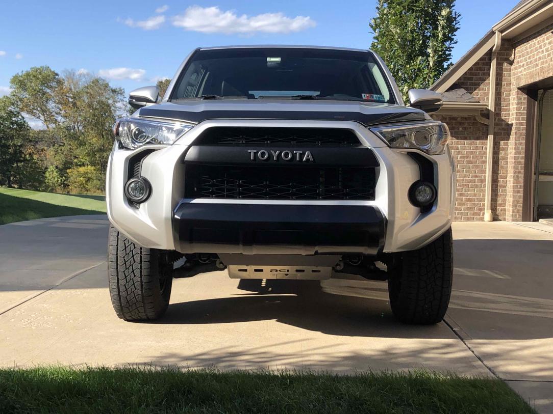

bumper swap today
I've been accumulating parts over the past 6 months and got the final pieces in last week.
Tackled this today. Not that tough of a job. I did it myself and it would have been a bit easier with a helper during some steps.
I did the Chinese TRD grill (lights still to do) and I'm not thrilled with the fitment. Granted...it's like a quarter of the cost. Going to try and work it a bit more tomorrow with a heat gun.
You can see on one of the pics how much lower the limited bumper sits compared to the trail/TRD. There is some trimming you need to do, but it's not difficult just a little time consuming.
Also went with the RCI filler plate. I'm happy with the results (once I fiddle with the TRD bar more).
Looking good. It looks like you didn't keep your front proximity sensors on the new bumper.
Good eye :)
Yes. The sensors are sitting in the basement. The rears still work and I do not get any type of errors. Honestly, usually have it turned off because I usually have my bike hitch 1UP rack and it's constantly going off. Not a huge loss.

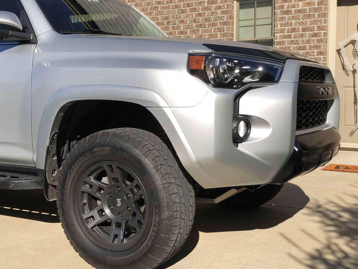

Wasn’t quite feeling the trail wheels so I upgraded a bit...
FN Wheels Overlander Spec B - Falken Wildpeak A/T

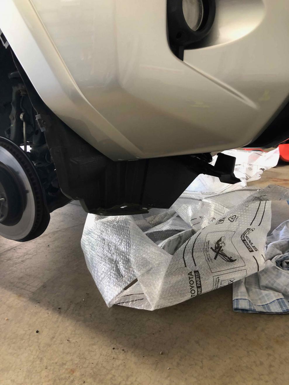

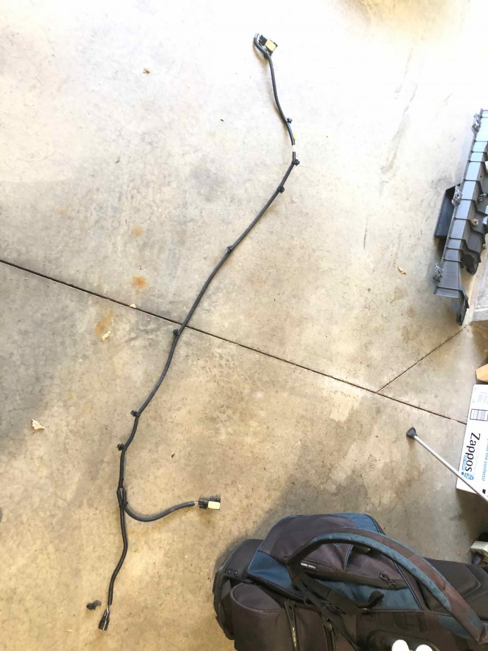

Looks awesome. Did you relocate the parking sensors ? If so, can you post a picture of them.
Thanks
I disconnected the front sensors. The rears work fine.
Didn’t feel like drilling holes for not much benefit. Plus I was getting tired....

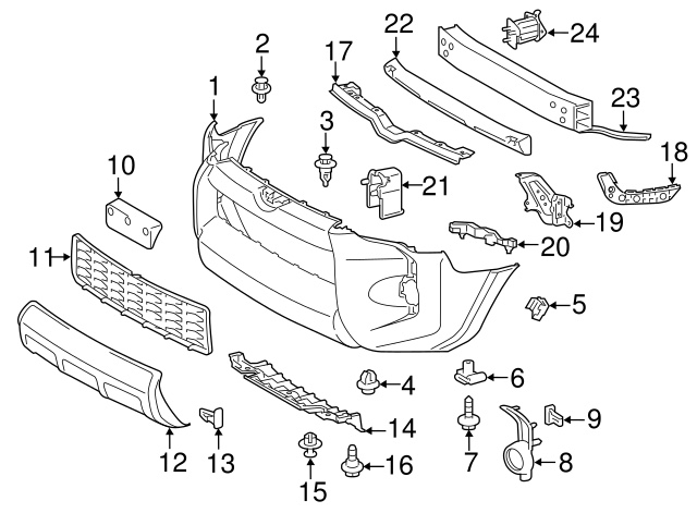

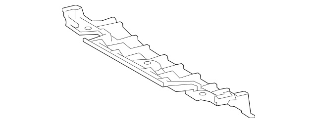

I’m in the process of doing the same bumper conversation. Most of the parts I got used as well. But there is this one item I’m not sure if I need to order. It looks like a skid plate ? But I’m planning to use the TRD Pro skid plate, so do I need this ? It’s #14.
Thanks [emoji2957]
Lower Cover - Toyota (52129-35030) | Toyota Parts
Thanks [emoji2957]

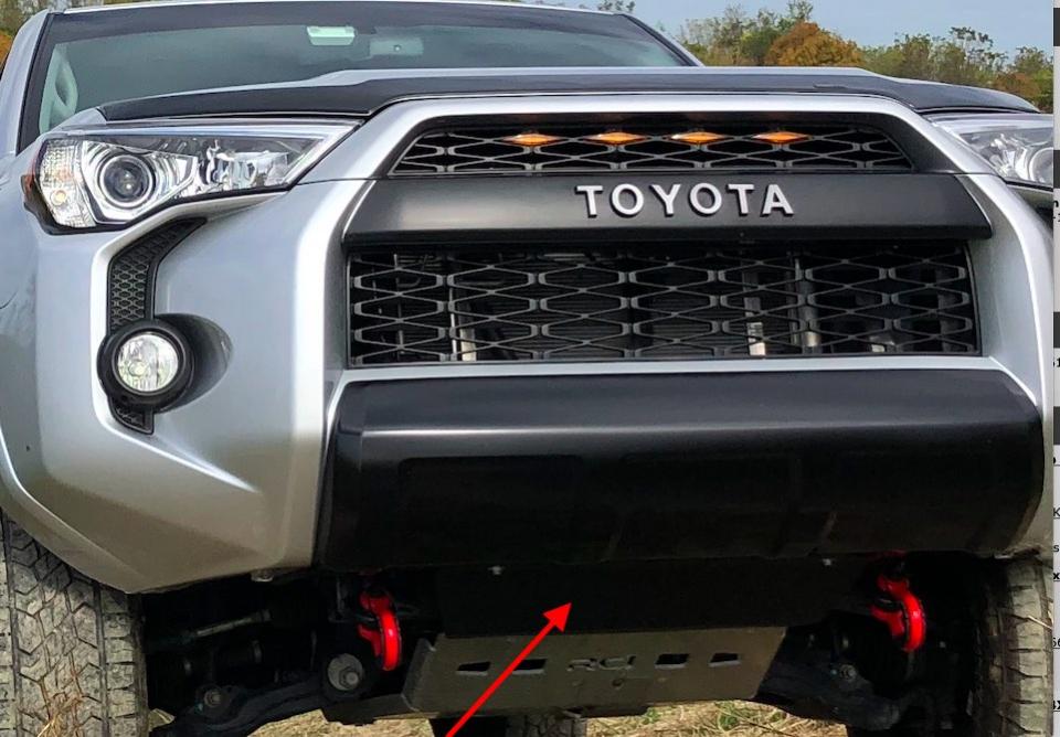

I have the RCI skid and bumper fill plate.
#14 in that pic isn't needed for my build as this: Bumper Filler Plate | 10-Present 4Runner – RCI Offroad
takes that place.
Thanks [emoji2957]
You do not need that plastic piece. It is not needed or compatible with the TRD skid plate.
