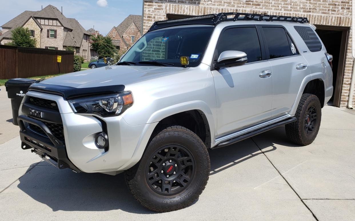

Looks awesome. Did you relocate the parking sensors ? If so, can you post a picture of them.
Thanks
I placed my proximity sensors just below the fogs.

I was thinking the same. I’ll place the sensor directly under the fog lights in that middle section like yours.
Did you do the rear 4 as well ?
only place the sensors under the fogs if you are sure tgat you wull not be making high clearence bumper cuts, or you may need to buy a new bumper.

If you use something like the SSO bumper with Stage 2 high clearance, d placement of the sensors looks halfway through the cut line, so you'll end up with an exposed Crescent cut in the end
Better to plan ahead and pick a location away from the high clearance cut area so you can maintain the sensors if you go with a more extreme route
I haven't swapped my rear bumper yet but have a steel rear on order so the sensors will have to go.
Keep in mind that for the front bumper sensors, the limited bumper has an upward angle so the plastic ring around the sensor has a thicker rim on top to point the sensor out straight. The offroad/pro front bumper has a downward angle in the area where I placed my sensors so the ring had to be place upside down to angle the sensors straight. And also, the sensor hole cut is not a circular cut. I just traced the sensor hole on the limited bumper with cardboard and flipped the template, traced it on the new bumper, cut the outline, and installed the sensors.

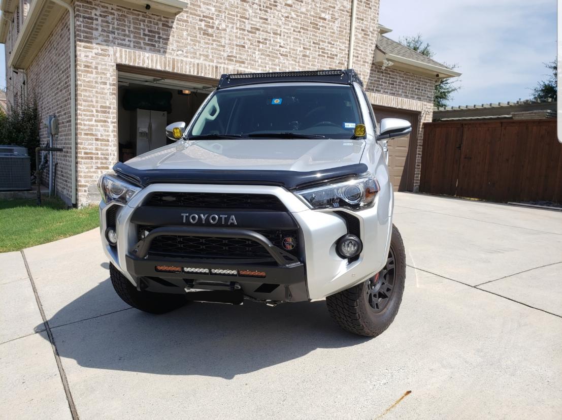

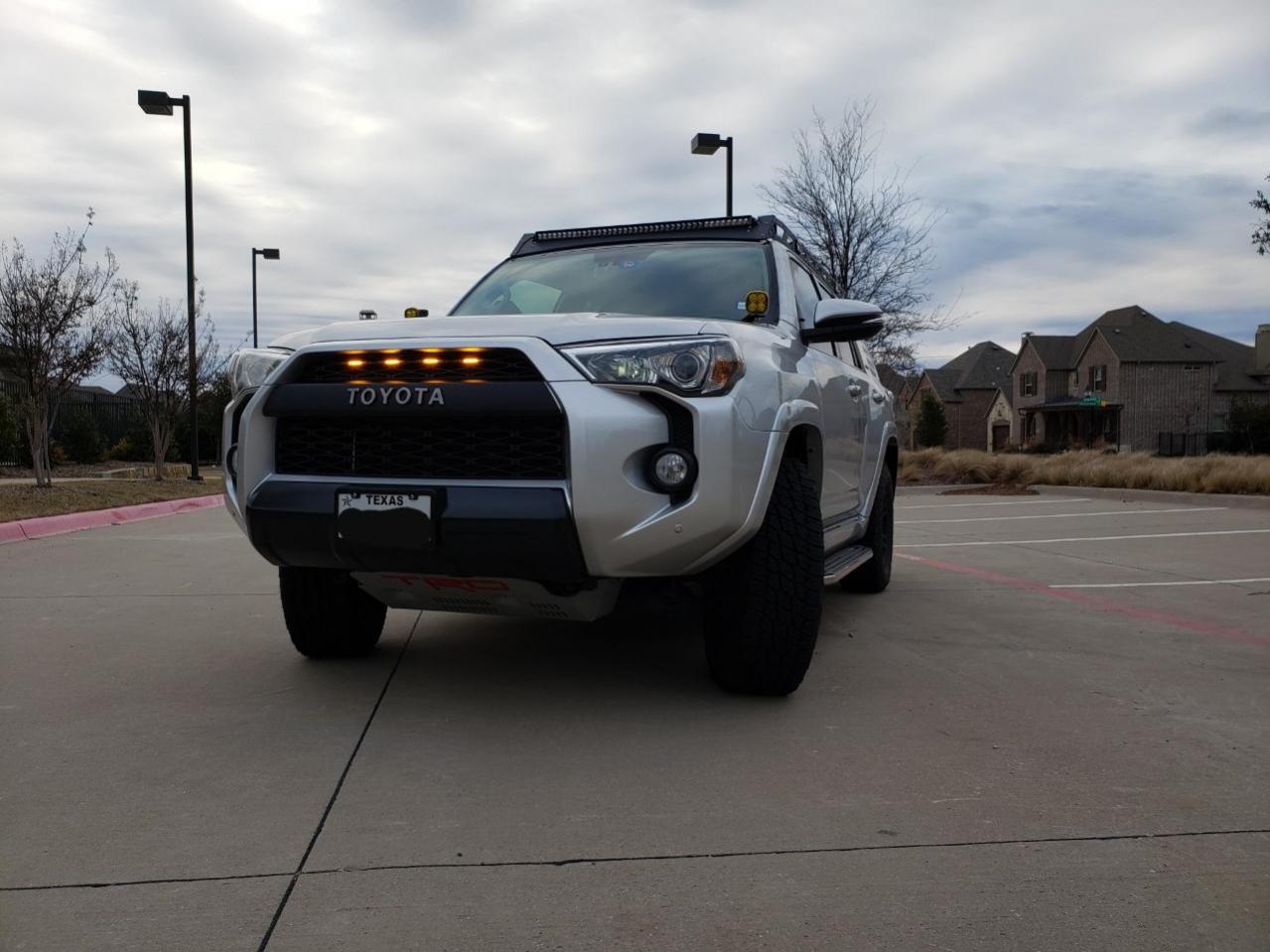

I've done a lot more to my t4r since this mod. Here it is as it currently stands.
