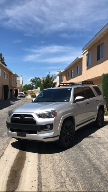

Blacked out all the chrome, removed the pinstripes, made use of the original 20’ rims by plastidipping them. I think the only thing I’d like to add next would be a gobi ladder.
