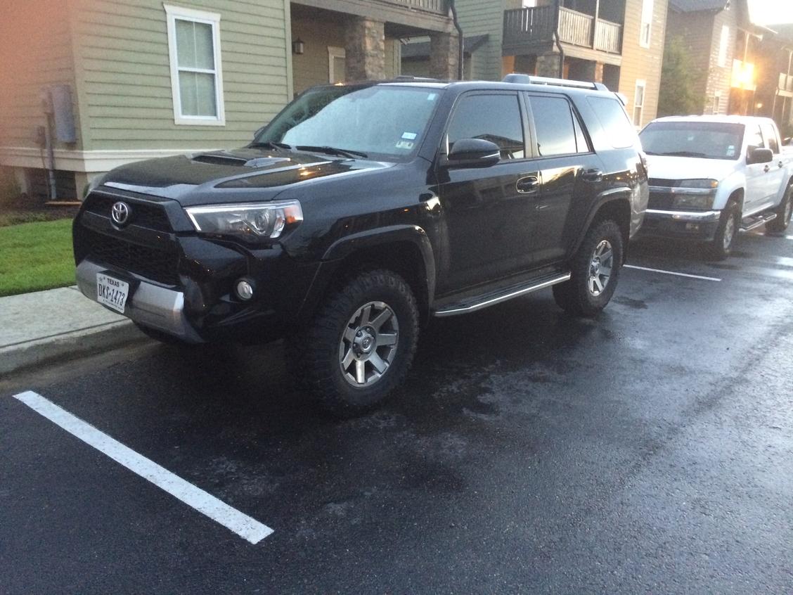

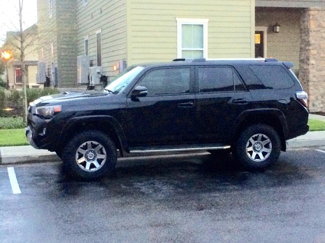

I went with the dura's and also considered the Open Country. Neither are a bad tire but I prefer the Dura's for offloading. I also did a 2.5"F/2"R Toytec spacer leveling kit. As for the front damage, one of my pledge brothers didn't see these two Swiss guys in a rental car in front of him on the highway and slammed into their rear. :yuck::wtf:

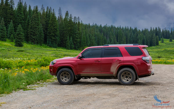

When I put new tires on back in July, I opted for Load Range C tires as I did not feel that I was going to put my Runner in any position to need to air-down to the point where 10-ply tires would save my bacon.
Since putting the new tires on (Big-O branded Cooper A/T3's), my fuel economy has remained the same as before with P-Metric stock tires. My offroad performance, however, has increased pretty substantially. Definitely feel more comfortable putting Lucille through her paces out in the backcountry. These tires are 6-ply tires so I 'can' air-down some if desired and the tires will have sufficient sidewall to keep me safe, though I have yet to actually do any of that... :)
