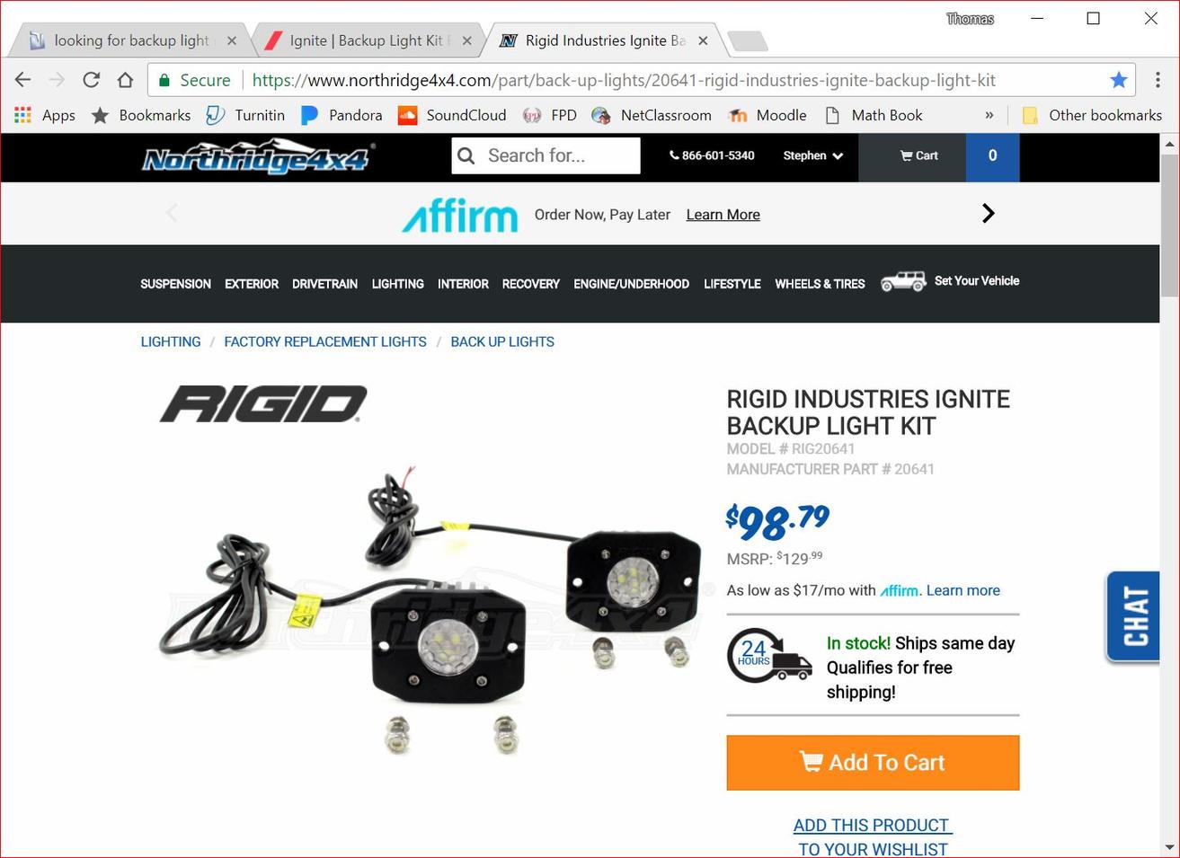

hey I just got these for pretty cheap, Got them off of northridge but they are Rigid Industries, which is a very good brand. I have nit gotten them yet, I think the forest fires in Cali are slowing them down or something, but I think they are a good product, only 98$, I have other rigid products, that is why I recommend them.

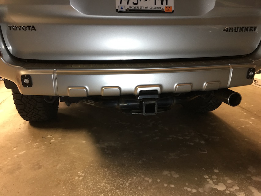

I installed Rigid Ignites on both my vehicles. Perfect backup light addition.

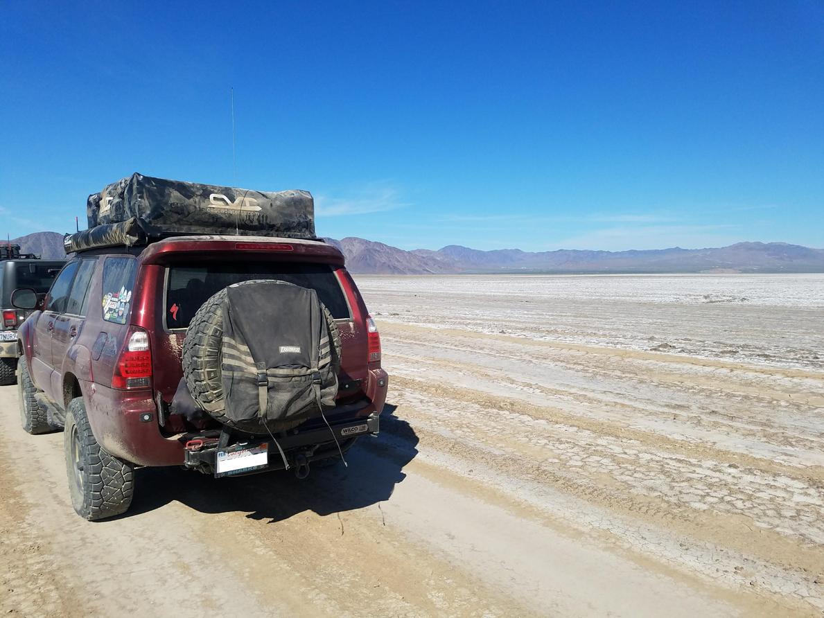

These are the ones I used on mine but I mounted mine higher to look a bit cleaner and to throw light past my Wilco swingout. You can kind of see them in this pic. They put out great light.

That looks sweet, I can't wait to get mine and install them. What did you use to cut into the bumper?
Contact Whitebeauty (forum member) and he'll hook you up. They're 11W CREE LED and I think they make a 15W version and 20W version now too...
