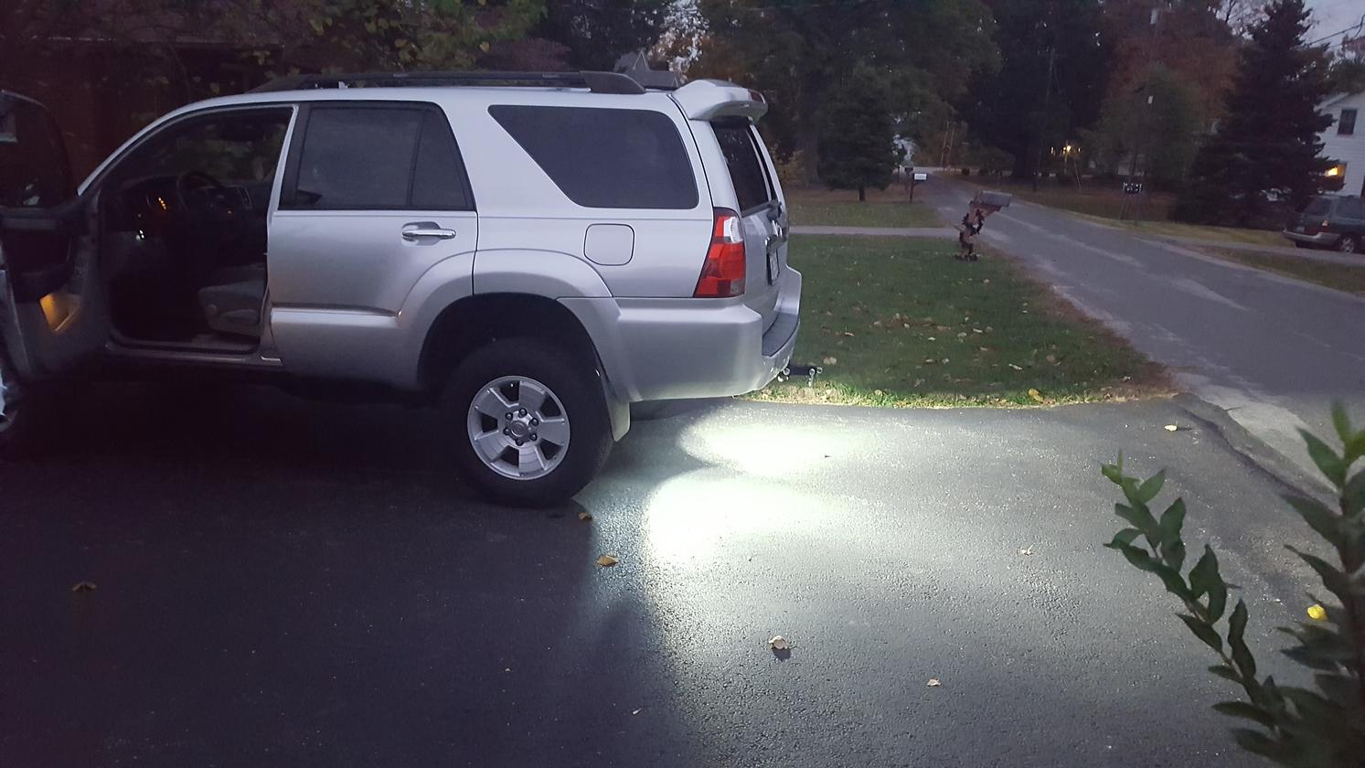

Installed the Kawell 18W LEDs. There are mounting points on the rear bumper that worked perfectly. Tapped into the trailer wiring for power when in reverse (I think it was the yellow wire). Definitely more light but view is still not great with tinted windows.

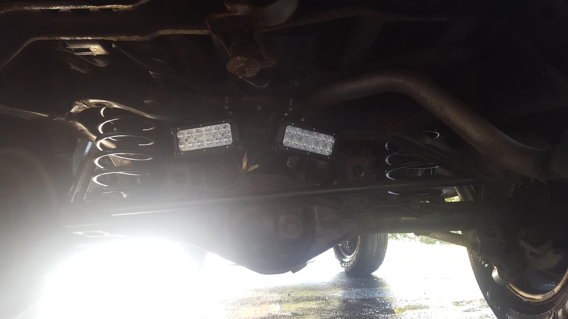

I did something very similar to what V_Man did. Since I don't have a tire under the vehicle, I opted to put 2 sets of 6" LED's under there.

Thanks, I'm doing them right now. how do you wire them?

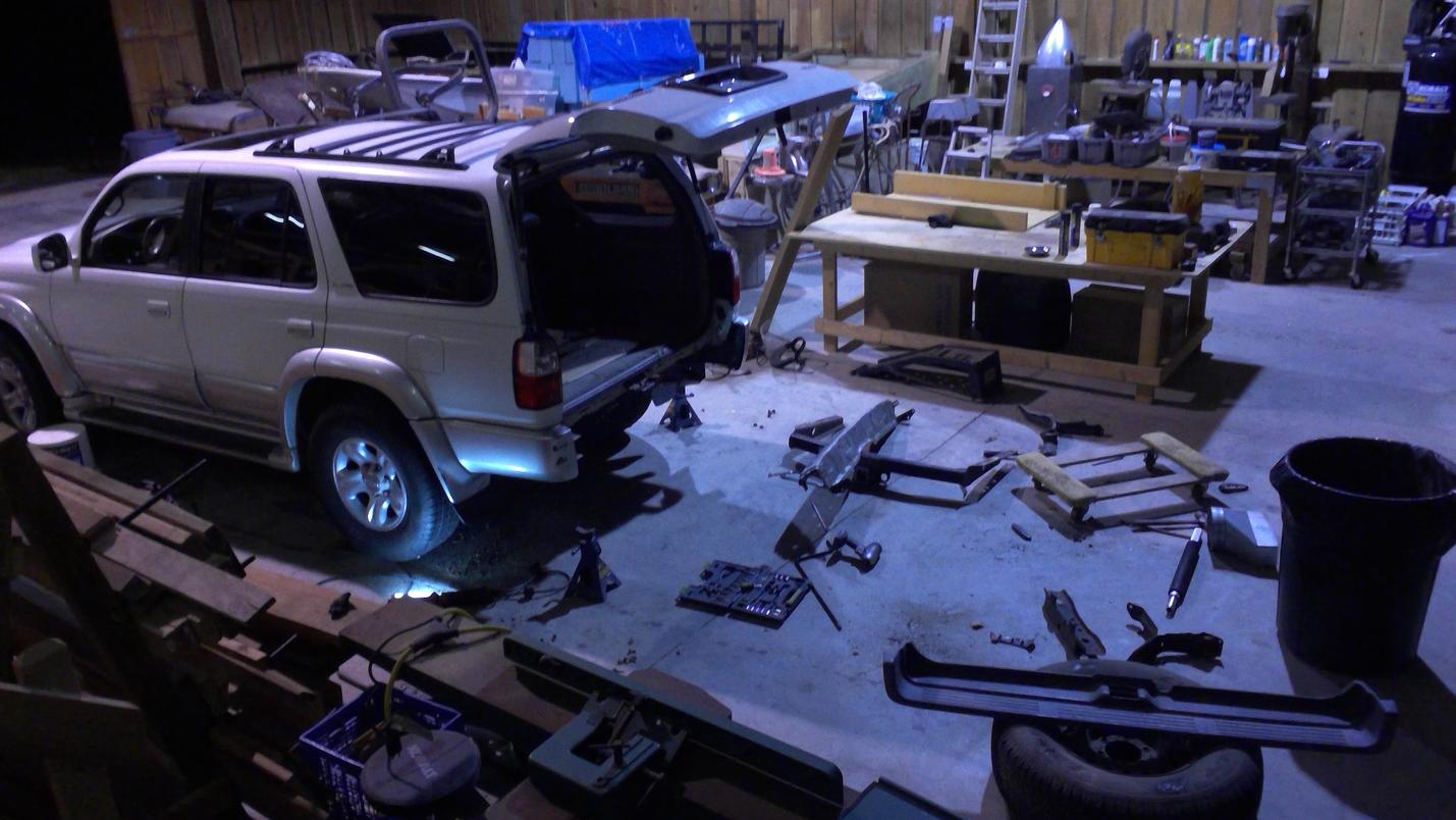

and yes, this is my grandpa's barn. Very blessed to have access to it :)
Originally I ran the wires up near the housings and thru the little gasket and wired them to the existing back up lights. They barely pull any amperage so it won't hurt anything.

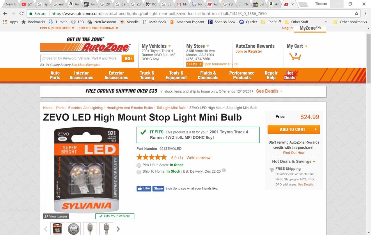

Oh I will just sell them on craigslist unless one of you guys wants them despite the fact that there are good bulbs. the bulbs are nowhere near as bright as the ignites, but they work well. I am running these from auto zone, but everywhere carries them, i assume.
