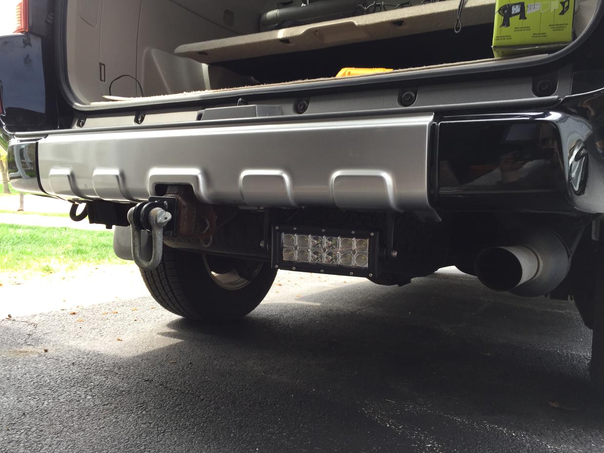

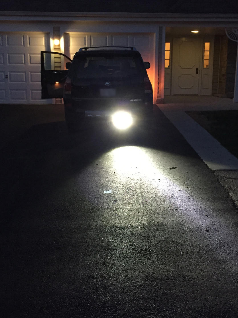

One of the first mods I did when I bought my T4R. I threw a 6" LED on by tapping the frame with 5mm bolts. The placement works great for throwing light on my camper while we are setting up at night. Not a great placement for trail or crawling. I will be moving it upwards this summer, probably onto a roof rack.

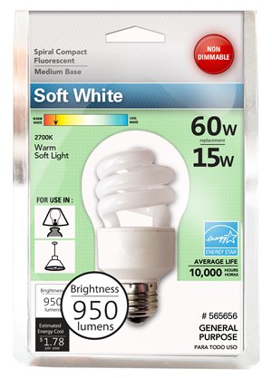

You're right about the color temp issue.
The watt rating refers to the power consumed by a bulb,
so, in general, a bulb that consumes more power will put out more light,
but that's only a partial answer. For incandescent bulbs that tends to be the case. When you go to other lighting technologies, lumens are really the right measure.
It can get a bit confusing because some companies may list a light bulb as "60 watts" (see the image below)...
...even though it only consumes 15 watts. What they are saying is that most 60 watt incandescent light bulbs put out about 900 lumens, and their 15 watt compact fluorescent bulb also puts out about 900 lumens, therefore you should think of it as if you were putting an "old skool" 60 watt bulb in your lamp.
