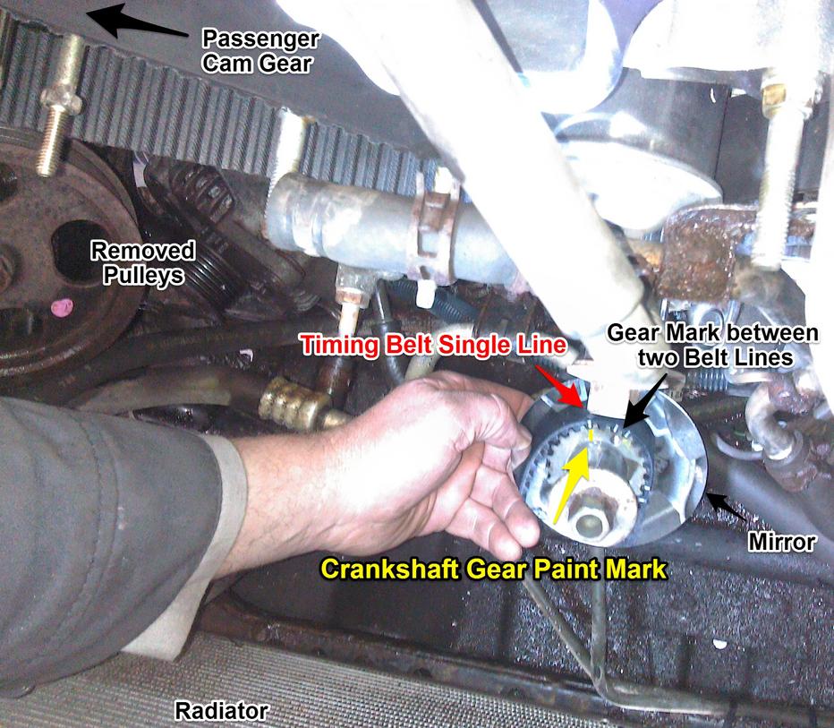

Timing Belt Camshaft Gear Alignment
Here is a pic of the proper alignment of the paint marks on the camshaft timing gear and the timing belt in the 4th Gen V8 4.7L 2004 4Runner Limited.
The pic is looking down between the radiator and the engine, using a mirror to "see" the camshaft timing gear.
You can see the removed power steering pump on the left side of the pic and the belt going up toward the passenger side top cam gear.
The timing belt has three lines on it. One is by itself, the other two are together. Notice the crankshaft timing gear has marks on it. The one closest to the passenger side is a single yellow paint dot (I enhanced it in the pic). It should align with the single line on the belt.
The other mark on the gear should fall BETWEEN the pair of two lines on the belt.

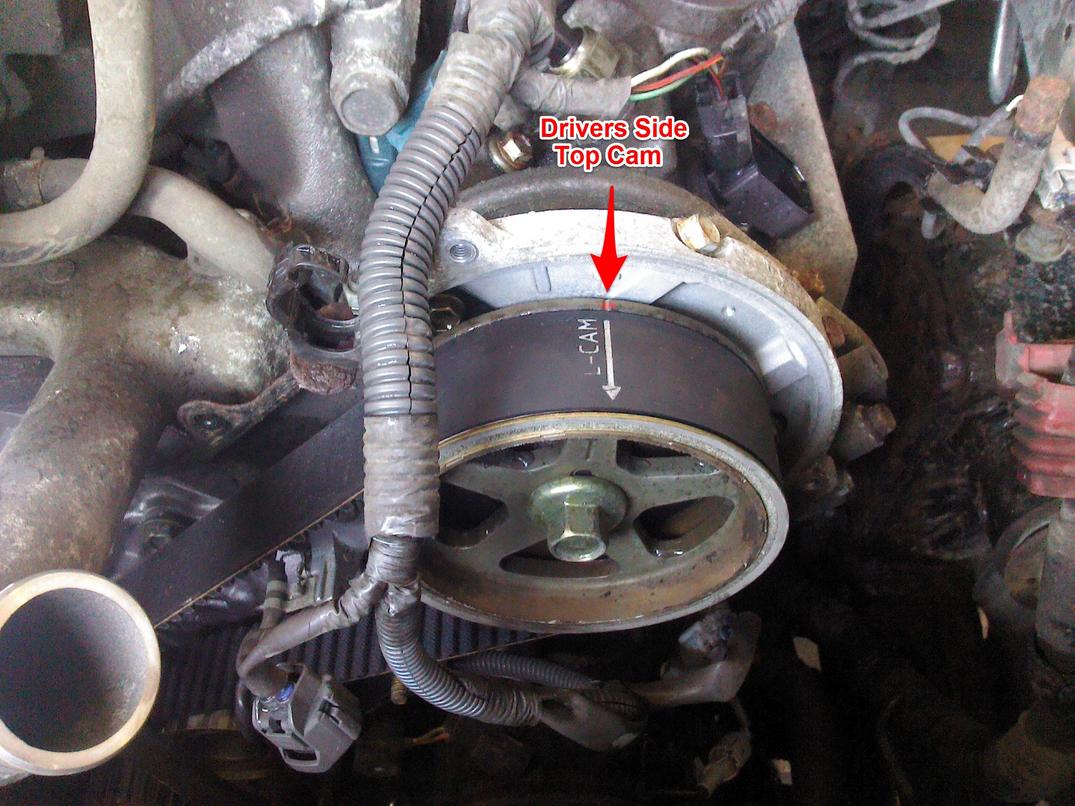

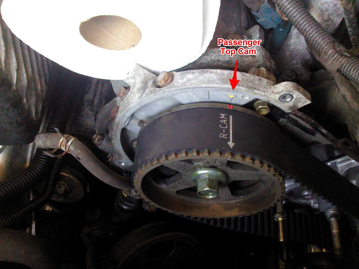

Timing Belt Top Cam Gear Alignment Pics
Here are pics of the timing belt alignment on the top Cam Gears. Note that 'Left' 'Right' and forward arrows are labeled from the perspective of the DRIVERS SEAT.
This left one gave some trouble. It took the two of us to hold the belt off the edge of the gear while the other turned the gear with a wrench on the bolt, then slide the belt on the gear. It's easier if the belt is not on all the tension/idler pulleys yet.
Just be ready as it turns clockwise, it will "spring" after a point, which is just enough to smash one's fingers against the battery housing. Twice. It draws blood the second time ;)

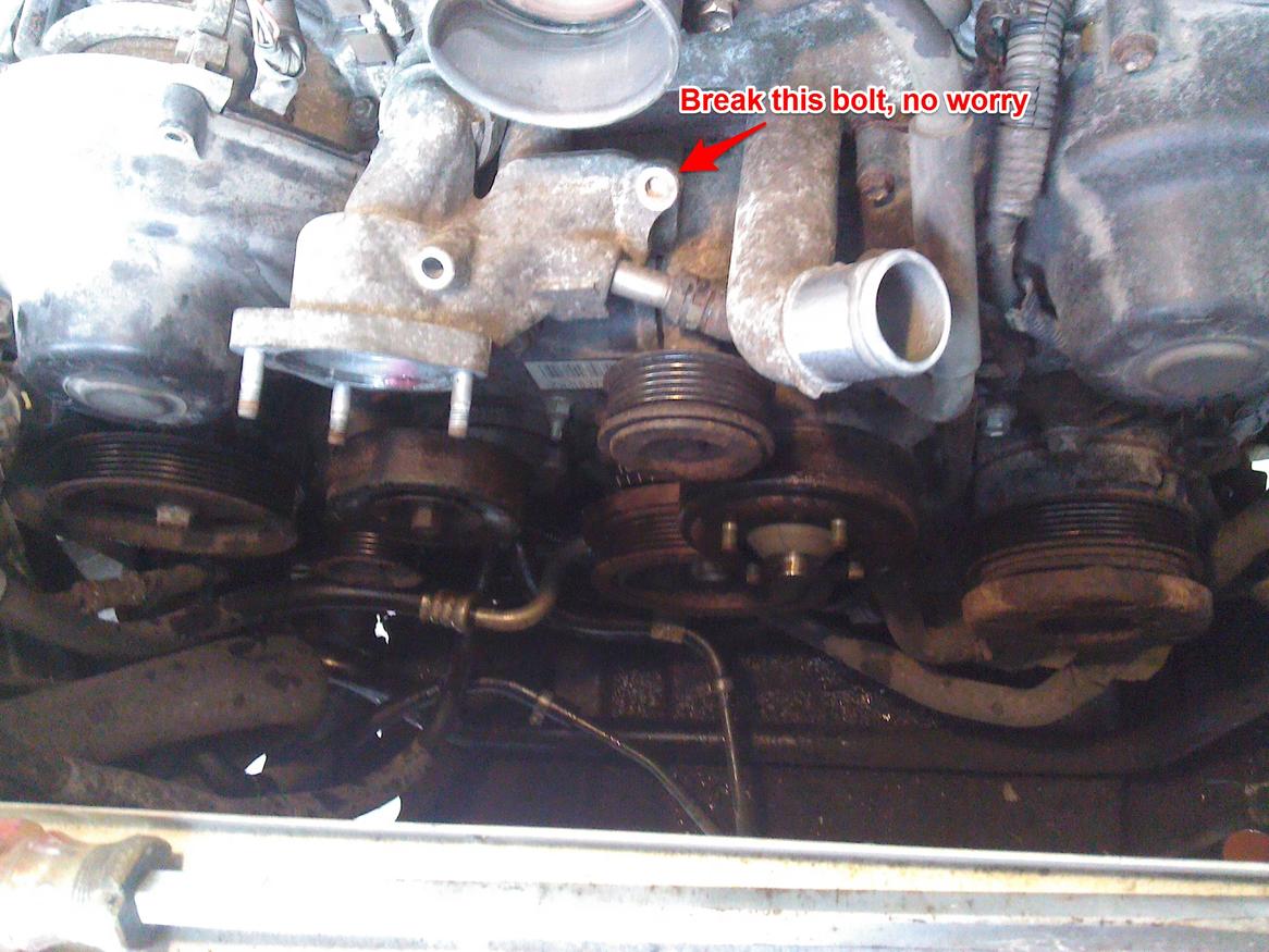

Break this bolt, don't worry!
Pay close attention to what I'm about to tell you. It will save you about an HOUR of time!
Go ahead and BREAK THIS BOLT if it is stuck! Do not worry about using an easy out, heat, left handed drill bits, precision center drilling to proper diameter for a through bolt and nut, using care to cover the holes and police all your shavings, etc.
The new water pump REPLACES THIS PART!
Uhm...yeah...I did all the things I'm telling you not to do, then realized the new part replaces that bolt hole :yell: :clock:
As long as you have a replacement bolt (maybe someone can post the size?) don't worry about breaking it off, it's pretty soft.
There you go, now you may save yourself more than twice the time it took you to read this entire thread :D
Hope this helps the next guy.

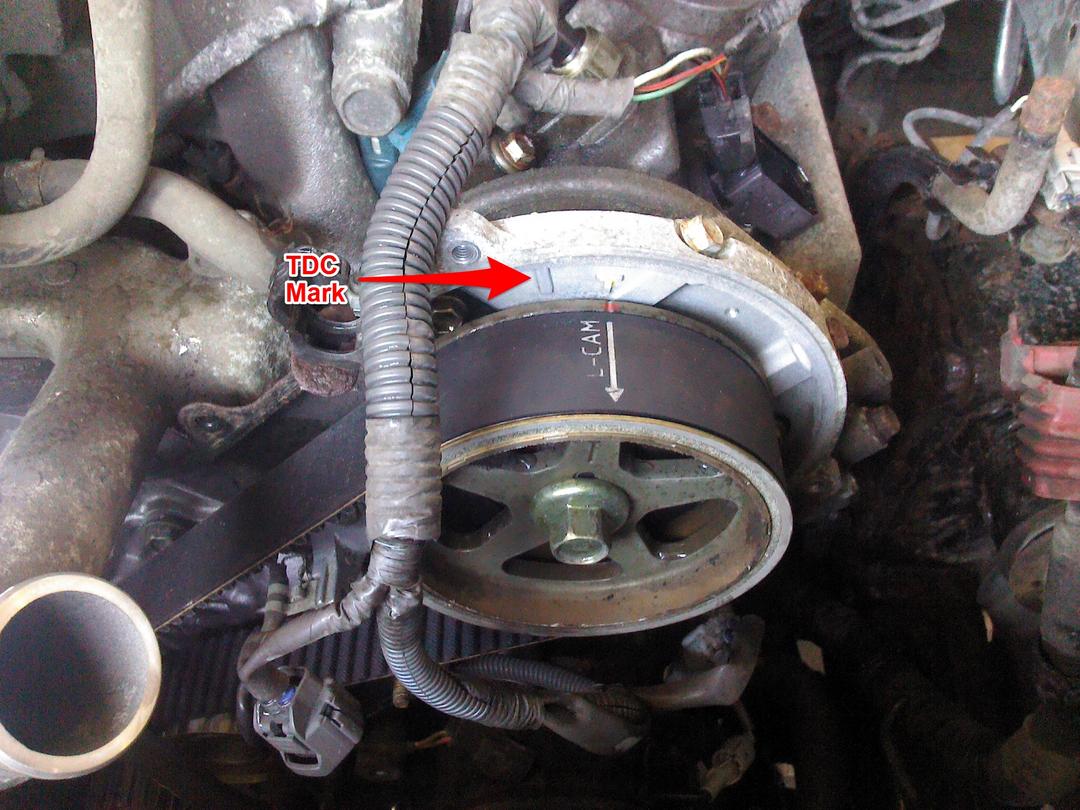

TDC Alignment Mark
When you have the parts back on the timing belt areas, including the entire crankshaft assembly, but haven't put the top cam covers on yet, you can turn the crank with a wrench, aligning its timing marks with TDC ('0') and each cam should align with its TDC Alignment Mark. You can see the TDC mark in this pic of the Driver's side top cam gear, although the timing belt arrow is aligned with the installation mark (I reused the pic I had).
The arrow should be aligned with the TDC mark when the crankshaft is in the TDC position (not the way it is in the pic). I didn't have a pic of that, so spelling it out.
If BOTH cams are not aligned with the belt and TDC marks after at least one full rotation, then STOP! It MUST be corrected before continuing!
