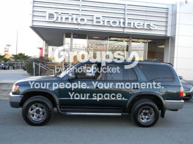

Bought it stock Feb. 1 2014 from a dealership.
1997 SR5 4runner 4wd, 5 speed, 3.4L

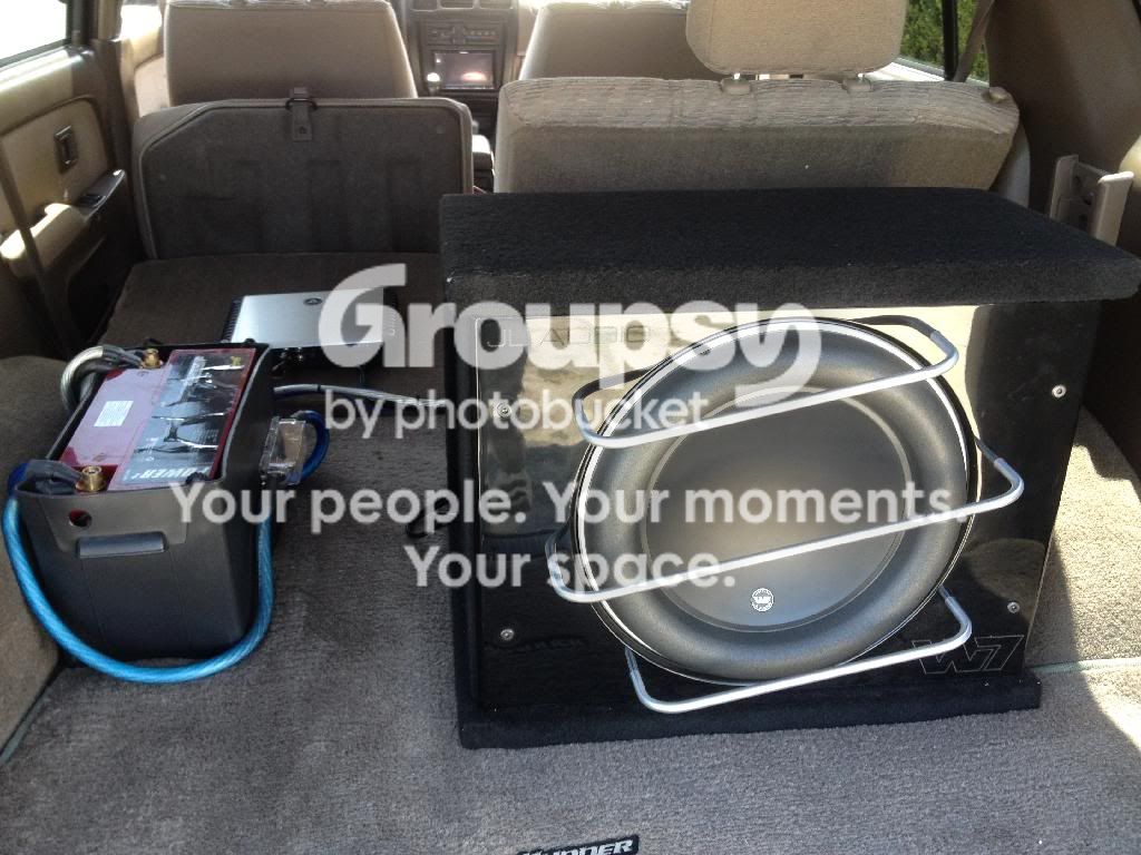

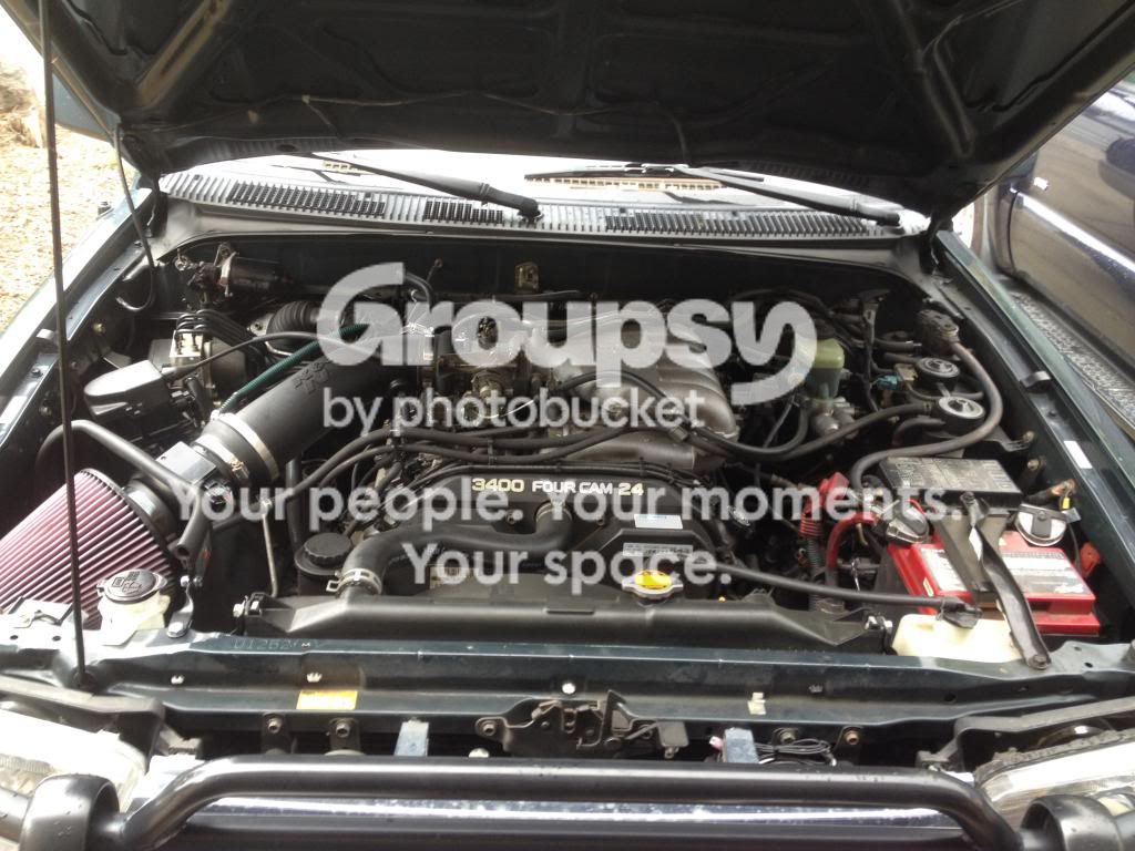

I love music, so the first thing I did was put in the sound system that I had in my last 4Runner. JL Audio HD 1200/1 and 300/4v3 with a 13W7 and an isolated Stinger battery.
K&N Intake and Stinger agm sealed batteries front and rear.

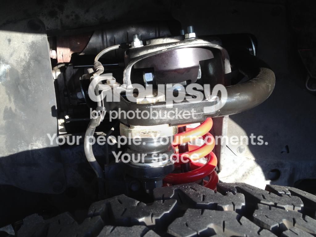

Toytec Boss Kit.

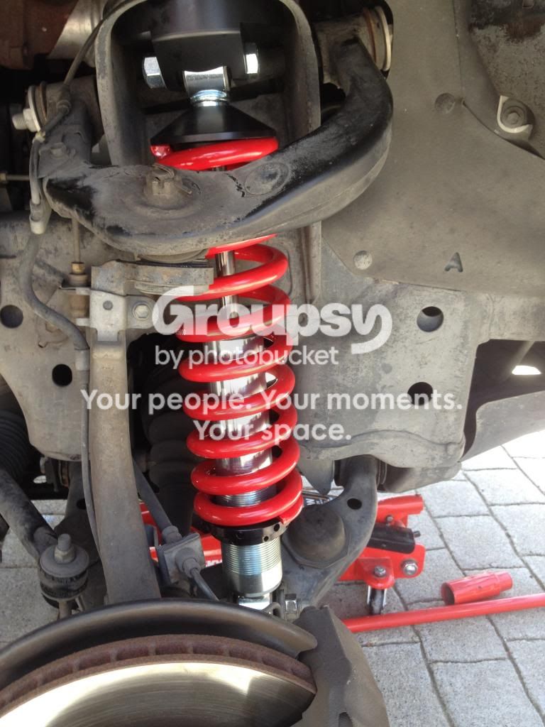

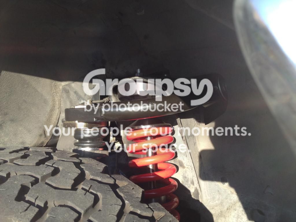

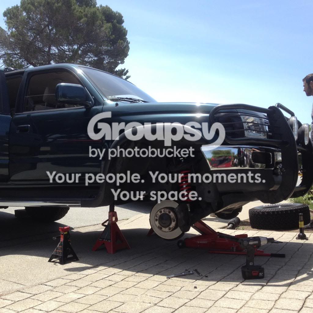

Toytec/Eibach coilovers.
Dif drop kit.
Adjustable Panhard bar.
Toytec Superflex rear coils.
Bilstein 5100's.

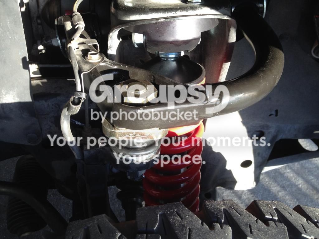

LR Upper Control Arms

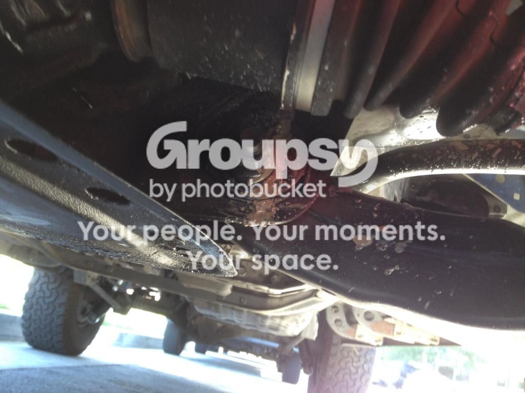

Even with the dif drop the angle was a little much on my CV's so they got re-booted. New upper and lower ball joints as well.

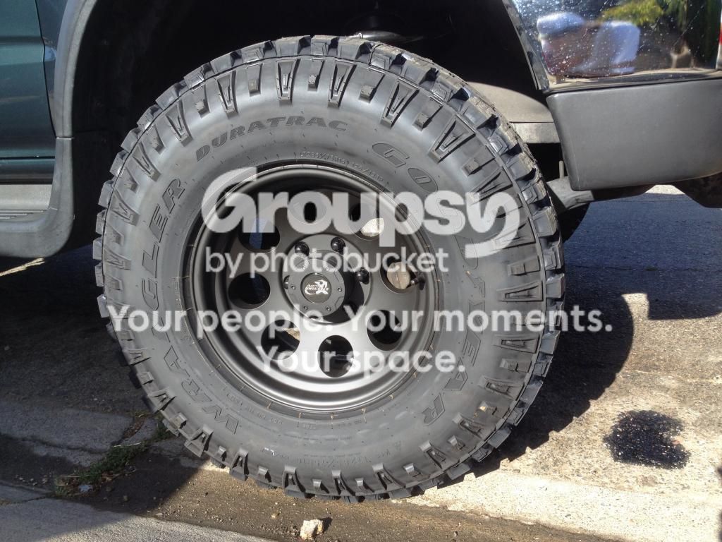

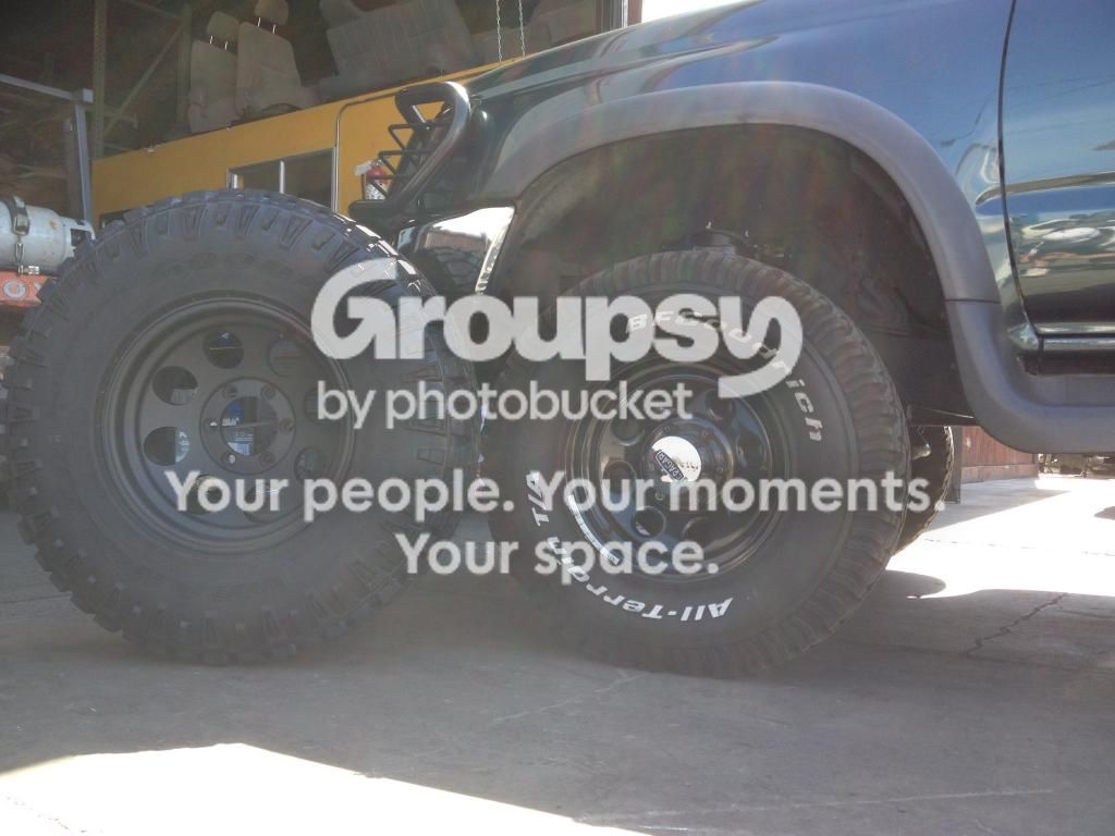

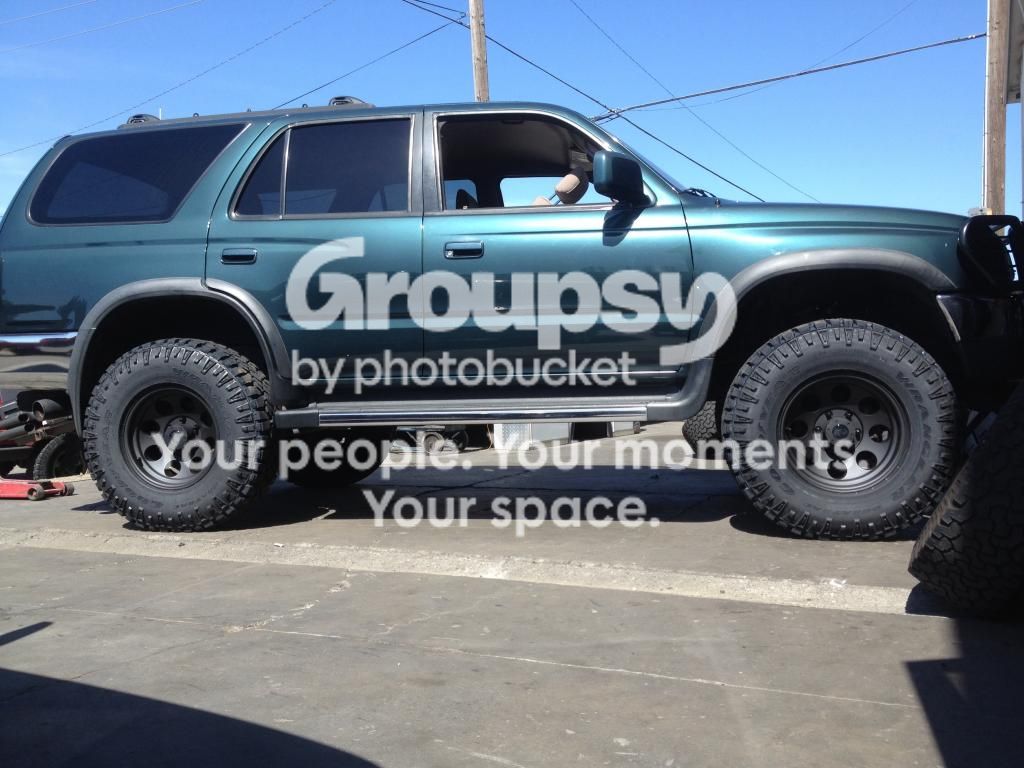

New Wheels

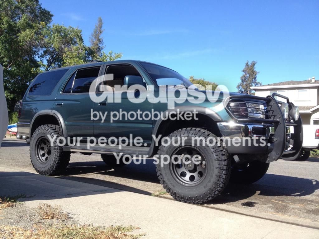

Off with the Steel Cragars, bring on the Pro Comp's! ProComp 7069 16x8 with GoodYear Duratrac's 285/75/16
nice build. I like the 'All-Wheel' drive sign, when it's 4WD. lol.
What grill/brush guard is that (Company)? I have a similar one, but no idea the brand name on mine.
A nice like $5k into that suspension or what? :)

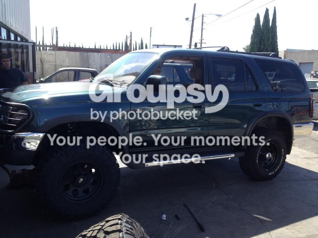

Glad you picked up some new tires and wheels. Looks so much better now, although those running boards are looking a bit out of place...haha
Were on the same page, haha running boards will be replaced with sliders eventually. May just pull them off in the mean time.

Suspension was $1k.

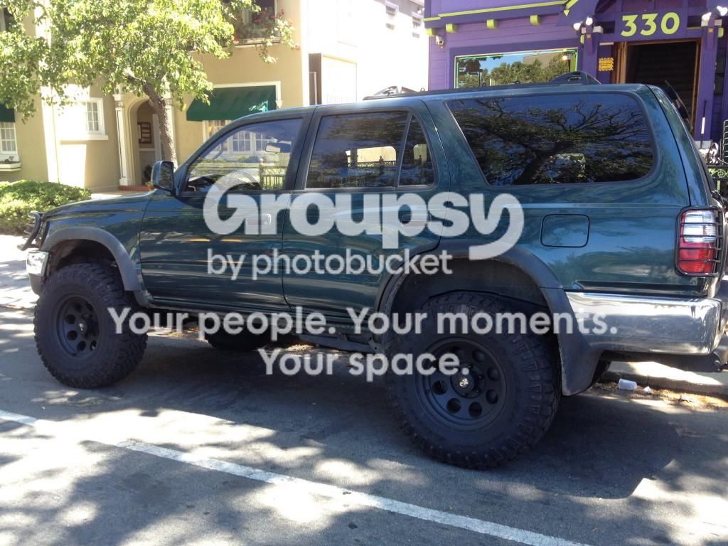

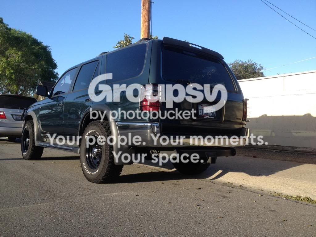

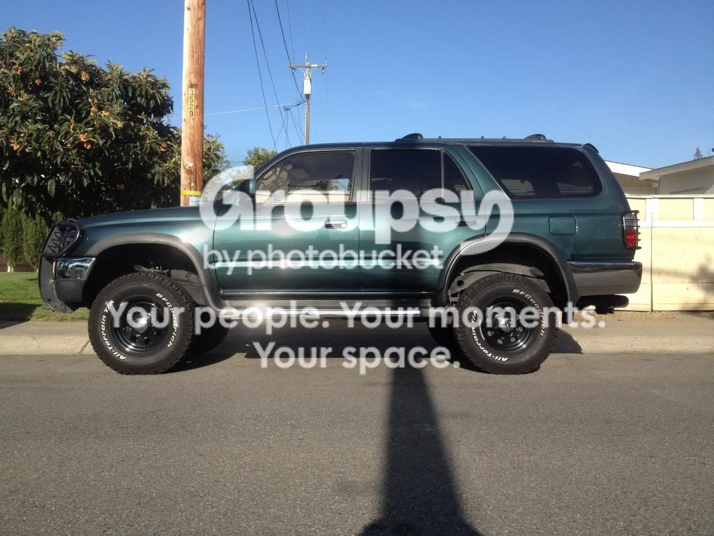

Took off my running boards. I think it looks a lot better personally. I'll take better photos soon. What do you guys think? I'm saving up for BAMF sliders.

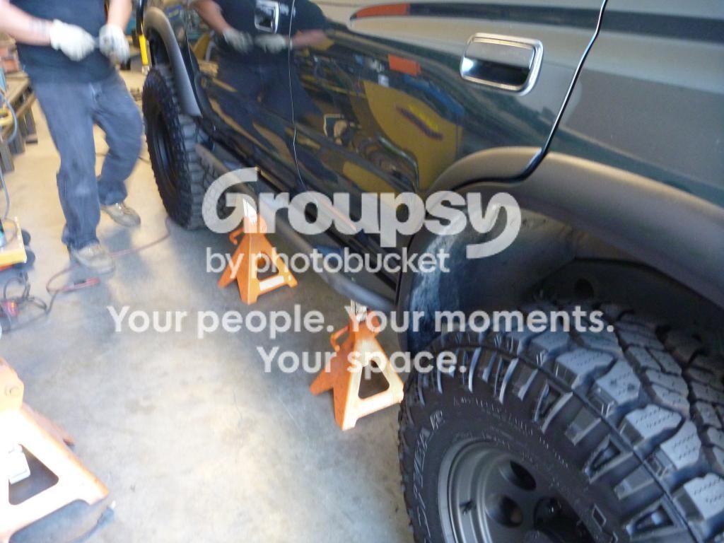

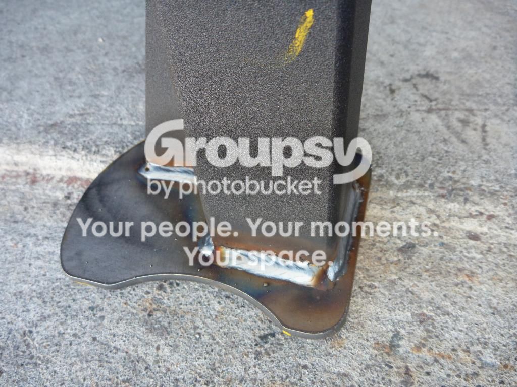

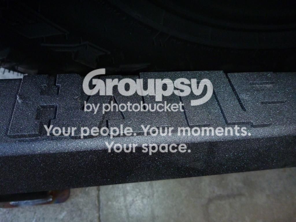

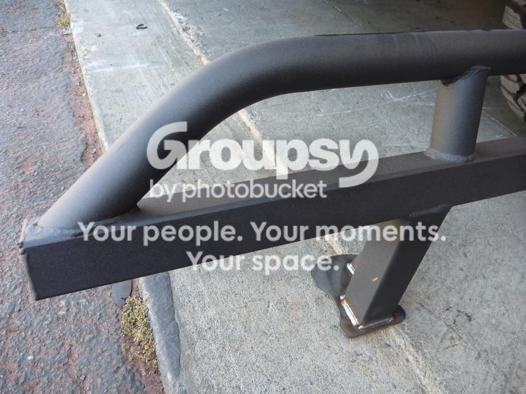

Bamf sliders
I had Bay Area Metal Fabrication (BAMF) install my sliders last weekend. Powder Coated with 600 grit textured flat black. I am very happy with them.
The rear plastic fender on the bottom had to be trimmed for them to fit.
