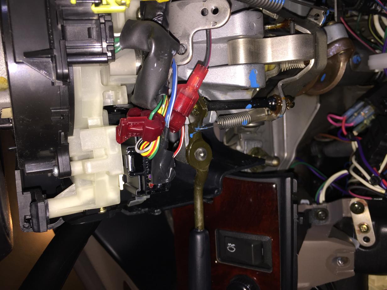

Ok, looks like a red with gold stripe wire after counting it out. I connected test light to positive terminal on battery and stuck the probe in pin 13. The test light came on with the Stalk Switch turned to the ON position but the headlights did not turn on with low or high beam. I do see some wire connectors there which may be from the Alarm install for the remote start feature.
Pin #16 did have the test light on the whole time
Based off those results and what you stated above, you think its the Main DRL Relay that is bad and needs to be replaced or the Combination meter? What is the Combination Meter as i have not heard of the before unless it has another name as well. Is the light stalk also known as the Combination Meter? I have been trying to read other post where it was mentioned.

SO I have been reading and if I’m correct Toyota calls the dash cluster the Combination Meter. That would be terrible if it’s the culprit. I’d really hate to have a dash with mix match mileage from what is actually on the truck since I have low miles on it. I’m hoping that if it is the Cluster, there is some sort of miracle work around that’s not a complete hack you guys can help me with.
Well no miracles, just bypassing it. But first are any of those splices on the Red with yellow stripe wire?
Basically, this wire grounds the headlight circuits necessary to turn power on to the headlights, it is interrupted by a logic circuit that turns if off when the key is off and you open your door. This is embedded in the instrument cluster. The red/yellow goes to the comb meter, comes out as the green wire going to the main DRL relay at Pin 5. There could be another failure along the way, especially if Joe Alarm Installer used some scotch locks. Ideally we would be testing pin 1 and 5 at the comb meter to be absolutely certain.

The red with yellow stripe isn’t touched or spliced in any way. The red/white Wire has scotch lock going to it with another wire running from it. The other two wires with scotch locks don’t have anything connected to them. Green/black and black/red.

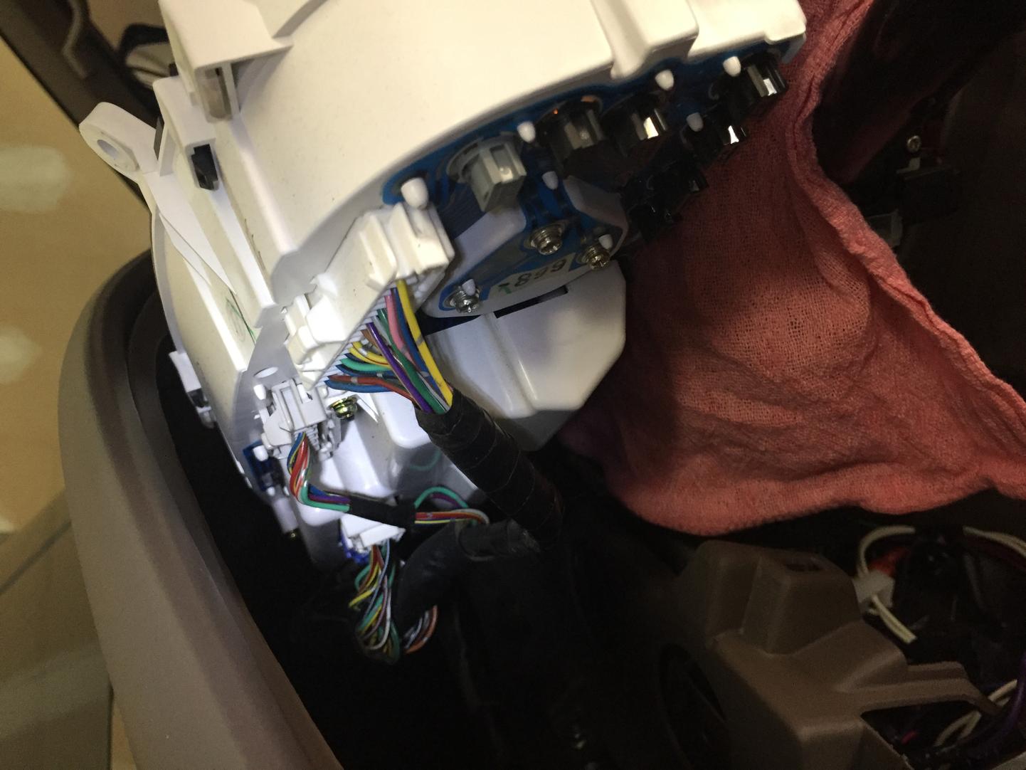

Right now we know the stalk switch is good, and we know if we apply the ground directly to the DRL main relay, the lights work. What we don't know for sure is if this is because of the combination meter, or some bad wire or wires. If you pull the cluster, and check to see if the red/yellow wire still turns the test light on at pin 1, but not at pin 5, then the comb meter is toast. If pin 1 does not light the test light, then we have an open circuit between the comb meter and the switch. If both pins light the light, then there is an open circuit between the comb meter and the DRL main relay. Those are the 3 possibilities based on what we know so far.
Thanks Iball. I will look up removal of the cluster and try to start these test this evening or possibly tomorrow. I will respond when I have completed them. Hopefully I have time after work.
What test do I need to perform with Pin #1 and Pin#5? (Test Light to Positive Batter?) I'm thinking you are referring to the connectors on the dash cluster but if you can confirm and spell it out, I will definitely perform the test.
I managed to remove the cluster during lunch. Just need to verify the connector and what test I am doing for later
Sorry, I had a really busy weekend. You guys are making good progress, but I came back at an opportune time, as you need some additional info to do that test on the cluster. It is Pin 1 and 5 on the C27 plug. There are five or six plugs on the cluster. Go back to the Connector list I linked to earlier in Post #31 to see the Pin out (page 262). C27 is a white 2-row plug with 18 pins, 7 on top and 11 on the bottom. IBall wants you to test those for ground (clip on positive, headlights on). Also keep an eye out for any more post factory wiring involved, and let us know exactly what it is and take pics.
Welcome back. I will perform these test later this evening after work and report back. Thank for the clarification. I have the Plug list pulled up now at work.
