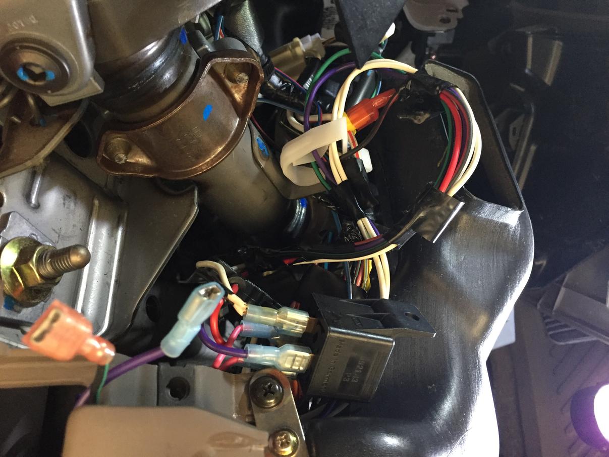

Clipped to positive battery terminal and touched probe to Pin #1 black wire with a red stripe and No Test light with the lights turned on or off.
Touched probe to Pin #5 yellow wire black stripe and the test light came on with light switch off and on.
I do see the additional wiring for the alarm and my fog lights which are running through a relay with a fuse. The two connectors you see are for the fog light switch that is in a pop out panel.

OK, so I show that pin 1 should be the same Red/yellow wire you tested at the stalk switch. Are you sure you have the correct connector. I don't know where on the comb meter it is, but it should be a 20 pin connector, two rows of 10 pins. If you look at the connector disconnected from the connection side, pin 1 should be upper left.
Pin 5 would be a green wire, same as you tested at the Main DRL relay pin 5.
I show same colors or the 2000 and for 2002. Maybe Le Duhrk can tell us if it is the same all years. [MENTION=10169]TheDurk[/MENTION]

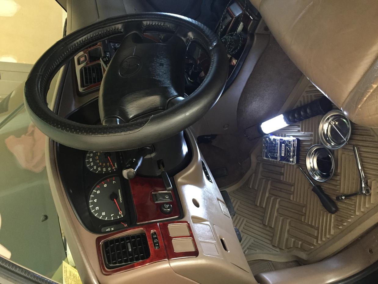

Corrected results. Had the correct plug i just read Pin 1 from the wrong side
Pin#1 Dark Red with yellow stripe. Connected clip to Positive Batt post and Probe to the wire on connector 27. Test Light came on when i turned the Headlight switch to the ON position.
Pin#5 Green Wire. Connected Prob to wire in clip and the test light DID NOT turn on with headlight switch ON/off
Well I hate to say I told ya so, but that indicates a bad combination meter. You can try making a jumper and test, or just ground the green wire at pin 5 and the lights should work. Technically they shouldn't work with out turning on the switch, but since they turned on when you were testing at the Main DRL relay, I'd guess they will when you ground here too:frusty:. But we haven't figured out why, and it doesn't really matter. Check both!

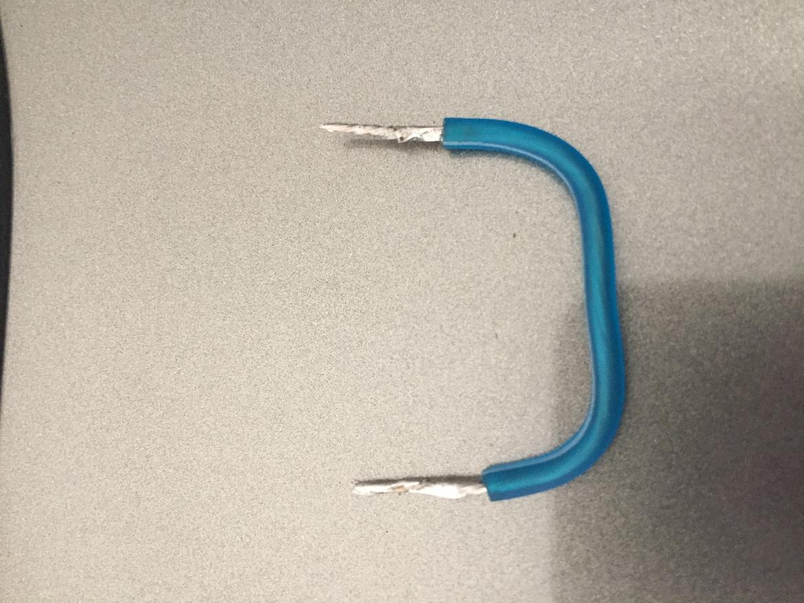

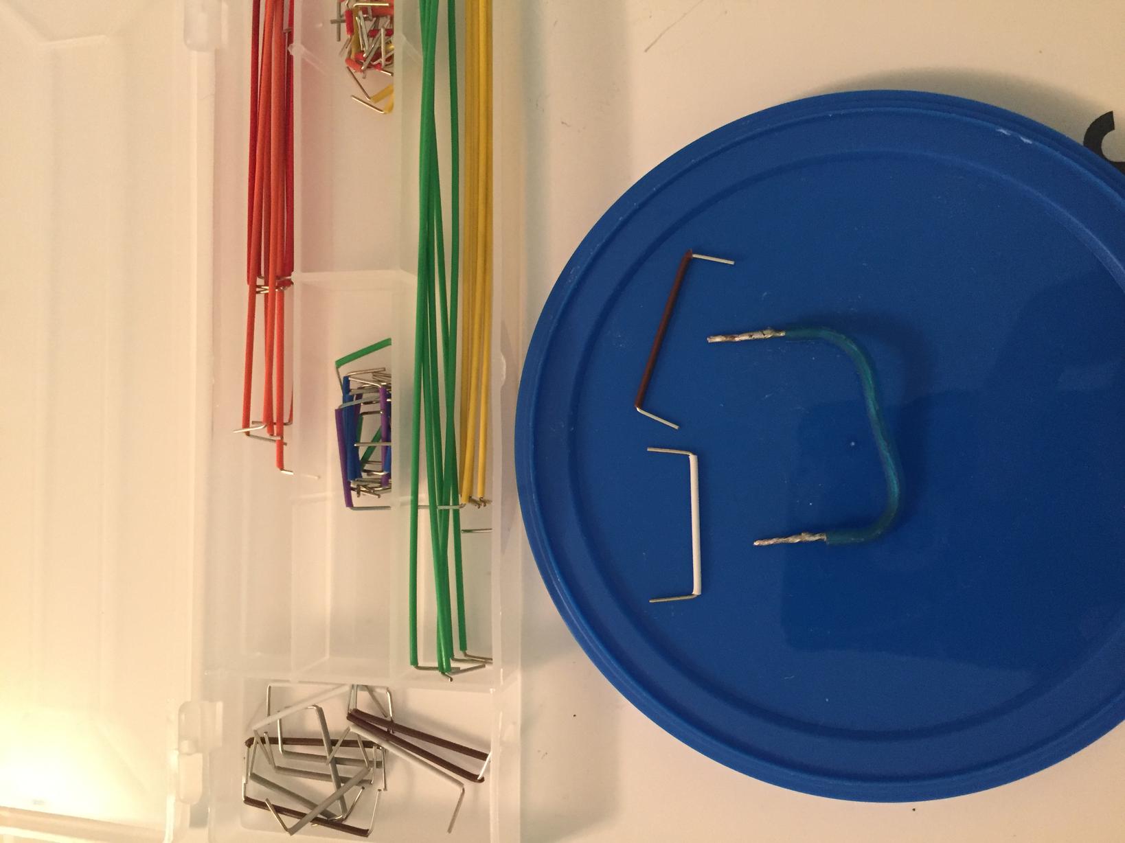

I am so grateful to the both of you for sticking with me through this. I now have lights in low/high beam as normal. It was very tight to try to make a cut and solder on those two wires so i attempted to make a small jumper with a piece of wire i had by putting a small amount of solder on the end to keep it stiff but it was still too big to go in the pin hole. During lunch i had ran by a local electronics store and picked up a small jumper kit of pre-made jumpers in different lengths and there was one that matched perfect. The White jumper in the 2nd pic was a perfect fit. I was able to push it in flush to the connector an tested it multiple times before and after buttoning everything back up. The 2nd best part is there was no extra screws or bolts after everything was put back together.
Would the two of you PM me your PayPal address as i would like to send you two something to show my gratitude for taking your time and maintaining patience in helping me with this issue?
THANK AGAIN.. below are some pics of the jumper i attempted to make along with the ones i bought
