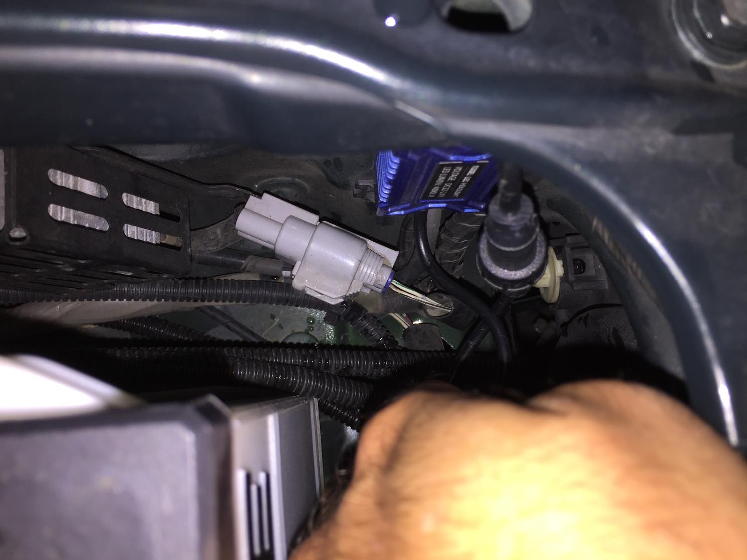

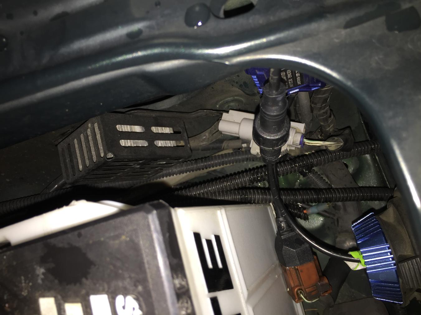

Maybe so. The plug connects to a larger box in the fender.

Here are pics of the DRL plug and box behind it

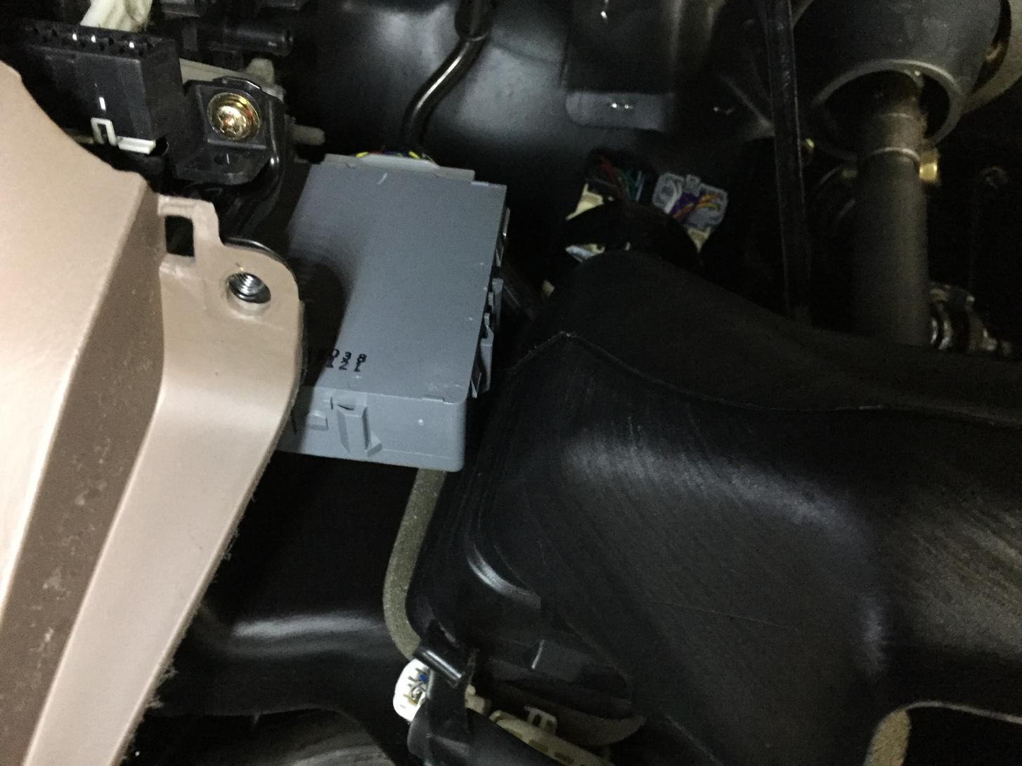

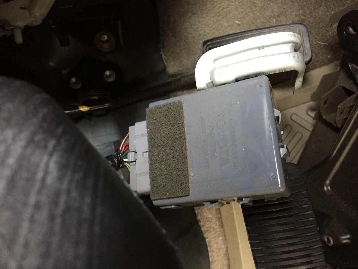

Tried to take a quick look to see where the Main DRL Relay is under the dash but wasn't able to see it for certain. Does anyone have any pics of its exact location or how to access it? do i need to remove the glove box and part of the dash if anyone can chime in. If so let me know and i can do it later tonight in order to try the steps listed.
Thanks
Thanks
The diagram sucks, but it looks like you have to remove the cover underneath the steering wheel--that whole driver side under panel. Glove box should not be involved.. As I said, I don't have one, so I can't be much help as far as that goes.
Found the Main DRL relay. If I understand correctly. Unplug the relay and run the test light ground to the red wire on pin 6 and see if the test light turns on when stalk is to head?
Here is the relay and location for future reference
