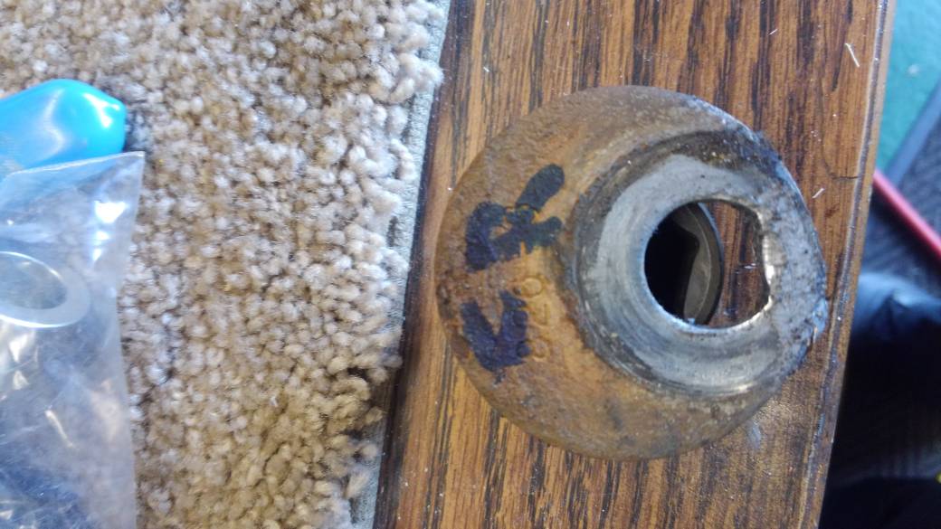

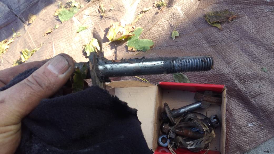

Just an FYI
I just replaced my lca's
These were factory arms rebuild with Moog bushings and cam bolts "greaseable"
Everyone says the bolts are junk
Well I put these in 4 years ago and have over 67k on them
I never greased them besides when I installed them
They slide right out and looked like new
No stripped bolts or adjusters
THE PROBLEM PEOPLE HAVE IS THEY DON'T KNOW WHAT THEY ARE DOING WHEN WORKING ON OR ALINGING THEM
lossen the NUT and turn the bolt to adjust
Simple right....
On that note I just replaced the whole arms instead of rebuilding these again
I used some cheapies form rock Auto
Forget which but I will keep you posted....

Those cam bolts look OEM.
The Moog has a floating sleeve.
