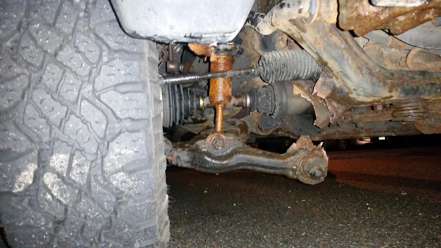

Hey need some input on my 2004. This happened while I was driving to work last Thursday. The front end is completely screwed. The brackets on the frame holding the front lower control arms rusted and broke and my mechanic said the frame is pretty much done for up there. It's a 2004 with ~125k miles and there is significant rust throughout the frame and even parts of the body now it seems. Is this a total loss? I know anything is repairable but at what cost and is it worth it. There is also damage to the shaft seals and I'm sure much more damage than what is visible.
_ bought this used in 2014 and it didn't seem bad at the time but the rust has just been out of control.

Holy hell! I don't think I've ever seen something like that before. If there's enough good frame, you could probably try to get a competent frame guy to weld on new LCA brackets, but unless it's dead on you may never get into alignment spec again though. I'd have a chat with your insurance. That sucks.
that might as well be totaled. if those are rusted enough to rip off the sub frame i can only imagine how bad the rust is in other parts of your frame. if thats the worst of it it may be possible to find a donor subframe and have it welded in, but that could be risky.
I'm not a car expert but I think it's welded to the cross member, and yes my mechanic said it's pretty toast. I think it's done for, I can't even imagine what labor cost alone would be to fix this. I might have to scrap it or sell it as a parts car. Best part is my insurance said they can't do anything because it wasn't in an accident, great thanks for being useless as usual. My mechanic was blown away as he said he's never seen anything like this before either, he has done a few of the rear LCA but this is nuts. Should I even bother trying to contact Toyota to see if there's anything to be done? I don't really know what type of recalls, and frame swaps or buyback they have had for these.
-Also good thing this happened when I was only going 30-40 mph and not about 10 minutes later when I would be on the highway going 60-70.And good thing I didn't put a lot of money into it, I only did tires and an OME suspension and a few cosmetic bits. I still don't even really know what I'm going to do, what are my best options to get at least some money out of this rust bucket?
Sorry dude, that sucks. I know that the Tacos went through a corrosion recall on their frames but I'm guessing that doesn't apply to our 4Runner frames.
Depending on your tenacity and wallet size, it's not improbable to swap everything over to another frame that was involved in a minor fender bender maybe? Perhaps source a frame from out West or here in the SW and move everything over?
A local buddy sold his '03 2x2 4Runner last weekend after he picked the drive-train out of it for $300 at a local salvage yard. So, these types of deals exist, it's just a matter of your priorities, tenacity and time.
Good luck brother.
that can still be fixed. It's only the bracket that looks corroded. you can buy those brackets from Toyota dealer I think. find a good welder to do it and of course you are out of car to drive while they're fixing it.

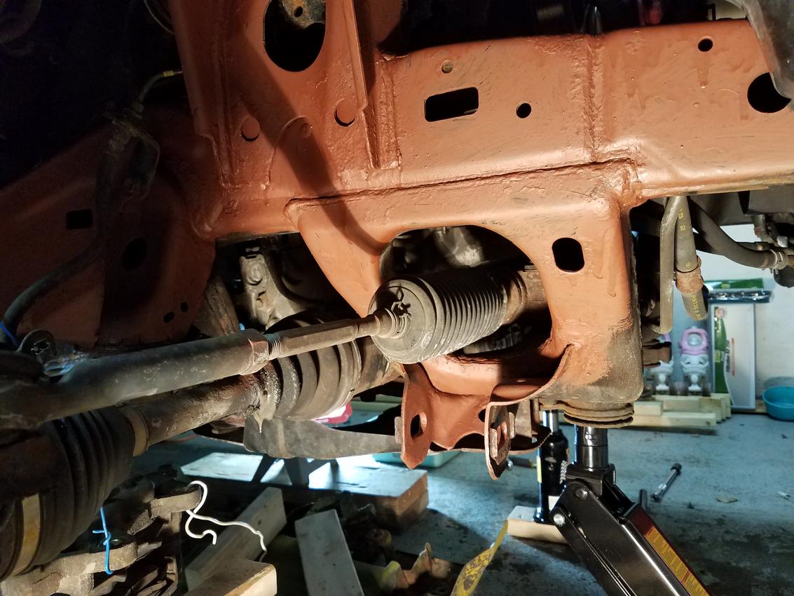

here's what I did on my frame when I replaced the suspension components. a fresh coat of paint can keep it rust free. :)
