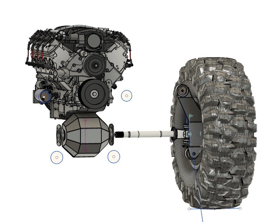

What's your front diff plans then? Swapping in an 8" front diff or going solid front axle?
We are planning to do a center mounted Ford 9" IFS. The goal is a "1 Ton IFS" with an LS based engine. Sounds like we will both be using an LM7, but I'd like to start with an LQ4 preferably. Either way we will be using the 4L80E trans.
Here's a pic of a very rough idea on the CAD renderings we have so far. The axles will be 934 inner CV's and the outers will be '05+ Super Duty D60 RCV's (Pictured are the 1550 U joints but we will be using the RCV replacements for the 1410 joints). We are still very early on in the plans, but we are working on R&D stuff right now, and saving funds.

[MENTION=118730]AssBurns[/MENTION] That's really ambitions and revolutionary! I hope to see it on ifsoffroad in the future!
