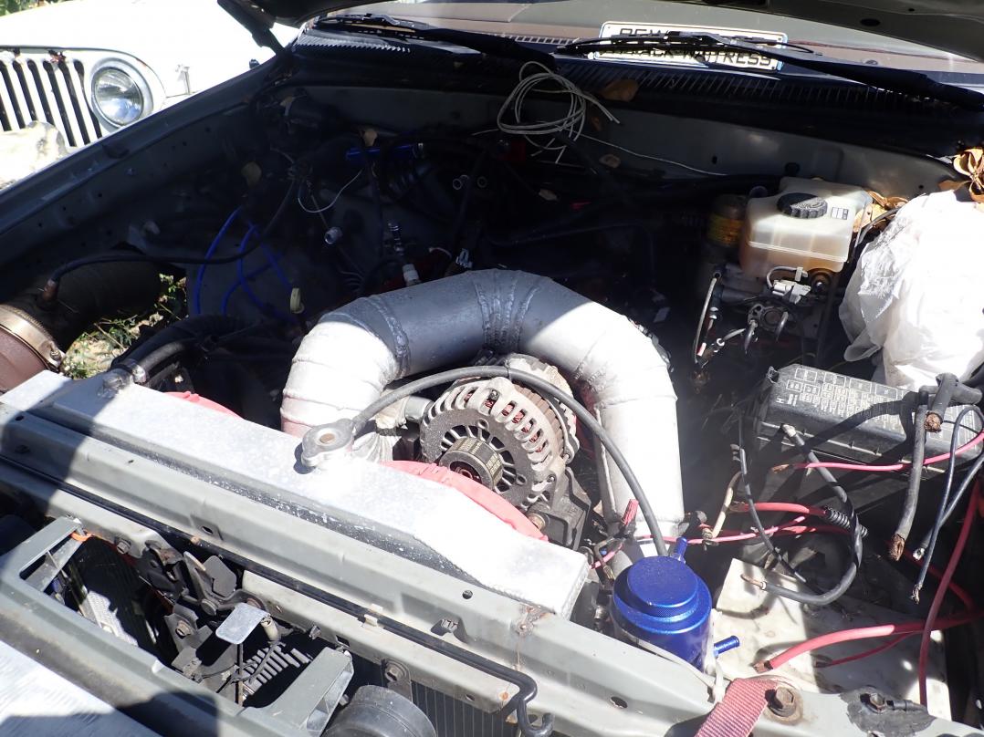

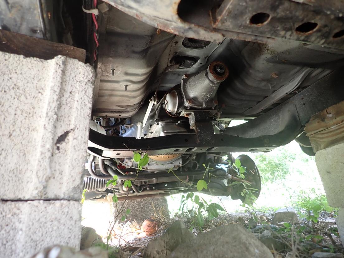

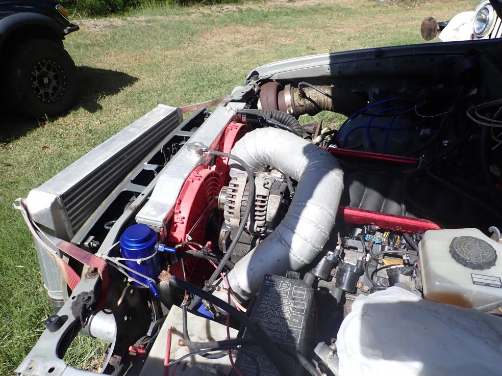

Someone I know did one here on island. He ended up yanking out the diff to get it to fit. Doesn't mean you couldn't get it to fit, but 400 hp does not do you much good offroad in a basic 4runner. I will try to get some pics this weekend

Oh man. I’m interested in understanding if he yanked the diff and went 2wd because he straight up couldn’t get it to work with it in. That is disheartening to hear if so. Would love to see some pics of that rig

I suppose it just seems fairly simple due to my background. I'd say 98% or more people on this forum wouldn't be able to accomplish this task. The only part of this task i am not confident in is getting a front driveshaft to a front diff.
